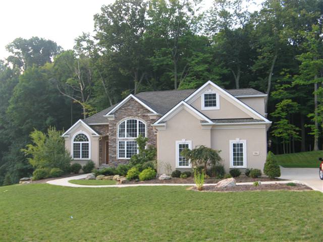

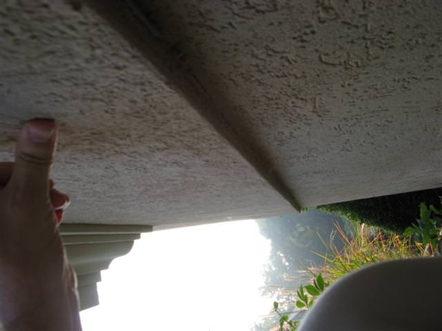

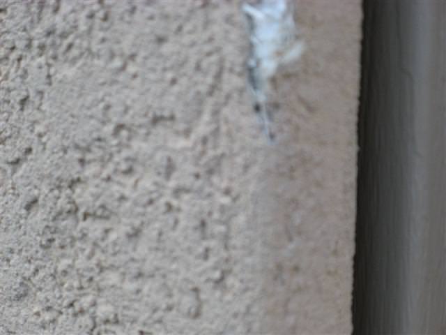

Terence McCann Posted September 20, 2007 Report Share Posted September 20, 2007 Up in this neck of the woods stucco is almost non-existent so I have very little field experance with it. I did a home this morning that, I believe, has a stucco exterior. I looked for weep screed but didn't find any. I have attached a few pictures of the exterior to get a few opinions. TIA. Image Insert: 51.11 KB Image Insert: 35.37 KB Image Insert: 37.46 KB Image Insert: 55.17 KB Quote Link to comment Share on other sites More sharing options...
Chad Fabry Posted September 20, 2007 Report Share Posted September 20, 2007 Terry, that's EIFS. Depending on how it's installed it could be OK or the worst nightmare you've ever imagined. The rain screen installations, properly detailed, are performing reasonably well. 99% of residential applications are not the rain screen type and are doomed to failure from improper detailing at windows, doors, vent penetrations etc. Check around the penetrations w/ a moisture radio wave style moisture meter. If there is any indication of moisture at all...maybe even if there isn't... suggest some destructive testing to determine the extent of damage to the sheathing, framing and insulation. Quote Link to comment Share on other sites More sharing options...

hausdok Posted September 20, 2007 Report Share Posted September 20, 2007 Hi Terry, I do EIFS and stucco houses on a fairly regular basis. With stucco, I just do the inspection like any other, but with EIFS I inform the client that I'll do a cursory scan but will not do a complete EIFS inspection as part of the home inspection. If they want to pay more for a full EIFS inspection, I'll do them but those are pretty few and far between. It can take several hours to do a full EIFS inspection correctly, so it's a whole different ball of wax. If that middle photo is of a little bit of damage to the lamina and the white stuff is foam and you saw strands of fiberglass mesh around that break then it is indeed EIFS. The other giveaway is the lack of accessory and termination beads. If it had real stucco you'd expect to find accessory joints, expansion beads, and termination beads - not necessarily in very old stucco homes, but most do have them. If the house was built between 1985 and 1995/6 it's probably a barrier EIFS systems, which means there's no drainage plane behind it and any improper detailing around openings will eventually result in water trapped behind the lamina and all of the attendant problems that will bring. If it's from 1995/6 onward there's a 50/50 chance that it's a water-managed EIFS, but the lack of any type of obvious weep screed at the bottom edge of that wall is a good reason to doubt that it is. Did you examine the terminations around windows and doors to see if they were soft compared to the rest of the lamina? If they're done correctly, the installer will have used backer rod behind flexible caulk and will either tool the surface of the butyl and leave it exposed or extend the finish coat over the butyl and backer rod to conceal it. It looks to me like it's concealed. Everything that Chad said is true. You're safest course of action, if it is EIFS, is to scan as much of it as you are able and to in a few minutes, write any moisture you find, and defer further inspection to a trained EIFS inspector. The realtors and most of the clients bellyache about cost, but they're usually happy, after they've had the EIFS inspection, to realize that the job could have come back to haunt them. True story: A friend built a house with an EIFS system facing the street and parking area. About 3-4 years after he moved in I drove over there and noticed something fishy about the lamina. "You better get that cladding checked out; it's got water behind it," I told him. "What, are you nuts, the house is great and there's no water or dampness or odor or anything on those walls of the house," he said. "I don't care," I insisted, "There's water in there," whereupon I took my Protimeter and scanned the wall and it started beeping up a storm. He continued to protest - "But we insisted that they install a water-managed system on the house, just like you told us to when we were having it built." "Well, you should have had me come by and look at it then, because this obviously isn't a water-managed system. Look here, there's no weep screed at the bottom of this wall and none of the mesh is back-wrapped." I took a pencil out of my truck and, using my Protimeter, I outlined all of the damp areas that I could reach from the ground. "You've got a ton of water behind this lamina. If you don't get after it, you're going to lose this house." He was skeptical but said he'd get the contractor back. He called me that evening and arranged for me to be there at the same time as the contractor. The following week I met them both there. The contractor, a Ukrainian (or maybe a Russian - I can't tell by the accent), was mad as hell at me and told me that I was nuts. I showed him the moisture using the Protimeter and he still insisted I was nuts. I told him to cut a hole in the wall at the center of one of my marked-up areas and if there wasn't moisture there I'd pay for it. He was pretty cocky. He grabbed his saw, cut a 10 x 10 hole where I'd indicated and popped out the square. As soon as he popped that square out of the wall, the smell of funky rotten wood just rolled over us. The sheathing was rotting and so weren't the studs. I left. The next week he showed up to strip the front of that house and I came back a couple of hours into the job to see how it was going. You would not have believed the amount of damage. The framing was literally black with rot - even the pressure-treated sills and rims and the 6 by 6 pressure-treated posts buried in the EIFS-clad columns at the front porch. There was a nice thick black layer of mold on the backside of the drywall. To this day, I don't understand why that hadn't shown up inside the home. Maybe it was because he'd used a CPVC based moisture-barrier primer on all of the walls. To the contractor's credit, he ate the whole job and put his crew on that mess for a full six weeks to repair it all. With time and materials, I'd guess it probably cost him $60,000 to repair and would have cost my friend nearly $100,000 if the contractor hadn't stepped up, because his insurance company refused to pay for anything but replacement of interior drywall that had to be destroyed in the process of tearing out and replacing all of those studs. Now that I've scared the bejezuz out of you, make sure you're careful to cover your rump on this one. ONE TEAM - ONE FIGHT!!! Mike Quote Link to comment Share on other sites More sharing options...
Terence McCann Posted September 20, 2007 Author Report Share Posted September 20, 2007 A few questions Mike: On your friends house, how could you tell by looking at it that there were moisture problems? With the moisture detector, scan the exterior or interior wall at the places that are prone to problems? In my 4th picture should there have been weep screed at the bottom? I need to get some training on EFIS and stucco applications, not my strong suit for sure. Quote Link to comment Share on other sites More sharing options...
hausdok Posted September 20, 2007 Report Share Posted September 20, 2007 Originally posted by Terence McCann A few questions Mike: On your friends house, how could you tell by looking at it that there were moisture problems? That's a good question; one that's hard to answer. There were very subtle differences in overall texture of the wall that I could see when the light struck it from an oblique angle. Moisture had gotten in all around the foam and affected the way the wall looked - at least to me. It's hard to define. If you look at something over and over and it's fine and then you look at the same thing with a slight imperfection, those imperfections kind of jump out at you. EIFS is waterproof on the outside, but the basecoat is portland cement based. Get it wet and it changes the look of the wall. With the moisture detector, scan the exterior or interior wall at the places that are prone to problems?Yeah, lower corners of window opening, bottom of the walls - especially on the weather sides of the house. In my 4th picture should there have been weep screed at the bottom?Yes, but sometimes it's hard to see. There are various type of weeps and some don't have any holes on the bottom but have holes on the foundation side and nothing more than a very narrow slot between the back/bottom edge of the lamina and the foundation. Plus, if it's a drianage plane system with this type of bead, and it's been properly detailed, things could be perfectly fine and there's nothing overtly obvious, other than the fact that that it's EIFS, to tell you how it's been done. Check around locally and see if you can find a copy of the EIFS Primer by Robert G. Thomas Jr.. They guy worked for Dryvit for more than 25 years and has had an EIFS consulting business for about the past 10 to 15. He's forgotten more about this stuff than most of us will ever know. I need to get some training on EFIS and stucco applications, not my strong suit for sure.Well, even after you get the training, it won't be your strong suit unless you see the stuff all the time. I'm still uncomfortable with the stuff. ONE TEAM - ONE FIGHT!!! Mike Quote Link to comment Share on other sites More sharing options...
StevenT Posted September 20, 2007 Report Share Posted September 20, 2007 Hi Guys, I've been away for a while, crazy busy at work and studying for an upcoming licensing/certification test with NYSDEC. You should be able to see a drainage starter track that will allow the system to drain. Even if its a "drainable" system, if there is no place for the water to exit, it will not work. Image Insert: 45.64 KB Image Insert: 31.41 KB The j track starter is for a drainage system using corregated styrofoam. There is also an "L" type starter track that is used with a weepable membrane that is installed prior to the foam board. There is alot more to inspecting EIFS than can be posted. If you are interested, check out Exterior Design Institute. http://www.exterior-design-inst.com/training.html Regardless of if it is a drainable or barrier system, if it is not installed properly... and most residential systems are not, it will not function properly and as Chad stated, can be your worst nightmare. I have more things regarding EIFS that I would love to post, including a few movies regarding the installation, I just cannot figure out how to do it. Quote Link to comment Share on other sites More sharing options...

Terence McCann Posted September 21, 2007 Author Report Share Posted September 21, 2007 Thanks Steve, very informative. Attached is a picture of the entire home. Image Insert: 67.65 KB Quote Link to comment Share on other sites More sharing options...
