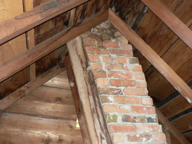

jodil Posted February 11, 2008 Report Share Posted February 11, 2008 Has anyone seen a chimney constructed on a angle like this? This chimney is 100 years old, and appeared to me in satisfactory condition, but the buyer was quite nervous about the angle, and honestly I had never seen one like that before, so I dont know what to tell him... Youre opinions are greatly appreciated!! Image Insert: 225.75 KB Quote Link to comment Share on other sites More sharing options...
hausdok Posted February 11, 2008 Report Share Posted February 11, 2008 It's quite common in older buildings to find that a mason had to slightly corbel a stack in order to get it to exit the roof where desired. It's normally not an issue if the stack is in good shape, has a good mud lining, and is flashed properly. However, it looks like someone didn't do a good job of flashing that stack. Either that or you've got a cracked crown and water is permeating the stack and degrading that mortar up near the top. Was it lined? ONE TEAM - ONE FIGHT!!! Mike Quote Link to comment Share on other sites More sharing options...
Les Posted February 11, 2008 Report Share Posted February 11, 2008 I have seen hundreds of them and most were more severe that the photo. Mike is right, they are quite common in our state/area. Quote Link to comment Share on other sites More sharing options...

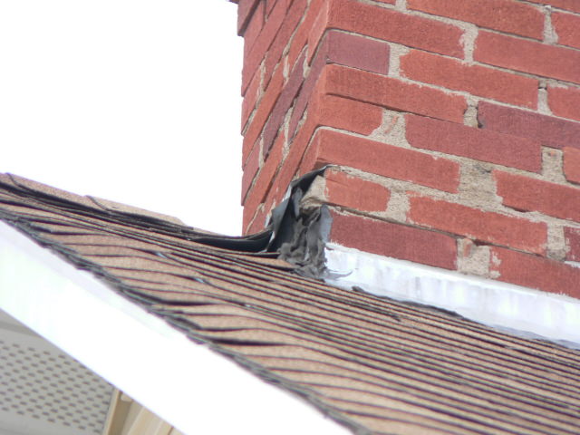

jodil Posted February 11, 2008 Author Report Share Posted February 11, 2008 I was unable to view inside of the chimney as the roof is VERY steep and was covered with ice. The chimney is only being used for the furnace and water heater exhaust, there is no fireplace. Here is a pic of the flashing around the chimney, which I would guess is the cause of what you are speaking of. Image Insert: 184.74 KB Quote Link to comment Share on other sites More sharing options...
Jim Katen Posted February 11, 2008 Report Share Posted February 11, 2008 Originally posted by jodil Has anyone seen a chimney constructed on a angle like this? This chimney is 100 years old, and appeared to me in satisfactory condition, but the buyer was quite nervous about the angle, and honestly I had never seen one like that before, so I dont know what to tell him... Youre opinions are greatly appreciated!! There are lots of them in Portland. I tell people that there used to be lots of them in Oakland & San Francisco too, before the Loma Prieta earthquake . . . - Jim Katen, Oregon Quote Link to comment Share on other sites More sharing options...
hausdok Posted February 11, 2008 Report Share Posted February 11, 2008 Hi, That's a pretty crummy flashing job. However, besides the flashings, you have to pay attention to the crown. If you've got a cracked crown, it's easy for water to get into the brickwork and work it's way down to the roof plane and any framing that abuts the bricks. Lots of times, water will move down through a crack in the crown and folks end up gooping up the flashings with tar because they can't figure out where the water is gettin in. If I hadn't been able to look down that flue, I'd have called to have it inspected by a CSIA (Chimney Safety Institute of America - http://www.CSIA.org) sweep and to make any repairs recommended by the sweep prior to closing. ONE TEAM - ONE FIGHT!!! Mike Quote Link to comment Share on other sites More sharing options...
Bill Kibbel Posted February 11, 2008 Report Share Posted February 11, 2008 I was unable to view inside of the chimney as the roof is VERY steep and was covered with ice. How 'bout looking up it with a mirror? That chimney doesn't look like the type that would have been built with a liner. Quote Link to comment Share on other sites More sharing options...
msteger Posted February 11, 2008 Report Share Posted February 11, 2008 Ditto. I've seen lots of chimneys that are built with an angle, like in your photo. I always, always recommend a Level 2 Clean/Service and inspection by a qualified chimney professional for any chimney that is either venting a fireplace/stove or HVAC system or water heater. There is just too much that we can't see while doing a non-invasive visual inspection. Quote Link to comment Share on other sites More sharing options...
