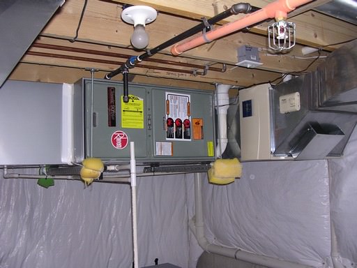

Chad Fabry Posted March 26, 2008 Report Share Posted March 26, 2008 non-combustible material (usually drywall) Many "drywall" products are combustible...did you mean gypsum board? Link to comment Share on other sites More sharing options...

Brian G Posted March 26, 2008 Report Share Posted March 26, 2008 Originally posted by Chad Fabry Many "drywall" products are combustible...did you mean gypsum board? I guess I did, but around here that's what "drywall" means. No one would recognize "gypsum board" at all (locally it's either "drywall" or the even more incorrect "sheetrock"). What "drywall" products are combustible? Stuff like paneling? Ah-so. I get it, and you're probably right. I suppose I should write both, just to be safe (which John already did). Brian G. Laboring With Local Lingo [:-alien] Link to comment Share on other sites More sharing options...

Brian G Posted March 26, 2008 Report Share Posted March 26, 2008 Originally posted by ozofprev I don't write up the furnace being located under the stairs because I don't have a reputable citation that I can use to support such a statement. There are many horizontally mounted furnaces in Buffalo that are situated directly under the floor joists of bedrooms. They are installed according to mfr recommendations, have no fire-rated material at the joists and they violate no local codes. Oh sure, we have that here to, just less often (in crawl spaces, not basements). I wouldn't suggest the gas appliances under the stairs are a code violation, or that they should be moved, but I think it's reasonable to note that in a situation like this one the fire safety requirements for the stairs take on added importance. Surely such a space with two gas appliances is more prone to fire than such a space without two gas appliances, all other things being equal. Das all I'm tryna' say. Brian G. I Zig, You Zag [8] Link to comment Share on other sites More sharing options...

Chad Fabry Posted March 26, 2008 Report Share Posted March 26, 2008 I guess I did, but around here that's what "drywall" means. No one would recognize "gypsum board" at all (locally it's either "drywall" or the even more incorrect "sheetrock"). What "drywall" products are combustible? Stuff like paneling? Ah-so. I get it, and you're probably right. I suppose I should write both, just to be safe (which John already did). I re-read my posts all the time and this one is no exception. I don't re-read them because I think I'm clever I re-read them because I have a tendency to write like an arrogant jerk... this is one of those times and I apologize. Link to comment Share on other sites More sharing options...

kurt Posted March 27, 2008 Report Share Posted March 27, 2008 Originally posted by ozofprev John, I don't write up the furnace being located under the stairs because I don't have a reputable citation that I can use to support such a statement. Is there such a prohibition anywhere? I looked all through Chapter 24, and there's nothing in there about stairs, is there? Link to comment Share on other sites More sharing options...
John Dirks Jr Posted March 27, 2008 Author Report Share Posted March 27, 2008 The write up was not initiated by the fact that gas appliances are under the stairs. It was initiated due to the lack of gypsum as a fire break. The fact that the gas appliances are under there just makes it that much more important in my mind. The thought was there, so I shared it. IRC R311.2.2 Under stair protection. Enclosed accessible space under stairs shall have walls, under stair surface and any soffits protected on the enclosed side with ½-inch (13 mm) gypsum board. Link to comment Share on other sites More sharing options...
ozofprev Posted March 27, 2008 Report Share Posted March 27, 2008 Well, ya gotta luv that! As with much of my reading since puberty, I look mostly at the pictures. Missed the whole friggin' "enclosed" part. You did exactly right, John. Zigging was the right move! Is there a means for enough O2 to get into the ENCLOSED space? But I did catch the street name - that would have been embarassing.[:-censore Link to comment Share on other sites More sharing options...
John Dirks Jr Posted March 27, 2008 Author Report Share Posted March 27, 2008 Gary, Yes, Tre was a vent in the wall to the main open area of the lower level to allow combustion air in. Even then it only had to feed the water heater. The furnace is setup to draw combustion air from the outside. Link to comment Share on other sites More sharing options...
