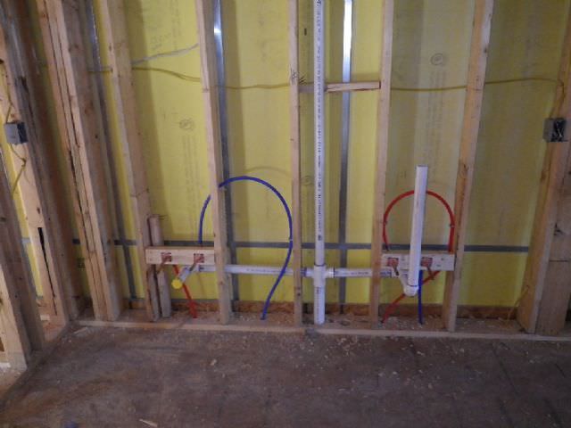

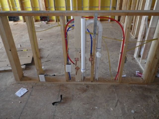

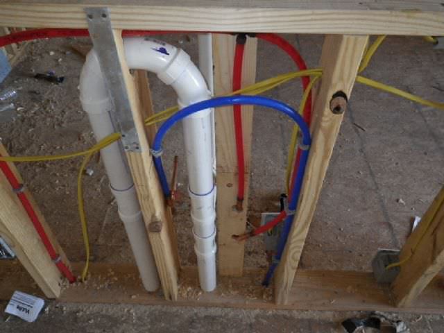

Nolan Kienitz Posted December 16, 2011 Report Share Posted December 16, 2011 Marc, Here are some images I took recently at a phase inspection of a condo. These are the typical transitions i see over here ... D/FW. Click to Enlarge 37.05 KB Click to Enlarge 49.7 KB Click to Enlarge 51.22 KB Click to Enlarge 41.89 KB Quote Link to comment Share on other sites More sharing options...

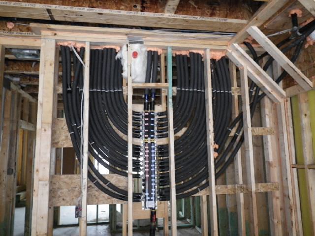

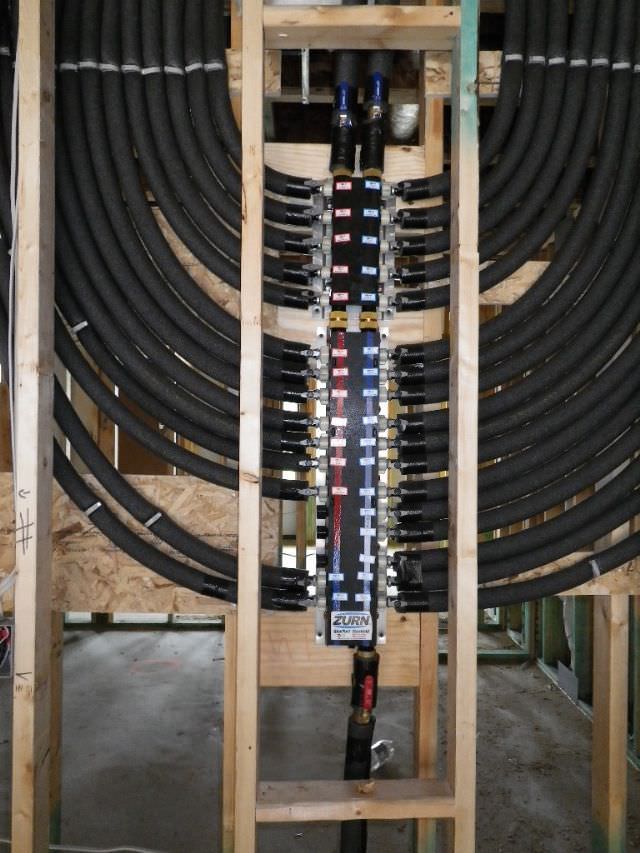

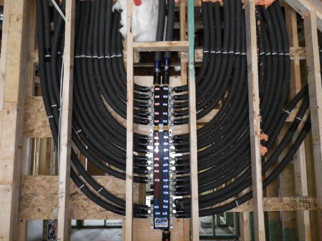

Nolan Kienitz Posted December 17, 2011 Report Share Posted December 17, 2011 Few more images that go with the ones I posted above. These below are of the PEX Manifold distribution panel on the interior garage wall. This one has been nicely done ... compared to some I've seen. Click to Enlarge 63.04 KB Click to Enlarge 68.18 KB Click to Enlarge 102.57 KB Quote Link to comment Share on other sites More sharing options...
plummen Posted December 17, 2011 Report Share Posted December 17, 2011 Marc, Here are some images I took recently at a phase inspection of a condo. These are the typical transitions i see over here ... D/FW. Click to Enlarge 37.05?KB Click to Enlarge 49.7?KB Click to Enlarge 51.22?KB Click to Enlarge 41.89?KB Those pictures lok better than most of the pex jobs ive ever seen,still not allowed to use it in the city of Omaha though last I heard Quote Link to comment Share on other sites More sharing options...
plummen Posted December 17, 2011 Report Share Posted December 17, 2011 Few more images that go with the ones I posted above. These below are of the PEX Manifold distribution panel on the interior garage wall. This one has been nicely done ... compared to some I've seen. Click to Enlarge 63.04?KB Click to Enlarge 68.18?KB Click to Enlarge 102.57?KB Nice work,not sure about about the location though unless youre in a really warm part of the country Quote Link to comment Share on other sites More sharing options...
Marc Posted December 17, 2011 Report Share Posted December 17, 2011 Few more images that go with the ones I posted above. These below are of the PEX Manifold distribution panel on the interior garage wall. This one has been nicely done ... compared to some I've seen. Click to Enlarge 63.04?KB Click to Enlarge 68.18?KB Click to Enlarge 102.57?KB It has a Fabry touch to it.[] Marc Quote Link to comment Share on other sites More sharing options...
