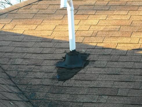

sepefrio Posted February 8, 2009 Report Share Posted February 8, 2009 Came across this a couple hours ago and I have my hunch but would just like others opinions. First, I did not walk to that part of the roof, this is zoomed from the ladder. I had already slipped once on the roof (wind, pitch and just wasn't comfortable) and wasn't looking to break a leg or worse. Anyways, to me that looks like melted tar maybe. That is the vent for the gas furnace in the attic. I'm thinking the tar melted when heated up and began to "run" down the side of the roof. The real answer doesn't really matter as it's clearly leaking and I'm already calling it out. I'm just curious as I have never seen this effect on a vent like that, chimney yes, but not a vent. As I posted the pictures I looked at them again and thought, could that be whats left of a melted storm collar? Click to Enlarge 54.07 KB Click to Enlarge 43.07 KB Click to Enlarge 22.48 KB Link to comment Share on other sites More sharing options...
Bain Posted February 8, 2009 Report Share Posted February 8, 2009 I don't think the flue of a 90% furnace would get hot enough to melt tar. What probably happened is the neoprene flashing boot was cracked and someone spread tar all over the place to make certain they stopped the leak. Link to comment Share on other sites More sharing options...
sepefrio Posted February 8, 2009 Author Report Share Posted February 8, 2009 I don't think the flue of a 90% furnace would get hot enough to melt tar. What probably happened is the neoprene flashing boot was cracked and someone spread tar all over the place to make certain they stopped the leak. So basically you think it was just a sloppy fix? That makes more sense tbh. Link to comment Share on other sites More sharing options...
Jeremy Posted February 8, 2009 Report Share Posted February 8, 2009 I don't think the flue of a 90% furnace would get hot enough to melt tar. What probably happened is the neoprene flashing boot was cracked and someone spread tar all over the place to make certain they stopped the leak. I agree, it also looks like they tracked up the valley while doing it. Link to comment Share on other sites More sharing options...
Bain Posted February 8, 2009 Report Share Posted February 8, 2009 And . . . as dopey as it sounds . . . see that droplet of condensate on the rim of the candy cane? The person making the repair may have thought that was the cause of the leak, and decided to spread tar beneath the pipe to catch the moisture. Link to comment Share on other sites More sharing options...

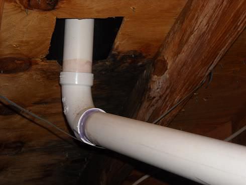

sepefrio Posted February 8, 2009 Author Report Share Posted February 8, 2009 And . . . as dopey as it sounds . . . see that droplet of condensate on the rim of the candy cane? The person making the repair may have thought that was the cause of the leak, and decided to spread tar beneath the pipe to catch the moisture. There was also this under the vent in the attic [:-tong2] Click to Enlarge 24.13 KB Link to comment Share on other sites More sharing options...
