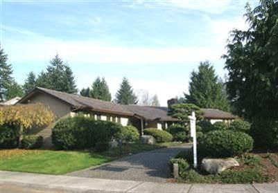

Jim Katen Posted September 24, 2009 Report Share Posted September 24, 2009 Alright, dammit. What the hell is it with 1981? Every single freaking house that I've inspected that was built in 1981 is freaked up the freaking wazoo. What the blazes was the matter with builders that year? Where they all high? Drunk? Being impersonated by freaking aliens? What the heck inspired them to do all of the stupid crap that they did? As of tomorrow, when someone calls for an inspection of a house built in 1981, I swear I'm going to charge them double. Quote Link to comment Share on other sites More sharing options...

kurt Posted September 26, 2009 Report Share Posted September 26, 2009 Ezra's about right.......I was building around 1978-85ish too... New building product stuff being introduced like stuccato, fake tudor was at an all time high, treated wood foundations, weird dry stacked block foundations with fiber reinforced mortar smeared on it, lots of T-111 siding, the new concept of vapor barriers, the first failed experiments with spray foam insulation (oh lord was that stuff bad), and pretty much the complete negation of any respectable traditional building method. It's when stuff like door pan flashing disappeared, drip caps became superfluous apparently. Thankfully, I almost never see anything from that era. Quote Link to comment Share on other sites More sharing options...
Jim Katen Posted September 26, 2009 Author Report Share Posted September 26, 2009 Ezra's about right.......I was building around 1978-85ish too... New building product stuff being introduced like stuccato, fake tudor was at an all time high, treated wood foundations, weird dry stacked block foundations with fiber reinforced mortar smeared on it, lots of T-111 siding, the new concept of vapor barriers, the first failed experiments with spray foam insulation (oh lord was that stuff bad), and pretty much the complete negation of any respectable traditional building method. It's when stuff like door pan flashing disappeared, drip caps became superfluous apparently. Thankfully, I almost never see anything from that era. Yeah, but it's more than that. All of that stuff started after the first Arab oil embargo and made a mess for the next 20 years or so. The 1981 syndrome is more as if all the builders just stopped caring all of a sudden. The stuff I'm seeing isn't related to new materials or techniques, it's more like the gas pipe being used as a vehicle barrier thing. It's like the builders' attitudes just tanked all of a sudden and they just didn't give a damn about what they were building, kind of like the Friday at 4:00 pm mentality, but it affected the whole house. Tomorrow, I'm going to inspect my third (count 'em, 3) 1981 house of the week. It's a geodesic dome. Oh boy. I can hardly control my excitement. - Jim Katen, Oregon Quote Link to comment Share on other sites More sharing options...

Tom Raymond Posted September 26, 2009 Report Share Posted September 26, 2009 "The 1981 syndrome is more as if all the builders just stopped caring all of a sudden. The stuff I'm seeing isn't related to new materials or techniques, it's more like the gas pipe being used as a vehicle barrier thing. It's like the builders' attitudes just tanked all of a sudden and they just didn't give a damn about what they were building, kind of like the Friday at 4:00 pm mentality, but it affected the whole house. " Those were troubling economic times, just imagine what a 2009 house will look like in 30 years[:-bigeyes Tom Quote Link to comment Share on other sites More sharing options...
kurt Posted September 26, 2009 Report Share Posted September 26, 2009 The 1981 syndrome is more as if all the builders just stopped caring all of a sudden. The stuff I'm seeing isn't related to new materials or techniques, it's more like the gas pipe being used as a vehicle barrier thing. It's like the builders' attitudes just tanked all of a sudden and they just didn't give a damn about what they were building, kind of like the Friday at 4:00 pm mentality, but it affected the whole house. Tomorrow, I'm going to inspect my third (count 'em, 3) 1981 house of the week. It's a geodesic dome. Oh boy. I can hardly control my excitement. - Jim Katen, Oregon Sounds about right. Raymond's also just about right......everyone went bankrupt then. Everyone. It was a total meltdown. Remember US Homes? Exactly....... No one did care......except a bunch of us hippies who didn't understand we weren't making any money anyway. We were building early energy efficiency stuff, but the rest of the world was still building idiotic ramblers and edsels....... Quote Link to comment Share on other sites More sharing options...

mridgeelk Posted September 27, 2009 Report Share Posted September 27, 2009 In my area a 1981 home has a Federal panel, factory radiant heat in the ceiling and anodized aluminum windows all of which need to be replaced. The walls are covered with some form of masonite siding (with the lower edges moisture damaged) placed over Thermax foam insulation without the proper airspacing and the subfoor is Redex that squeaks covering a poorly vented crawlspace. quote]Originally posted by Jim Katen Alright, dammit. What the hell is it with 1981? Every single freaking house that I've inspected that was built in 1981 is freaked up the freaking wazoo. What the blazes was the matter with builders that year? Where they all high? Drunk? Being impersonated by freaking aliens? What the heck inspired them to do all of the stupid crap that they did? As of tomorrow, when someone calls for an inspection of a house built in 1981, I swear I'm going to charge them double. Quote Link to comment Share on other sites More sharing options...
