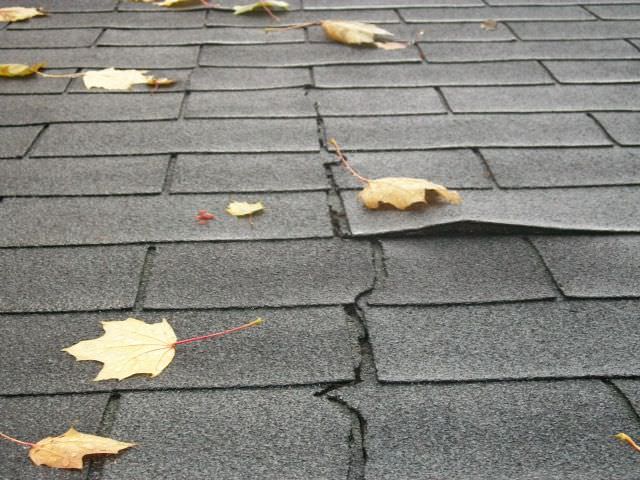

Neal Lewis Posted October 29, 2009 Report Share Posted October 29, 2009 I don't know if i've ever heard of a definitive cause for cracks in older fiberglass shingles? Why do they crack in a straight line and not just random? This line of cracks runs through seven courses of shingles, and is a second layer over older board sheathing. Download Attachment: Dilworth 032.jpg 398.81 KB Link to comment Share on other sites More sharing options...
gtblum Posted October 29, 2009 Report Share Posted October 29, 2009 I'd guess something under it must have moved. Any broken rafters in the attic? Any chance a tree or a limb came down on it? Link to comment Share on other sites More sharing options...
inspector57 Posted October 29, 2009 Report Share Posted October 29, 2009 I can't tell much from the photo, but I have seen damage like that from foundation movement. My guess is something structural. Link to comment Share on other sites More sharing options...
Bill Kibbel Posted October 29, 2009 Report Share Posted October 29, 2009 It's a tear, not a crack. Was it just one, or were there other spots on this roof? Link to comment Share on other sites More sharing options...
Neal Lewis Posted October 29, 2009 Author Report Share Posted October 29, 2009 Yeah, you're right. They're torn, not cracked, and there are sections like this throughout. No problem with the structure at all. I see this frequently with older fiberglass strip shingles and with architectural shingles from the 80's. There was the class action lawsuit with GAF Timberline. But why the heck does it happen, especially in rows? Link to comment Share on other sites More sharing options...
Richard Saunders Posted October 29, 2009 Report Share Posted October 29, 2009 Excessive adhesive under the tabs from what I understand. Link to comment Share on other sites More sharing options...
Bill Kibbel Posted October 29, 2009 Report Share Posted October 29, 2009 After hurricane Hugo in '89, under pressure from the insurance industry, several shingle manufacturers increased the bonding strength of the tab adhesive. With normal expansion and contraction, the shingle mats perform like a single membrane and large tears form. When many of the tears are vertical, across several courses, it usually indicates the shingles were installed with the vertical joints laddered rather than staggered up the roof. Also, many three tab shingles back then had very thin mats, that wouldn't meet current tear-resistance requirements. Link to comment Share on other sites More sharing options...
Brandon Whitmore Posted October 29, 2009 Report Share Posted October 29, 2009 I would have guessed instability in the board sheathing as it expands and contractors more than plywood/ OSB and runs perpendicular to the cracks. I learned something new today. Thanks. Link to comment Share on other sites More sharing options...
Chad Fabry Posted October 29, 2009 Report Share Posted October 29, 2009 It's always been my theory that they glued together too effectively and as the glue lost its resiliency the shingles tore in high stress areas. Whenever I see these tears the roofs are melded together like liberals at a Jesse Jackson rally. On a hot day the shingles are baking and then a rain contracts the top layers while the 170 degree attic heats the bottom layers creating a differential expansion like a head gasket between an iron block and an aluminum head. Please, consider the source. Link to comment Share on other sites More sharing options...
