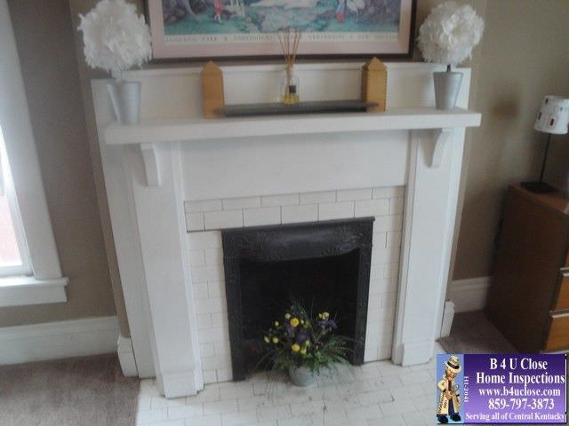

Erby Posted July 20, 2010 Report Share Posted July 20, 2010 The largest majority of 100 plus year old fireplaces I see around Kentucky are coal burning fireplaces. Way shallow with metal grate to hold the coal off the floor and a metal cover to radiate the heat into the room. Sometimes the cover is still there. Sometimes not. In any case, they're mostly useless nowadays, though I've seen a few with funky gas logs installed in them. Click to Enlarge 44.97 KB Click to Enlarge 40.6 KB - Quote Link to comment Share on other sites More sharing options...
mgbinspect Posted July 20, 2010 Report Share Posted July 20, 2010 Many of the very old fireplaces in the downtown parts of Richmond are very shallow for another reason. tHey were designed to burn coal within a cast iron coal basket. The Copperclad cook stove I used in one of my 100+ year homes had in ter-changeable cast iron grates for the firebox - one for wood and one for coal. Quote Link to comment Share on other sites More sharing options...
mgbinspect Posted July 20, 2010 Report Share Posted July 20, 2010 The largest majority of 100 plus year old fireplaces I see around Kentucky are coal burning fireplaces. Way shallow with metal grate to hold the coal off the floor and a metal cover to radiate the heat into the room. Sometimes the cover is still there. Sometimes not. In any case, they're mostly useless nowadays, though I've seen a few with funky gas logs installed in them. Click to Enlarge 44.97 KB Click to Enlarge 40.6 KB - [:-thumbd] I think the gas burninng coal basket replicas are a nice touch. If I had such a fireplace, I'd install them. Quote Link to comment Share on other sites More sharing options...
