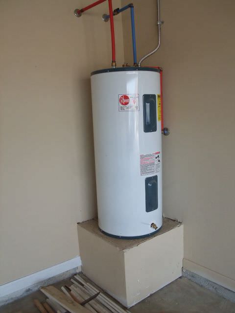

Marc Posted October 27, 2010 Author Report Share Posted October 27, 2010 So the question was a thinly veiled way to announce your birthday?[] Seriously, though, happy birthday Marc. I'm just a little over 5 years behind ya... Actually, No. This was yesterday's inspection.... Click to Enlarge 22.62 KB Marc Quote Link to comment Share on other sites More sharing options...
John Kogel Posted October 27, 2010 Report Share Posted October 27, 2010 Marc, I often see wooden stands under the tank here, usually just a table built from 2 X lumber. Only the gas units need to be elevated in my northern neck of the woods. We can have electric water heaters sitting right on the garage floor. On another note, we don't like to see PEX pipe crimped directly to the tank like that. It is better to have 18" copper stubs there between the tank and the plastic pipe. Edit: That may not be a requirement for electric tanks in your area, but it is usually done that way here. (Nevertheless, I have found electric water heaters with the PEX directly attached with no visible sign of trouble.) Welcome to the 55+ club! Quote Link to comment Share on other sites More sharing options...
inspector57 Posted October 27, 2010 Report Share Posted October 27, 2010 It may be a stretch in a garage but I always call out a lack of a drain pan if the structure can be damaged by a leaking heater. This installation is very typical here and it is also quite common to find a water damaged wall and mold since the platforms are always built as part of the wall construction that is the common wall to the house. Water heaters fail because they leak. The structure WILL be damaged every 12-15 years as part of the normal and expected function. The AHJ does not require a pan if the heater is located in the garage (which I could agree with IF it was a metal stand) but if they looked at the code by the intent of preventing damage to the structure, it is pretty easy to support requiring a pan. Quote Link to comment Share on other sites More sharing options...
Terence McCann Posted October 27, 2010 Report Share Posted October 27, 2010 Marc, I often see wooden stands under the tank here, usually just a table built from 2 X lumber. Only the gas units need to be elevated in my northern neck of the woods. We can have electric water heaters sitting right on the garage floor. On another note, we don't like to see PEX pipe crimped directly to the tank like that. It is better to have 18" copper stubs there between the tank and the plastic pipe. Welcome to the 55+ club! Happy b-day Marc. Copper stubs would not be necessary on an electric tank. Quote Link to comment Share on other sites More sharing options...
Marc Posted October 27, 2010 Author Report Share Posted October 27, 2010 I recommended the pan. Is there a cite on 18" copper stubs for gas powered units? Marc Quote Link to comment Share on other sites More sharing options...
gtblum Posted October 27, 2010 Report Share Posted October 27, 2010 I recommended the pan. Is there a cite on 18" copper stubs for gas powered units? Marc Whose pex is it? They're not all the same. Zurn PEX must be kept at least 6" awayfrom the exhaust vent of a gas-fired water heater. Quote Link to comment Share on other sites More sharing options...
Marc Posted October 27, 2010 Author Report Share Posted October 27, 2010 I never checked. I just confirmed that it was not orange and blue which may have indicated Kitec. Marc Quote Link to comment Share on other sites More sharing options...
charlieb Posted October 27, 2010 Report Share Posted October 27, 2010 I'm with Gary. I only know of one manufacturer who approves a direct connection. The manufacturer association installation guidelines state it should have an 18" leader. Quote Link to comment Share on other sites More sharing options...
hausdok Posted October 27, 2010 Report Share Posted October 27, 2010 It all hinges on manufacturer's specs. According to the Plastic Pipe Institute design guide: PEX tubing may be connected directly to residential electric water heaters, if the local code and manufacturerââ¬â¢s instructions allow. When connecting PEX tube to gas water heaters, the tube must be kept at least 6 inches away from the exhaust vent of the heater. Flexible metal water heater connectors may be needed in some instances. ONE TEAM - ONE FIGHT!!! Mike Quote Link to comment Share on other sites More sharing options...
