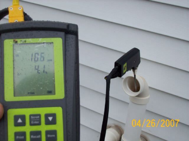

matto Posted April 29, 2011 Report Share Posted April 29, 2011 At what point do you call BS?? Performing a CO test at the exhaust port on a power vented furnace and had a reading of 186PPM "new furnace". HVAC tech called me and asked where I took the reading. (I took readinag at the exhaust) I explained that I do not drill/test into pvc vent pipes. He told me that he took a reading in the flue gas and his reading were 26PPM. I allowed 10 min of operation (steady state). My question is 2/9 fold: 1 If the tech did not allow for steady state would the CO level rise? 2 If I take the reading at the exhaust and that reading is significantly higher should there be a concern that the exhaust fan or pressure switch is holding back gasses. 3 If the tech adjusted the gas pressure flow before testing for CO would that decrease co level 4 The tech called me and asked where I tested ......why would he care....he is the expert right... Click to Enlarge 32.54 KB Quote Link to comment Share on other sites More sharing options...

SNations Posted May 1, 2011 Report Share Posted May 1, 2011 I agree with Kurt and Mike regarding the benefits of CO testing during a home inspection. But . . . . According to the Building Performance Institute (www.bpi.org) guidelines: You should definitely be at steady state, and I would think 10 minutes is plenty. But I think this allows the CO level to drop, not rise. You were right not to drill through a power vented flue, and to measure at the exterior outlet. I hope the tech recognizes this. CO levels should be below 25 ppm, and in no case should it be above 100 ppm in undiluted flue gas. As to why you and the tech got such different readings: there are probably a million possibilities and that's one reason why testing for CO might be futile. Way too many false positives and false negatives. Quote Link to comment Share on other sites More sharing options...

SNations Posted May 1, 2011 Report Share Posted May 1, 2011 CO levels should be below 25 ppm, and in no case should it be above 100 ppm in undiluted flue gas. The consequences of high CO concentrations in the flue of a residential appliance being what? If you don't mind educating me. Marc I didn't write the BPI standards, of course, so don't hold me to any of this. For sealed combustion appliances I believe that it's just an efficiency issue. For atmospherically vented appliances spillage is a huge concern, and worst-case depressurization testing is also required. If you were to argue against raising much fuss over an elevated reading in a direct vent furnace you would have a lot of company, from what I can tell. But that's what the standards say. Quote Link to comment Share on other sites More sharing options...
