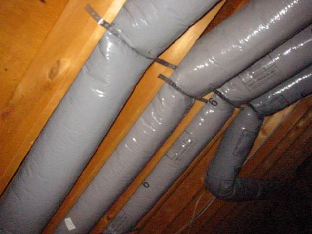

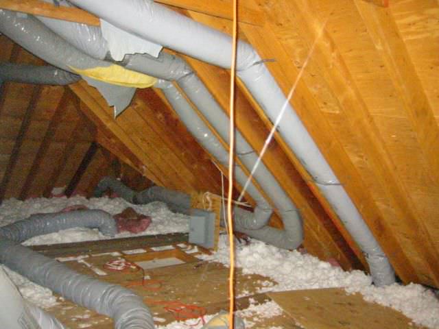

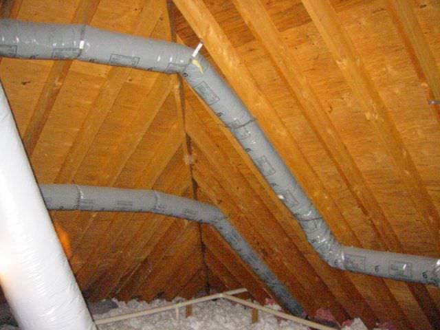

Inspectorjoe Posted July 13, 2011 Report Share Posted July 13, 2011 Yesterday I had a good-size 1986 Tudor. During my initial tour of the property I noticed both heat pump outside units were manufactured July 2007 and the basement indoor unit was a month older. I shouldn't have much to do as far as HVAC I thought. One thing was strange though - the airflow at all of the registers on the second floor was very anemic and not very cool. It was 90 degrees and sunny. When I finally got up into the attic nearly 5 hours into the inspection, my breath was taken away - not by the heat, but by this train wreck of a duct system. What on Earth were they thinking? Click to Enlarge 60.92 KB Click to Enlarge 57.81 KB Click to Enlarge 51.34 KB Click to Enlarge 50.66 KB Outside air temp was 90. I didn't check the attic temp, but it wasn't too comfy. After running full-tilt for nearly 5 hours, the system couldn't get the second floor lower than 85 degrees. At the plenums, the return temp was 87.1 and supply temp 60.7. Just had to share. Quote Link to comment Share on other sites More sharing options...

Terence McCann Posted July 13, 2011 Report Share Posted July 13, 2011 Could be something simple too like a dirty filter, dampers being closed... I don't think you can make a call whether the a/c is working properly just by seeing if the room temperature drops - too many variables. In Joe's post the a/c could have been working great but the air distribution system is crap. Quote Link to comment Share on other sites More sharing options...
Marc Posted July 13, 2011 Report Share Posted July 13, 2011 Could be something simple too like a dirty filter, dampers being closed... I don't think you can make a call whether the a/c is working properly just by seeing if the room temperature drops - too many variables. In Joe's post the a/c could have been working great but the air distribution system is crap. Hello Terry, I define HVAC system as including the ducts. As an inspector I don't care much for determining whether an AC issue is with the ducts, air handler/furnace or condenser unit or all of the above, though I do check many particulars such as filters, coils, ducts, etc. I guess what I'm saying here is that I often see the whole system in such a big mess that I just write it up once and make my recommendation for review/repair by a contractor. The test that I do gives me foundation that few can argue with. This is what I would have likely done with Joe's OP. BTW, my Fluke 971 measures humidity as well as temps, which I may also chk if temps haven't dropped. Marc Quote Link to comment Share on other sites More sharing options...
