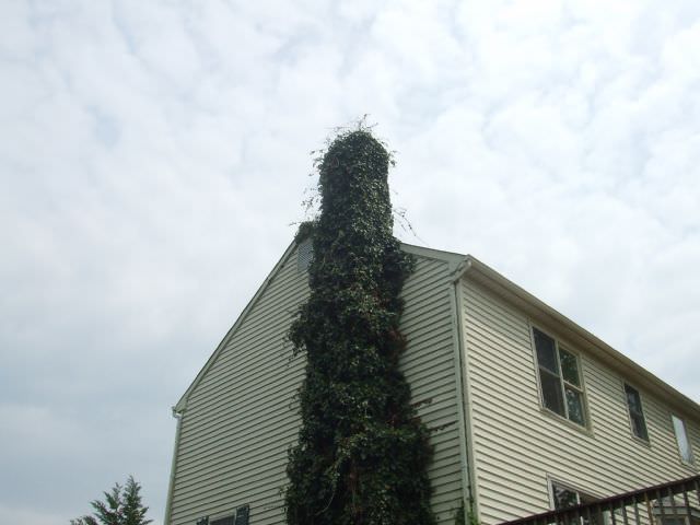

pete moss Posted March 1, 2012 Report Share Posted March 1, 2012 ivy had penetrated the wall cavities and was coming thru the baseboards and attic. ivy should not be permitted to grow on exterior walls or chimneys. Click to Enlarge 41.29 KB Quote Link to comment Share on other sites More sharing options...

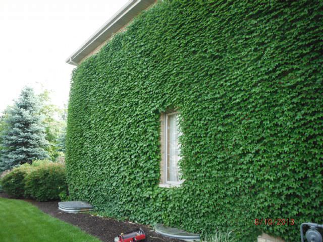

Mike Lamb Posted June 11, 2013 Report Share Posted June 11, 2013 This is a 10-year-old brick veneer home. I'm recommending the ivy be removed because it holds moisture which attracts bugs. I really can't tell what it is doing to the brick-and-mortar. Click to Enlarge 90.88 KB Quote Link to comment Share on other sites More sharing options...

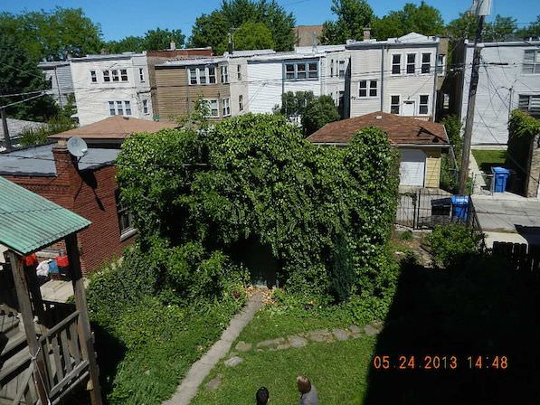

kurt Posted June 11, 2013 Author Report Share Posted June 11, 2013 I think there's a garage in there somewhere. Click to Enlarge 89.89 KB Quote Link to comment Share on other sites More sharing options...
John Dirks Jr Posted June 12, 2013 Report Share Posted June 12, 2013 Set the ivy roots into mortar aside for a moment. Bricks absorb moisture and expand over their life, correct? Ivy can trap moisture against the brick that might otherwise evaporate. I see the general moisture issue as much of a concern as root damage. Expanding bricks are going to move. Gaps open up, more water comes in......and so on. Quote Link to comment Share on other sites More sharing options...

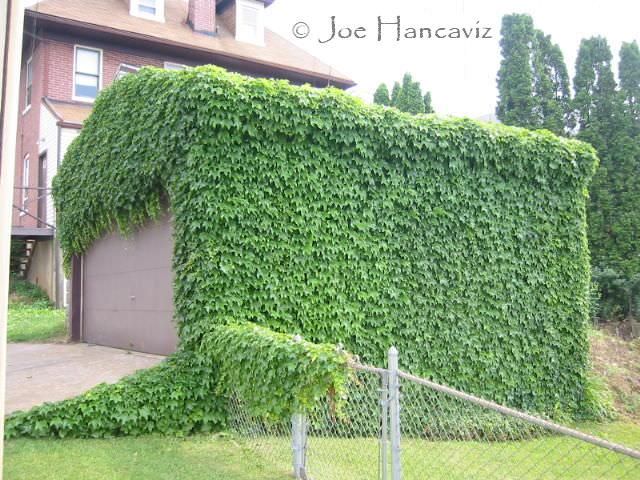

Inspectorjoe Posted June 12, 2013 Report Share Posted June 12, 2013 This must have taken a lot of time and devotion. Click to Enlarge 90.99 KB Quote Link to comment Share on other sites More sharing options...
