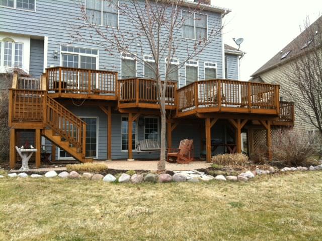

TimDever Posted March 11, 2012 Report Share Posted March 11, 2012 We bought our dream home two years ago. So we thought. The entire back of the home has a tri level deck attached to the home. It appears that there was flashing installed but NO drip cap. Water is seeping into the lower part of the house where the lag bolts go through the ledger board. Permits were pulled back when the home was built. The city approved the deck and home back in 2000. To further the problems the deck was pitched towards the home. Dumb move! Also each board is cut on a diagonal towards the home (fancy deck boards). The back of the home is cedar. Water and interior rot drywall mold etc. The city inspector came out and gave me a line of what my dog deposits in my back yard. The code we followed back then was the national code and a drip cap is not required. Hmmmmm I am not in construction but I am guessing a drip cap ontop of the ledger board has been the norm for a hundred years. We paid an inspector who didn't see it. My question is do I have any recourse to file suit against the city for approving the permit and claiming all was done to code? Can I sue the inspector? To fix this mess will cost me a boat load. The entire top of the deck needs to come off to correct the problem because if the angle of the boards. Thanks Any help is appreciated! Quote Link to comment Share on other sites More sharing options...

TimDever Posted March 12, 2012 Author Report Share Posted March 12, 2012 I'll post pictures in the morning. The entire surface of a deck will have to come up in order to put a drip cap on. Or I might cut a 2 by 4 width along the entire house then install the drip cap then install the 2 by and support from beneath. It will look terrible. But I don't see any other way around it Quote Link to comment Share on other sites More sharing options...

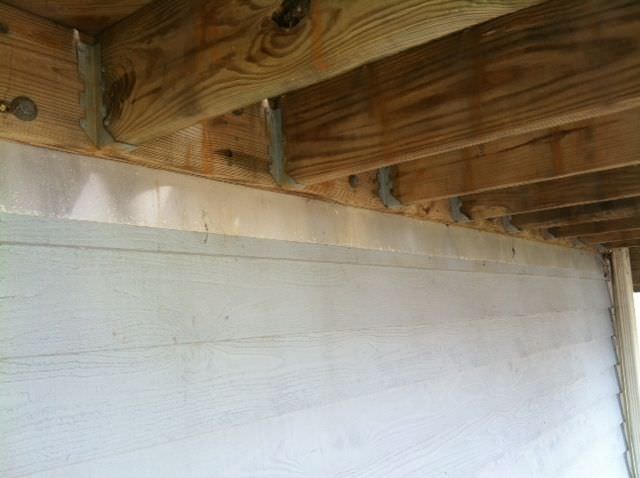

TimDever Posted March 12, 2012 Author Report Share Posted March 12, 2012 Click to Enlarge 63.66 KB Quote Link to comment Share on other sites More sharing options...

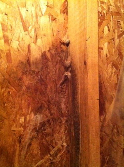

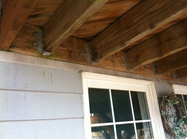

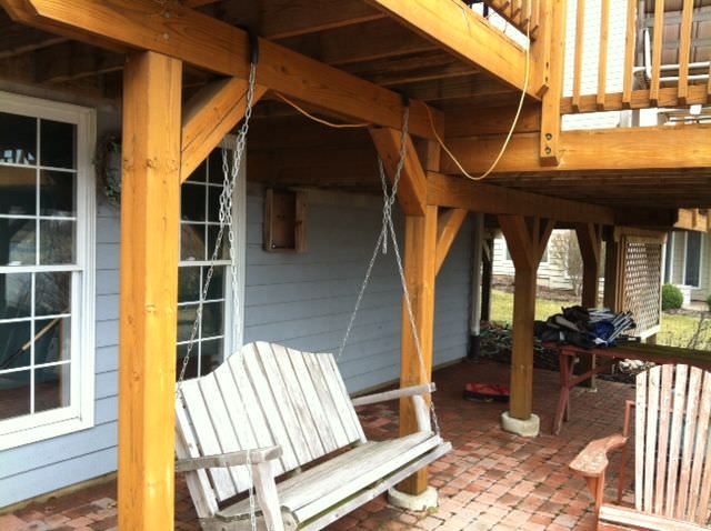

TimDever Posted March 12, 2012 Author Report Share Posted March 12, 2012 Click to Enlarge 65.63 KB Click to Enlarge 46.43 KB Download Attachment: photo.JPG 110.11 KB Click to Enlarge 83.32 KB Click to Enlarge 38.38 KB Quote Link to comment Share on other sites More sharing options...
hausdok Posted March 12, 2012 Report Share Posted March 12, 2012 That's OSB, The idiot that hung the deck should have repositioned that bolt to hit that stud. If you think it's bad on that side of the wall wait until you strip that siding and see it from the other side. You can't just stick head flashings over that ledger and expect that to be OK - the sugars and starches in that OSB are just going to continue to feed that rot using whatever ambient moisture it can obtain through vapor diffusion. Tear it off and redo the wall or make sure your life insurance is paid up when you go out onto that deck. Obviously, I'm being a little dramatic in order to try and make you understand you can't just stick a bandaid (drip cap flashings) on this and expect it to be fine. ONE TEAM - ONE FIGHT!!! Mike Quote Link to comment Share on other sites More sharing options...
hausdok Posted March 12, 2012 Report Share Posted March 12, 2012 The last photo looks like they used a long apron flashing behind it that drains out over the siding. Any water in the wall behind that? If so, they put the top of the flashing against the WRB behind the siding instead of behind the WRB against the sheathing. The second photo looks like some numb nuts secured the ledger against the face of the siding without any flashing. Then to make matters worse he stuck that piece of trim against the bottom of the ledger and that's caused a drainage issue to become worse. Can you get a crane into that back yard. Those deck sections and the stairs are fairly modular. With some careful preplanning and disassembly you can probably detach them without seriously damageing them, lift them away with a crane, set them down on the ground, make your repairs and then reassemble. I know it's painful, but take it all off the house, strip the siding, fix it right, and then reinstall it all with correctly configured flashings. Do not attempt to jackleg that. I'm serious. If you think you're upset now, wait and see how upset (with yourself) you'll be later when really bad stuff eventually happens if you try to fix that using a CAHO (cheap-ass homeowner) technique. ONE TEAM - ONE FIGHT!!! Mike Quote Link to comment Share on other sites More sharing options...

kurt Posted March 12, 2012 Report Share Posted March 12, 2012 Start by making the deck self supporting. Secure it so it doesn't move laterally; connect it to the house somewhere other than the rotten area and diagonal brace it. Fix the rot and other stuff when you can. Quote Link to comment Share on other sites More sharing options...
