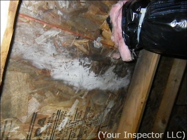

Ryan Star Posted March 15, 2012 Report Share Posted March 15, 2012 What would you cite is occurring as happening with the wood in this photo? Note that the vent plate was recently reattached. It had fallen down due to what is going on here. Is this rot or staining or other? Quote Link to comment Share on other sites More sharing options...
kurt Posted March 15, 2012 Report Share Posted March 15, 2012 It helps to have an establishing shot to see what we're looking at, and a close up. Looks like crappy sheathing, water damaged maybe/probably. Could be scorch marks from fire; hard to say without better pics. With that goofy vent reattachment, it says the rest of it could be just about anything. Quote Link to comment Share on other sites More sharing options...
John Dirks Jr Posted March 15, 2012 Report Share Posted March 15, 2012 I'd say stained and moisture damaged. Is that screws driven up into the sheathing? If so, that's messed up. What is it venting and is there a hood on the exterior side? Quote Link to comment Share on other sites More sharing options...
Ryan Star Posted March 15, 2012 Author Report Share Posted March 15, 2012 It is venting from a bathroom. No fire damage. I took an up close pic to show the wood to ask opinions on it. Is this something a professional inspector should call out in a report to a potential home owner if the inspector saw it and took a picture of it but made no mention of it? Thanks all Quote Link to comment Share on other sites More sharing options...
John Dirks Jr Posted March 15, 2012 Report Share Posted March 15, 2012 I'd have checked the area with a moisture meter. If excessive moisture was there, I would report on it. If it were dry, it's hard to say without being there and seeing more than what the picture you posted shows. Quote Link to comment Share on other sites More sharing options...
Brandon Whitmore Posted March 15, 2012 Report Share Posted March 15, 2012 From what I can see, I don't think the sheathing is rotted. I would have looked, prodded, and then gone right on by if it wasn't. Or, depending on my mood, I would have documented it as an FYI, that is of course assuming that it's not an ongoing issue and isn't rotted. Quote Link to comment Share on other sites More sharing options...
leeboy Posted March 15, 2012 Report Share Posted March 15, 2012 Thats from a detached fan pushing moisture against the sheathing. The only way to see if it is still good is to probe it. Id recommend caulking the crap out of the punctures if those fasteners went thought towards the roof. You can paint on some sort of epoxy product to stop the decay. Im sure someone will recommend one to you from this site. Should have been easily noticed from 10 ft away. Quote Link to comment Share on other sites More sharing options...
Jim Katen Posted March 15, 2012 Report Share Posted March 15, 2012 What would you cite is occurring as happening with the wood in this photo? Note that the vent plate was recently reattached. It had fallen down due to what is going on here. Is this rot or staining or other? During the time that the bath fan was detached, it vented warm, moist air into the attic. In the cold winter months, that moist air condensed on the underside of the OSB sheathing and, over time, caused the outer strands to delaminate. I'll bet you lunch at Michael's Italian Beef & Sausage Co. on Sandy Avenue, in Portland, OR, that the damage is purely superficial. But don't let that stop you. Go ahead and sue your home inspector. . . Quote Link to comment Share on other sites More sharing options...
hausdok Posted March 15, 2012 Report Share Posted March 15, 2012 I've found about half a dozen done like that. They all had that same leakage and the OSB was delaminating around them exactly as it is in that photo. Instead of spending $20 on a decent rain cap with a male extension that goes completely through the roof and is seamless, they screwed a homemade flange beneath a hole on the underside of the roof and installed the connector between the fan and the roof. On the other side of the deck is a jack vent. The homemade flange isn't sealed to the underside of the roof and the mesh in the jack gets clogged with dust sent up there by the fan (A regular rain cap uses mesh with a larger grid that dust passes through). If the hole in the roof is smaller than the connector and causes a restriction or the dust accumulation becomes too great, air gets pushed out between the flange and the roof and that moisture condenses on the cold OSB at nights, in winter and on the shaded side of the roof. Fungi spore finds that moisture and starts to feed on the starches and sugars on the OSB. The deck eventually starts to rot. Quote Link to comment Share on other sites More sharing options...

David Meiland Posted March 19, 2012 Report Share Posted March 19, 2012 Yeah, pretty much. It doesn't warrant a significant repair. Any half-decent contractor-type is going to re-attach the pipe in a few minutes, using fiendish cleverness to outwit the circumstances. You don't need to strip the roof and replace the sheet. Nothing is going to happen because of that discoloration. Quote Link to comment Share on other sites More sharing options...

Brandon Whitmore Posted March 19, 2012 Report Share Posted March 19, 2012 OP-- it is my opinion that you are making an issue out of nothing. Fix the cause (detached / poorly sealed vent), and move on with life. You can clearly see the discoloration in the inspector's report, so it's not like the inspector didn't see it. Heck, he saw the stains ,which is what clued him in to write up the fact that the duct needed fixin'. I have to assume that he checked this area out after seeing the staining. Why is it that you would like compensation for this? What will you do with said compensation? Reason I ask, is that you haven't provided anything indicating repairs are warranted. Fixing something that doesn't need fixed is pointless. Quote Link to comment Share on other sites More sharing options...

hausdok Posted March 19, 2012 Report Share Posted March 19, 2012 Hi, You're off base because you kept talking about mold in your correspondence to the inspector, which tells me you have some kind of idea in your head that you're somehow going to be poisoned by "toxic" mold. Get that whole mold idea out of your mind; the concern is woodrot fungi, not mold. Toxic mold is a myth. The vent is leaking against the underside of the roof and is causing the OSB to rot. It's in first stage - incipient stage - and right now it's just starting to delaminate a little bit. Eventually, if it's not corrected, it will reach second - intermediate - stage and it will look like the OSB in the photo below. If it's not corrected at that point, it will progress to third - advanced - stage and the roof deck will become untenable. By then, incipient rot will have infestd the nearby framing and it will continue its progression until someone does something about it. The longer it's ignored, the more it costs to fix. Right now, it's cheap to fix. The fix is easy, replace the roof jack vent with a proper rain cap with a male extension that comes through the roof. Properly connect and seal the connector from the fan to that extension; so that 100% of all that air goes outside, and then treat the underside of the roof deck, and all visible wood around it, with BoraCare, Timbor, Concrobium or some other borate-based fungicide to kill the spore and make the surface toxic to fungi spore. If you really want to get fancy, have the roof around the vent soda or dry-ice blasted to remove all of the discoloration before you treat it with the fungicide - that way, it won't become an issue at future resale. All of that should cost a few hundred bucks at the most. You and your family are not at risk and your house isn't ready to fall down. He made a mistake because he doesn't have a good understanding of how the wood rot fungi mechanism works. Now he gets a chance to learn so that he won't make the same mistake again. You both win. Any attempt to go beyond that will just be a shameful attempt at a money grab. ONE TEAM - ONE FIGHT!!! Mike Quote Link to comment Share on other sites More sharing options...
