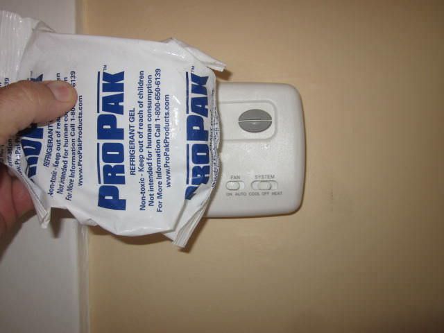

Mike Lamb Posted July 7, 2012 Report Share Posted July 7, 2012 It was too hot for me to run the furnace the other day. The thermostat would only go up to 90F. Someone on TIJ had mentioned putting ice on a thermostat works. I had my client hold the ice pack. It took about 15 minutes for the thermostat to drop to 89F. I don't know why it took so long but the furnace fired. Click to Enlarge 21.7 KB Click to Enlarge 31.54 KB Quote Link to comment Share on other sites More sharing options...

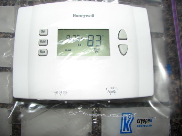

BADAIR Posted July 7, 2012 Report Share Posted July 7, 2012 It was too hot for me to run the furnace the other day. The thermostat would only go up to 90F. Someone on TIJ had mentioned putting ice on a thermostat works. I had my client hold the ice pack. It took about 15 minutes for the thermostat to drop to 89F. I don't know why it took so long but the furnace fired. Click to Enlarge 21.7?KB Click to Enlarge 31.54?KB plastic and air space around/between sensor are poor conductors, thus 15 min delay example: this is my stat, left outside for a few minutes and i know i don't have it set in heat mode, won't happen for 4 more months WARNING!!! not for the faint of heart pull stat and put inside a baggie set atop icepack for 2~3 minutes and good to go Click to Enlarge 21.74?KB Click to Enlarge 31.99?KB Quote Link to comment Share on other sites More sharing options...

Mike Lamb Posted July 7, 2012 Author Report Share Posted July 7, 2012 I've never hot wired a furnace before so I thought this would be safer. My client was more than happy to stand there with the ice bag. Quote Link to comment Share on other sites More sharing options...
