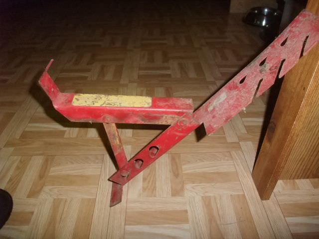

Marc Posted July 17, 2012 Report Share Posted July 17, 2012 I'd take a couple roof jacks left over from my roofing days, break the adhesive bond on a couple shingles, use a flat bar to pull some roofing nails out about 1/4" then hook the jacks on them. From that you can build a simple frame and throw a couple sheets plywood to get a flat surface. Be sure to apply more adhesive to the loosened shingles when you're done. Don't disregard what Kurt said up front: if you're not comfortable with it, don't do it. Marc Click to Enlarge 42.93?KB Quote Link to comment Share on other sites More sharing options...

Marc Posted July 17, 2012 Report Share Posted July 17, 2012 The jack hooks onto an existing roofing nail. That nail needs to be pulled out just 1/4" so the jack can be slid under the shingle and hooked onto the nail. When you're done, just knock the nail back down and apply new adhesive to the shingle. Use 2 or 3 jacks. Marc Quote Link to comment Share on other sites More sharing options...

KStaudt Posted July 17, 2012 Report Share Posted July 17, 2012 The jack hooks onto an existing roofing nail. That nail needs to be pulled out just 1/4" so the jack can be slid under the shingle and hooked onto the nail. When you're done, just knock the nail back down and apply new adhesive to the shingle. Use 2 or 3 jacks. Marc Never rely on a single roofing nail to support a jack. Do your research as to how to safely install the jacks. Roofing nail heads commonly snap off. Quote Link to comment Share on other sites More sharing options...

David Meiland Posted July 18, 2012 Report Share Posted July 18, 2012 Never rely on a single roofing nail to support a jack. Do your research as to how to safely install the jacks. Roofing nail heads commonly snap off. I have to agree with this. I use roof jacks a lot, and never use roofing nails to set them, I use 16d sinkers. Roofing nails are often 1" or less, they're rarely into the framing at all even if they were long enough, they're often just into 7/16" OSB, they're often not that straight, and once you start backing them out they get even looser. Quote Link to comment Share on other sites More sharing options...
ericwlewis Posted July 18, 2012 Report Share Posted July 18, 2012 Never rely on a single roofing nail to support a jack. Do your research as to how to safely install the jacks. Roofing nail heads commonly snap off. I have to agree with this. I use roof jacks a lot, and never use roofing nails to set them, I use 16d sinkers. Roofing nails are often 1" or less, they're rarely into the framing at all even if they were long enough, they're often just into 7/16" OSB, they're often not that straight, and once you start backing them out they get even looser. I do not disagree with the heads snapping off as I have seen it too many times. What I don't get is, why 16d nails? They rarely (never) hit anything but roof decking and then become a hazard in the attic. I have used roof jacks many times and usually with 1.25" hand "driven" (snug) roof nails, 3 per jack, 2-3 bundles of shingles and two dudes working on a 12/12 with never an incident. On the other hand, one of those 4 wheel drive all terrain bucket lifts are a lot more fun than roof jacks[] Quote Link to comment Share on other sites More sharing options...
David Meiland Posted July 18, 2012 Report Share Posted July 18, 2012 I'm generally building the house or addition, and framing the roof. If it's steep enough for toe boards, we start setting jacks right at the bottom after the first row of sheathing goes on, and the nails go into the rafters or trusses. If I'm setting up on an existing roof, I find the rafters with some scientific tapping of the hammer, and then nail jacks to framing. I'm not a regular roofer by any stretch, just a risk-averse lifetime tradesman who often works at heights. Maybe if I roofed every day I'd get sloppy and just nail jacks to the sheathing. Quote Link to comment Share on other sites More sharing options...
