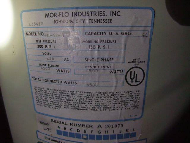

Marc Posted October 26, 2012 Report Share Posted October 26, 2012 I can't find one that works on this Mor-Flo. Anyone wanna hazard a guess? Click to Enlarge 43.73 KB Thanks. Marc Quote Link to comment Share on other sites More sharing options...

Bill Kibbel Posted October 27, 2012 Report Share Posted October 27, 2012 Mor-Flo merged with American in 1996. After the merger, the Mor-Flo/American label was much different than the one in your picture. After the merger, the serial number's 1st 2 digits is the year. You can also check the TPR handle or metal tag to find a 2-digit date. Quote Link to comment Share on other sites More sharing options...
John Kogel Posted October 27, 2012 Report Share Posted October 27, 2012 I found a reference to AO Smith now owning Mor-flo, and this quote: "AO Smith - Can be confusing; digits may be comprised of letters & numbers. May be one, two, or no letters. If two letters first, next two numbers are year. If one letter first, followed by two numbers and another letter, next two numbers are year. If one letter first, next two numbers are year, providing no letter follows. If two numbers first, this is year." Taking that literally, The 1 is an I and your heater is a '97. Maybe. [] Here's where I got that reference, the rigid forum. https://www.ridgidforum.com/forum/t35425/ Quote Link to comment Share on other sites More sharing options...

hausdok Posted October 27, 2012 Report Share Posted October 27, 2012 November 1975. Just before the warranty band are the letter-digits L-75 and then it shows the length of the warranty on that band. L is the month of November (I is skipped) and 75 the year. I didn't get this from any document; it's how I analyzed what I saw, so, I could be full of it up to my eyebrows (Don't think so though). ONE TEAM - ONE FIGHT!!! Mike Quote Link to comment Share on other sites More sharing options...

Robert E Lee Posted October 29, 2012 Report Share Posted October 29, 2012 How about the serial number A 201970, week 20 1970. Quote Link to comment Share on other sites More sharing options...
