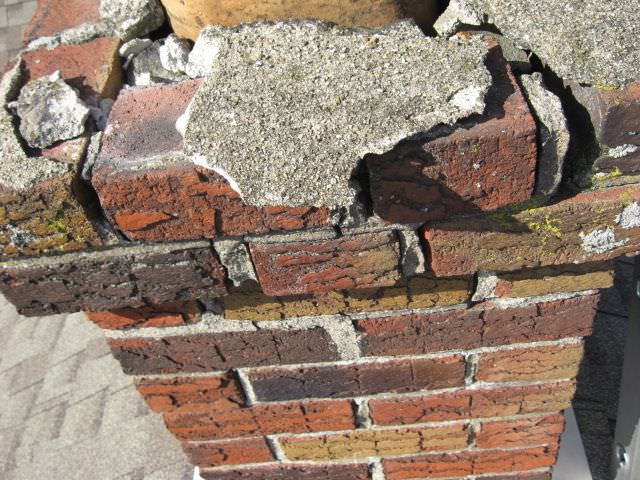

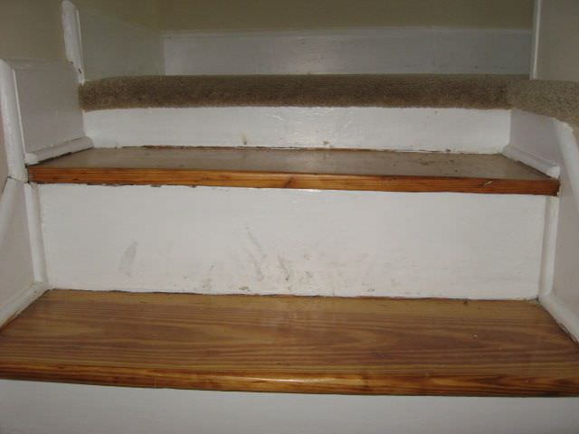

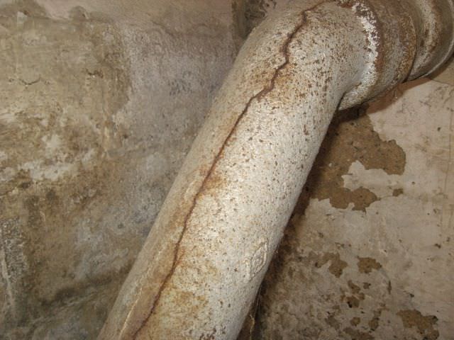

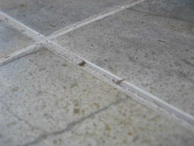

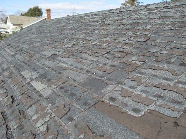

Inspectorjoe Posted March 6, 2013 Report Share Posted March 6, 2013 This morning I had a typical flipper: It looked all shiny and new, but was a disaster beneath the surface. An inspection report was lying on the counter. It was prepared not for the seller, but for the listing agency. The inspection was done two weeks ago, on February 19. That inspection took two hours, according to the report. I was there four hours. The report was horrendous. This is what was said about the garage roof (in its entirety): "The garage roof is beyond its expected useful life and although not currently leaking, will need replacement." Click to Enlarge 84.32 KB This cracked waste pipe is about five feet above the floor, right next to the exterior basement door. It's also cracked on the underside, so naturally, it leaked when water was run. It would be impossible to miss this. There was not a word about it in the report. Click to Enlarge 63.12 KB There is widespread, major termite damage, but not a word about it in the report. Click to Enlarge 70.05 KB Of course, being flipped, new ceramic floors were just installed. In addition to new ceramic being installed over floor framing that had unrepaired termite damage, it was also installed over framing that's shown a history of major movement. The section of basement below this area has finished ceilings, so there's no way to know why there is so much sag. Certainly, it was idiotic to install ceramic without finding out what's going on. There's not a word about this in the report. Click to Enlarge 41.09 KB Needless to say, the tile installation job was crap. The framing under the tub is undersized. The floor crackles when walking on it there. It's uneven enough to be a minor trip hazard, and some of the grout is already failing. Click to Enlarge 35.69 KB Click to Enlarge 39.7 KB This is the top of the main stairs. You'd think a buyer would notice it and realize the implication, but maybe not. There's not a word about it in the report. Click to Enlarge 30.17 KB The chimney was partially rebuilt some time in the past. The house was built in 1930, but the chimney brick looks like it's from the 60's or 70's. The top four sections of liner are OK, but below them, the liner is either very deteriorated, or it transitions to the original unlined brick (it was somewhat hard to see).The top three or four courses of brick were so loose, they could be easily pulled apart by hand. The chimney was mentioned in the report. A photo of the chimney part of the report is below. Click to Enlarge 97.23 KB Click to Enlarge 43.87 KB Download Attachment: Copy of 1 317.jpg 197.84 KB These are just a few of the bigger things. There are literally dozens of things that I'll be putting in my report that are absent in the pre-listing report. This has me shocked and angry. I'm shocked because I know the inspector. I'm sure many of you here have met him, or know of him. I'm shocked to see the caliber of his report. I'm angry because he's an ASHI Certified Inspector (as am I), and frankly, I feel that he?s cheapening my credentials. I'm used to flippers pushing off crap like I saw today, but it turns my stomach to see a fellow ASHI member facilitate it. I'm also angry, because if the young woman buying this house had relied on the pre-inspection report, she'd have been in a world of hurt down the road. I did an inspection for her parents about eight years ago and they recommended to her that she hire me to do an independent inspection. Thank goodness for caring parents. I really don't know why this is bugging me so much. That report is really no concern of mine. Maybe I'm just too naive or idealistic. I do feel a bit better after my rant. Now on to the report. It's going to be a long night. Quote Link to comment Share on other sites More sharing options...
