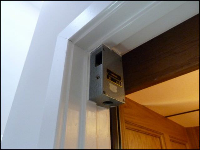

John Dirks Jr Posted December 3, 2013 Author Report Share Posted December 3, 2013 Here is one important safety feature that the occupants mentioned did not work properly on occasion. It's an automatic latch that prevents the door from being opened unless the elevator is on that level and waiting. Could you imagine opening the door and stepping into an empty shaft? Click to Enlarge 30.06 KB Quote Link to comment Share on other sites More sharing options...
Jim Katen Posted December 3, 2013 Report Share Posted December 3, 2013 . . . Could you imagine opening the door and stepping into an empty shaft?. . . It was the most memorable episode of LA Law: Quote Link to comment Share on other sites More sharing options...
