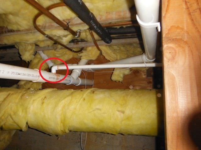

Denray Posted December 27, 2013 Report Share Posted December 27, 2013 Seems like most of the HVAC boys around here don't think there is a need for terminating the condensate drain above a P-trap for condensing furnaces. What are the problems of doing it this way? Plus I was told that having a pan below upstairs furnaces was also good for propane in case is leaked gas it would flow down and out instead of into the walls, etc. Sounds good. Never heard that before. Click to Enlarge 52.21 KB Quote Link to comment Share on other sites More sharing options...
inspector57 Posted December 27, 2013 Report Share Posted December 27, 2013 If that is actually connected to the drain it is wrong on many levels. There must be an indirect connection. connecting directly to the sewer like that can leak methane into the house. Not as bad as an a/c condensate since it would not be in the environmental air, but still wrong. Also, that is an improper connection to the sewer line, not a fitting, just drilled into the line, maybe the plumbers among us can give you chapter and verse. Quote Link to comment Share on other sites More sharing options...

Samuel Rock Posted February 12, 2014 Report Share Posted February 12, 2014 First of all I see no P-Trap. If this unit has negative air flow at the evaporator it must have a P-Trap to keep the sewage gas from getting sucked into the air handler. If the unit is of the Trane/American Standard make TAM7 or TAM5 then it is a positive pressure unit and does not need a P-Trap as its always pushing air down the drain. Either way it needs what is called an AirGap where it ties into the sewage line and depending on what version of the IMC your state uses you may not be able to pipe it to the vent line like that you will need to run the 3/4 line down to a drain level where the vent starts. The air gap cannot be installed by the HVAC contractor it must be installed by a plumber! The first 18ft of the condensate line must be insulated with rubbertex to keep it from sweating if its located in a unconditioned space in the home. If the unit is located in the attic it should have a drip pan below it with a emergency drain line connected to a separate AirGap from the air handler drain. The pan should also have a over flow switch to shut the unit down in the event both drains get clogged so that it don't over flow into the attic. Sam Quote Link to comment Share on other sites More sharing options...
