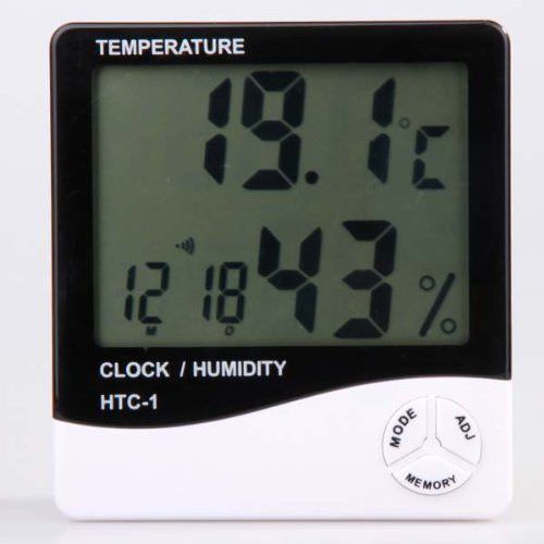

David Meiland Posted February 16, 2014 Report Share Posted February 16, 2014 I did the same thing, tightened my old farmhouse so much (about 2.5 ACH50) that now we have a lot of humidity. We have dual glazing but still get some condensation on the bedroom windows in some cases. The answer is to run a bath fan enough to remove the humidity. This can mean several hours per day. You should have a hygrometer to keep track of things. I installed a Panasonic WhisperGreen fan, rated for continuous use, with a low/continuous setting of 30 CFM (can by adjusted up) and a full speed of 80 CFM (when you hit the switch). A HRV retrofit may be worthwhile, if you have a perfect setup for it (probably an open attic with an easy way to run short, clean duct runs that are insulated). The value of the saved heat you can recover is low if your electric rates are like mine, and the cost of the equipment and install is high, but it can do a better job than a single point exhaust fan. Replacing the windows or adding storms will or course help the condensation, but not the humidity. Quote Link to comment Share on other sites More sharing options...
John Kogel Posted February 16, 2014 Report Share Posted February 16, 2014 Yes, you can get a few of these for $15 each. Click to Enlarge 25.78 KB The ERV/HRV idea is good but when the outdoor humidity is over 70% you don't gain much, except you are circulating the heated air, which is good. Ceiling fans are easy to install, good for circulating warm air. Quote Link to comment Share on other sites More sharing options...
David Meiland Posted February 16, 2014 Report Share Posted February 16, 2014 The winter air is dry enough to easily remove humidity if you ventilate the house. It works like a charm in my place, and Randy is ~50 miles away. One thing I do if I get up in the morning and notice condensation... crack a window in the bedroom and dry a load of laundry. The dryer pulls its makeup air through the bedroom window. Run a load of wash the night before so you have something to work with......... Quote Link to comment Share on other sites More sharing options...
randynavarro Posted February 16, 2014 Author Report Share Posted February 16, 2014 Yes, you can get a few of these for $15 each. Click to Enlarge 25.78 KB The ERV/HRV idea is good but when the outdoor humidity is over 70% you don't gain much, except you are circulating the heated air, which is good. Ceiling fans are easy to install, good for circulating warm air. Those thermometer/hygrometers are so cheap probably because they only measure celsius. . what good is that! I jest. Yes, you brainiacs are confirming my strategies, but this is where it gets tricky. An HRV is my first choice but it will be expensive and I don't have an attic to install it. I have a lowered ceiling over the bathroom (under my vaulted ceiling) in the middle of the house I can install and place sidewall ducts/register on the walls facing in to house. I think that would be ok. The cheapest option is as David has done in his house -- install a higher CFM and quieter bathroom fan in that same bathroom set to run with a digital timer. I'm not sure that would work as well as the HRV. . . I don't know. John poses an interesting dilemma in that if the outdoor humidity is 70% plus, then the HRV may not be much benefit; however, 70% outdoor would not stay that high if I brought that air inside and warmed it. The humidity would drop. BTW, I have dual pane windows throughout the house. I only mentioned the single pane windows as they're the largest and most obviously affected. The dual pane windows condensate heavily as well just not nearly as much. Most obnoxious are the two new skylights I've installed. They condensate so much that we have to leave a towel on our bed as the dripping would soak the bed covering and mattress on a very cold day. Any other thoughts? Quote Link to comment Share on other sites More sharing options...
