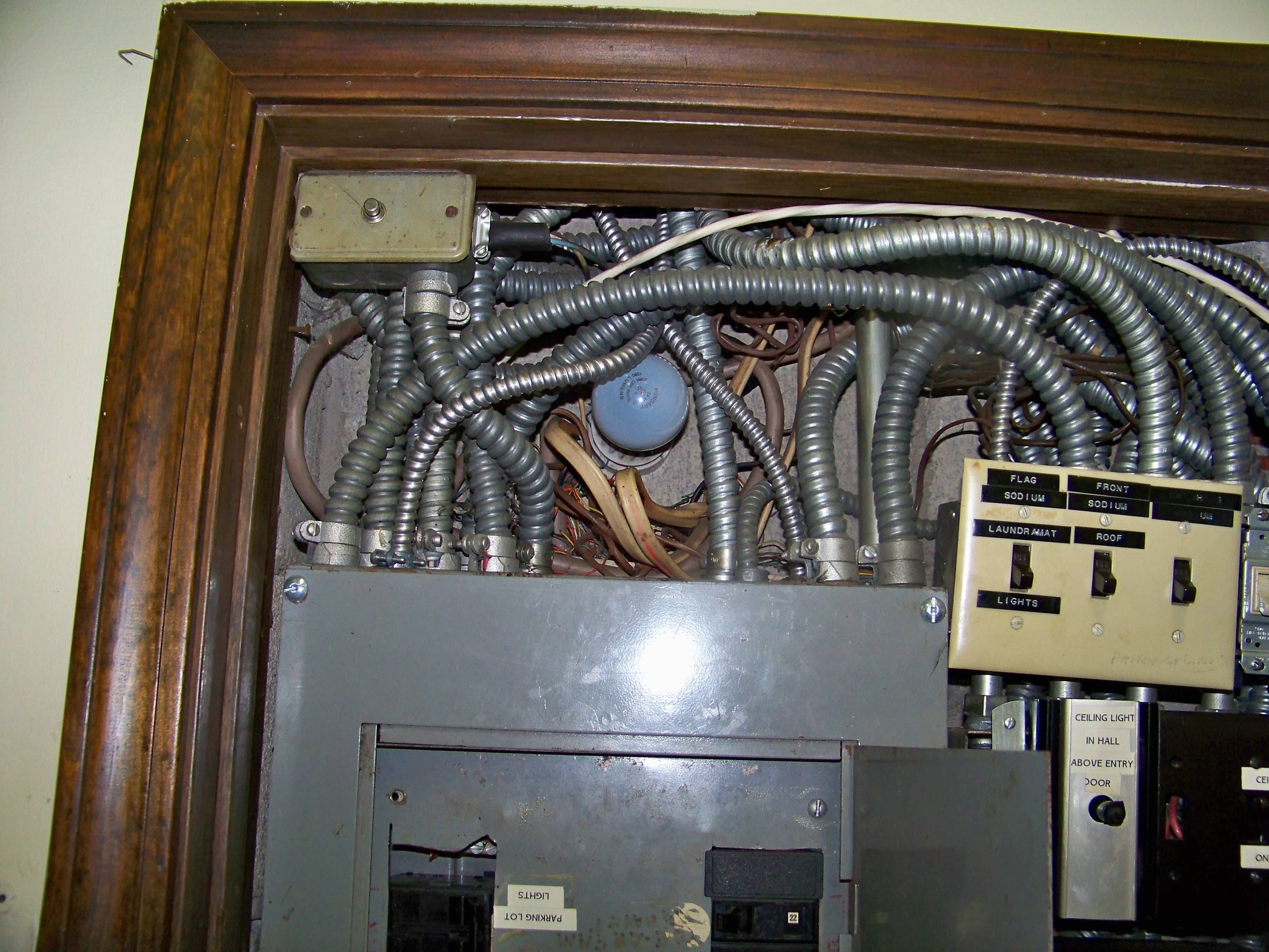

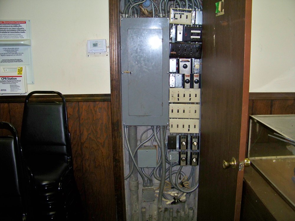

Chad Fabry Posted March 8, 2018 Report Share Posted March 8, 2018 One of 7 panels at a former VFW. And then there's the 3-phase service 3-feet above the flat roof. 1 Quote Link to comment Share on other sites More sharing options...
John Ghent Posted March 8, 2018 Report Share Posted March 8, 2018 (edited) I hope you charged an extra $20 for that. Are all the panels 3phase? Edited March 8, 2018 by John Ghent 2 Quote Link to comment Share on other sites More sharing options...

Marc Posted March 9, 2018 Report Share Posted March 9, 2018 Closet too congested, difficult to service should it be needed. What configuration is it? Delta, Wye, unbalanced neutral? Quote Link to comment Share on other sites More sharing options...
Chad Fabry Posted March 9, 2018 Author Report Share Posted March 9, 2018 11 hours ago, Marc said: Closet too congested, difficult to service should it be needed. What configuration is it? Delta, Wye, unbalanced neutral? Too congested? Don't you think that's harsh? I mean, you can see the required light over the panel still. It is a Wye configuration. Quote Link to comment Share on other sites More sharing options...
