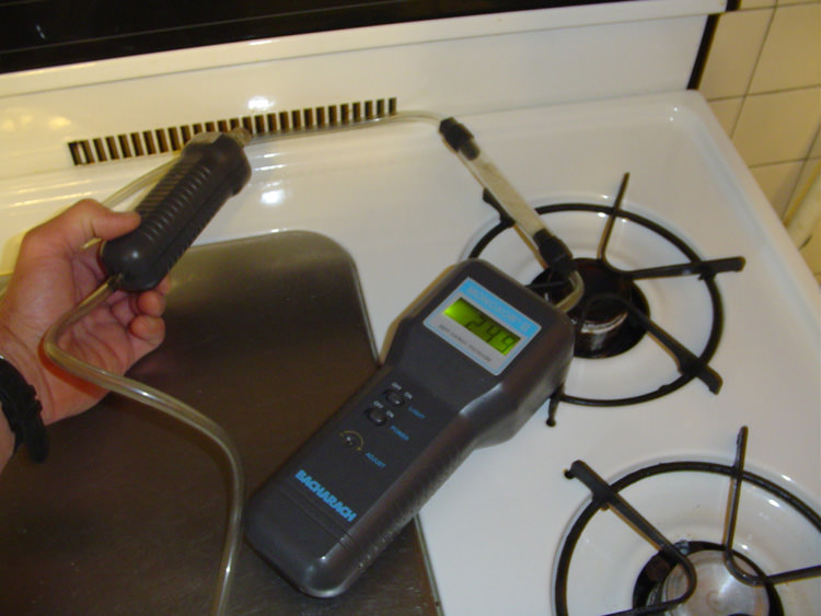

Bain Posted August 24, 2006 Report Share Posted August 24, 2006 All I ever do with ovens is turn them on, make certain the convection fans are spinning if applicable, and check temperatures with a laser thermometer. But today there was a crudded-up oven with goop on the burners, so out of curiosity I whipped out the Monoxor II. The CO level raced to over 200 PPM and would have shot up higher if I hadn't turned the oven off. So now I'm wondering, did I actually observe a defective oven that wasn't properly combusting its gas, or do all ovens spit out CO this way? The EPA says we can endure no more than 8 PPM over an 8-hour period. So what's 200 PPM gonna do to someone standing over a stove? Being the obsessive compulsive idiot I am, I now will be checking the CO output of ovens in every house I wander into. Unless, that is, someone already knows about this stuff. The photo's out of focus, OBTW. Download Attachment: DSC04803a.jpg 148.01 KB Quote Link to comment Share on other sites More sharing options...
hausdok Posted August 25, 2006 Report Share Posted August 25, 2006 Hi, Maybe the CO was produced by the burning crud on the burners! Generally speaking, if a stove is adjusted properly and working OK it won't produce any CO. If it wasn't the smoke from the crud producing the CO, I'd have to believe that it was caused by crud that's blocking the burner orifice and causing the thing to burn crappy. OT - OF!!! M> Quote Link to comment Share on other sites More sharing options...
Bain Posted August 25, 2006 Author Report Share Posted August 25, 2006 Exactly, Mike. That's what I thought. That's why I yanked out the CO detector just to see if the gas was incompletely combusting because of all the yuck. What I didn't know is what was SOP for ovens. Quote Link to comment Share on other sites More sharing options...
randynavarro Posted August 25, 2006 Report Share Posted August 25, 2006 I don't use a CO detector anymore for gas appliances, but when I used to, the CO always spiked (sometimes up to 400-500ppm) upon the burners firing in the oven. I have no reference to state whether this was correct or not, but I gotta think that if every gas oven did this, then its probably normal. Quote Link to comment Share on other sites More sharing options...
randynavarro Posted August 25, 2006 Report Share Posted August 25, 2006 Wait, I read your post again and am confused. You show in the picture and describe high CO at the burners but then you switch to asking about CO levels in ovens. In my experience ovens always show high CO upon startup but burners do not. Quote Link to comment Share on other sites More sharing options...
Jim Katen Posted August 25, 2006 Report Share Posted August 25, 2006 Originally posted by Bain . . . So now I'm wondering, did I actually observe a defective oven that wasn't properly combusting its gas, or do all ovens spit out CO this way? Most gas ovens produce a good whiff of CO on startup. It's very common. Also any goop on the bottom of the oven will give off CO as it slowly combusts. The EPA says we can endure no more than 8 PPM over an 8-hour period. So what's 200 PPM gonna do to someone standing over a stove? Probably not much if it's for a short period of time. Being the obsessive compulsive idiot I am, I now will be checking the CO output of ovens in every house I wander into. . . While you're at it, measure the CO output of electric ovens. You'll be surprised at the results of the dirtier ones. If you want to see some serious CO, measure the output of an electric oven during its cleaning cycle. Some of those things put out enough CO to kill pet birds. - Jim Katen, Oregon Quote Link to comment Share on other sites More sharing options...
Bain Posted August 25, 2006 Author Report Share Posted August 25, 2006 Randy, The exhaust from the oven discharges from the vent behind the burners, hence the confusion regarding the photo. Jim, as always, you're two steps ahead of me on this one. I'll follow your advice and, hopefully, satisfy the little OCD demon inside of me . . . John Quote Link to comment Share on other sites More sharing options...
Brandon Chew Posted August 25, 2006 Report Share Posted August 25, 2006 Try thinking of it this way. It is the concentration (ppm) AND the duration of exposure that determines the health risk. So, you could be exposed to a high ppm of CO for a short period of time and be ok while a much lower ppm for a long enough time can kill you. Most fuel burning appliances will kick out some high levels of CO during startup until they reach their normal operating temperature. With gas ovens or ranges CO is usually not cause for concern unless the flame is out of adjustment (yellow), and even then the oven needs to be in use for a prolonged period of time. Every now and then you'll read in the paper about someone getting CO poisoning from using their oven to heat their home. Makes you wonder if the post meal snooze after the Thanksgiving meal is due to eating the turkey or cooking it ... Brandon Quote Link to comment Share on other sites More sharing options...

Mike Lamb Posted August 29, 2006 Report Share Posted August 29, 2006 If you put foil on the bottom of the oven to catch pizza drippings or whatever, make sure it doesn't cover the air holes. I once, I mean, a friend once did this and the CO detector in my, I mean, my friend's son's room went beserk in about 10 minutes. Since it was a new appliance, he had a guy come out no charge and check it out. The guy said, "You idiot. You can't cover the air holes with foil." Dumb friend. Quote Link to comment Share on other sites More sharing options...
