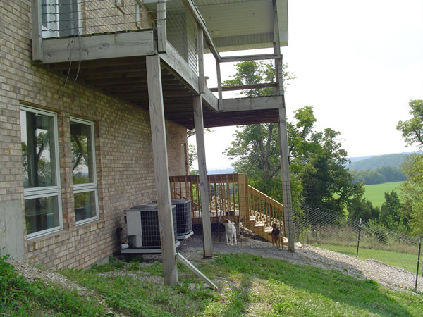

Bain Posted September 9, 2006 Report Share Posted September 9, 2006 I'm a freak about decks being properly configured. The deck in the photo's gonna fail at some point if it isn't repaired. Check out the homeowner's prop against the far left pier, and how the second pier from the left has deflected out of position. The far right rim joists--which aren't visible--had separated nearly an inch due to the pier beneath it moving outward. I had buyers walk away from this house last week, and wondered if I should have sent the sellers a certified letter telling them not to use the deck until it was modified. Download Attachment: DSC04908a.jpg 173.6 KB Quote Link to comment Share on other sites More sharing options...

Brandon Chew Posted September 12, 2006 Report Share Posted September 12, 2006 Regarding the deck in Bain's picture: Has the back of the house decided yet if it wants to join the deck on its journey down the hill? With that large overhang at the eaves, I also wonder how much of the roof load is supported by those posts and how much is cantilevered back to the wall of the house. Thanks for the links to the deck resources. Brandon Quote Link to comment Share on other sites More sharing options...

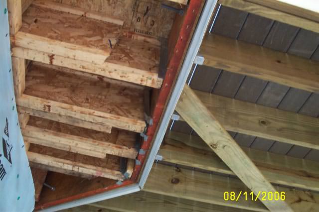

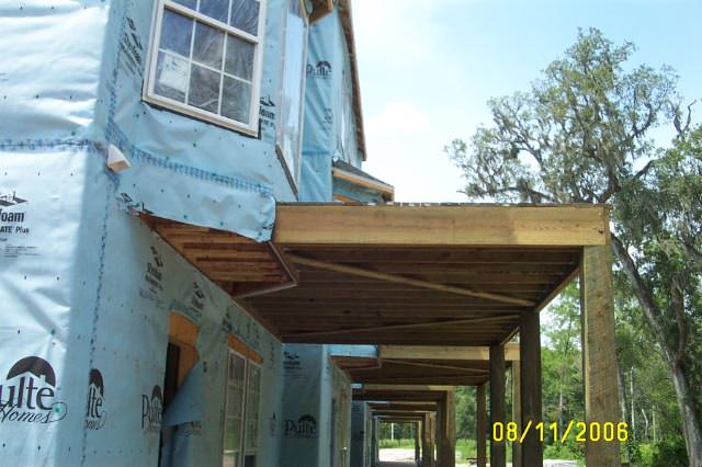

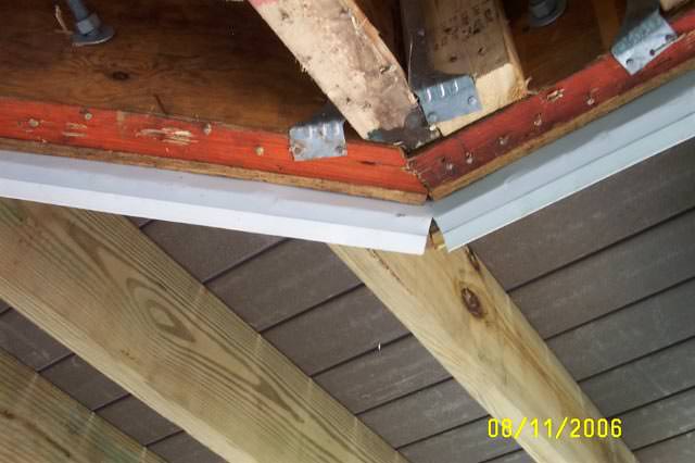

Danny Pritchard Posted September 12, 2006 Report Share Posted September 12, 2006 I looked at this deck a couple of weeks ago. The first picture is of the end unit of a condo complex.The 2nd and 3rd pictures show the balcony joists below the baywindow attached to a ledger that is connected to the I joists of the house using joist hangers.These hangers have been installed upside down and secured to the ledger with 2 nails. Download Attachment: DCP_2539-1.jpg 67.47 KB Download Attachment: DCP_2542.jpg 52.12 KB Download Attachment: DCP_2540.jpg 54.77 KB Quote Link to comment Share on other sites More sharing options...

hausdok Posted September 12, 2006 Author Report Share Posted September 12, 2006 Hi Danny, Uh, Uh. Besides the idiocy of using the hangers upside down, there aren't any stiffeners between those doubled up joists (See Figure 5a-Alternate Method 2 on page 10 of the APA manual at the link in my previous post. ONE TEAM - ONE FIGHT!!! Mike Quote Link to comment Share on other sites More sharing options...
Bain Posted September 13, 2006 Report Share Posted September 13, 2006 And how are the doubled up joists connected to one another? Let's have a party with lots of bodies in the breakfast-nook bay window and on the deck and see what happens. Quote Link to comment Share on other sites More sharing options...

emalernee Posted September 14, 2006 Report Share Posted September 14, 2006 Mike, The upside down hangers are installed that way because the rim joist is hanging from the ends of the I-joists. Seeing as the I-joist are doubled up at the overhang, is means that the joist were not long enough for the bay window. Hows long the extended I-joist are and how they are attached to their sistered joist plus the missing blocking at the I-joist to rim board is the question. That question should be answered by a PE and documented to the AHJ. As it is now, looks like something hacked together by a underpaid and under educated carpenter. Get the AHJ involved and save the world. If they won't help, there is always the Press. Ezra Malernee Canton, Ohio Quote Link to comment Share on other sites More sharing options...
