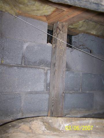

Bob White Posted April 13, 2007 Report Share Posted April 13, 2007 This is the only wood support I've seen ... Download Attachment: joist_support.jpg 31.63 KB Link to comment Share on other sites More sharing options...
