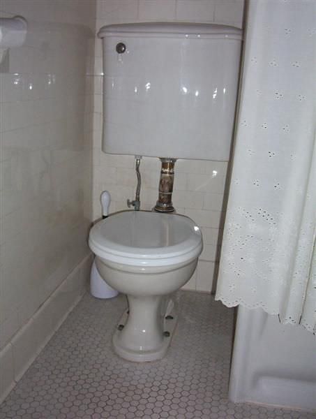

Mike Lamb Posted October 11, 2009 Report Share Posted October 11, 2009 Click to Enlarge 28.11 KB This fixture is 1915-1918-ish. I asked for advice at another TIJ thread as to how to fix a leak on this thing. Because of many complications I repaired the brass drain pipe from the tank to the bowl with Black Swan epoxy. The stuff works. Quote Link to comment Share on other sites More sharing options...
