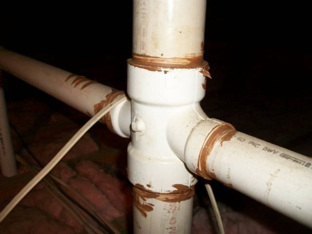

Neal Lewis Posted April 1, 2010 Report Share Posted April 1, 2010 These vent pipes look like they're held together with caulk. Anybody familiar with this brown stuff? Thanks Download Attachment: PVC vent pipes3.jpg 75.86 KB Quote Link to comment Share on other sites More sharing options...
Marc Posted April 1, 2010 Report Share Posted April 1, 2010 I don't know what the brown stuff is but do tell me....that photo is upside down, right? Marc Quote Link to comment Share on other sites More sharing options...
Mike Lamb Posted April 1, 2010 Report Share Posted April 1, 2010 Construction Adhesive? Quote Link to comment Share on other sites More sharing options...
Rocon Posted April 1, 2010 Report Share Posted April 1, 2010 Does the PVC pipe penetrate the roofline? If so is it UV protected, and does it have mastic on it? Quote Link to comment Share on other sites More sharing options...
MTL_Inspet_Man Posted April 1, 2010 Report Share Posted April 1, 2010 is pvc allowed for a plumbing vent pipev penetrating the roof? Yep construction adhesive is a good guess Quote Link to comment Share on other sites More sharing options...
Neal Lewis Posted April 1, 2010 Author Report Share Posted April 1, 2010 The vent stack goes up through the roof, and the pic isn't upside down. PVC is used regularly here for vents with no UV protection. Yeah, I would say it's construction adhesive, come to think of it. Quote Link to comment Share on other sites More sharing options...

Chad Fabry Posted April 2, 2010 Report Share Posted April 2, 2010 Looks Like Sika Flex Quote Link to comment Share on other sites More sharing options...
Marc Posted April 2, 2010 Report Share Posted April 2, 2010 The vent stack goes up through the roof, and the pic isn't upside down. Neal, that 'T' looks upside down. Shouldn't it drain downwards instead of upwards? Marc Quote Link to comment Share on other sites More sharing options...
Richard Saunders Posted April 2, 2010 Report Share Posted April 2, 2010 Marc, its a vent, not a drain. Quote Link to comment Share on other sites More sharing options...
Jim Katen Posted April 2, 2010 Report Share Posted April 2, 2010 The vent stack goes up through the roof, and the pic isn't upside down. Neal, that 'T' looks upside down. Shouldn't it drain downwards instead of upwards? Marc That's the correct configuration for a vent fitting. Vent piping is supposed to drain back toward the fixture. The fitings have a 1/4" per foot pitch built into them. If you were to install the fitting "right side up," the pipes that you attached to it would pitch the wrong way. - Jim Katen, Oregon Quote Link to comment Share on other sites More sharing options...
plummen Posted April 2, 2010 Report Share Posted April 2, 2010 I don't know what the brown stuff is but do tell me....that photo is upside down, right? Marc nope,you want the san tee to roll up on the vent just like in picture.for a drain it would roll down Quote Link to comment Share on other sites More sharing options...
Marc Posted April 2, 2010 Report Share Posted April 2, 2010 Gotcha. Thanks. Plumbing ain't my forte. Marc Quote Link to comment Share on other sites More sharing options...

patt Posted April 2, 2010 Report Share Posted April 2, 2010 Bill and Mike FYI California has been on the Uniform Plumbing Code for decades and printed with the code are the installation standards. Some of these years ago had to be adopted separately by the AHJ but under the current code the protection required all approved plastic piping is adopted statewide. 2007 California Plumbing Code Installation Standard ABS BUILDING DRAIN, WASTE, AND VENT PIPE AND FITTINGS IAPMO IS 5-2003 2.2.3 Exposed Piping Piping shall not be exposed to direct sunlight. Exception: Vent piping through roof. Plumbing vents through roof, exposed to sunlight, shall be protected by water base synthetic latex paints. Adequate support shall be provided where ABS piping is exposed to wind, snow, and ice loading. Installation Standard PVC BUILDING DRAIN, WASTE AND VENT PIPE AND FITTINGS IAPMO IS 9-2003 2.3.3 Exposed Piping Piping shall not be exposed to direct sunlight. Exception: Vent piping through roof. Plumbing vents through roof, exposed to sunlight, shall be protected by water base synthetic latex paints. Adequate support shall be provided where PVC piping is exposed to wind, snow and ice loading. Quote Link to comment Share on other sites More sharing options...
Jim Katen Posted April 3, 2010 Report Share Posted April 3, 2010 . . . but I'm not entirely convinced that UV is going to damage it to the extent where it's "brittle" as you've stated. I inspected a 10-year old PVC roof the other day that's not coated with any inhibitors of any kind and it seems to be able to handle the UV just fine. What standard are you using?. . . Both Washington & Oregon have exactly the same requirements as Cali. They apply to both PVC and ABS pipe. Neither is supposed to be left exposed to sunlight. In WA, you'll find the rule at the end of the plumbing code, under the "Installation Standards" section. The section numbers are 2.2.3 in both the ABS and the PVC standards. Of course, this rule is routinely ignored at rain drains and at plumbing vents. - Jim Katen, Oregon Quote Link to comment Share on other sites More sharing options...
