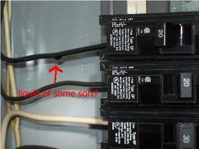

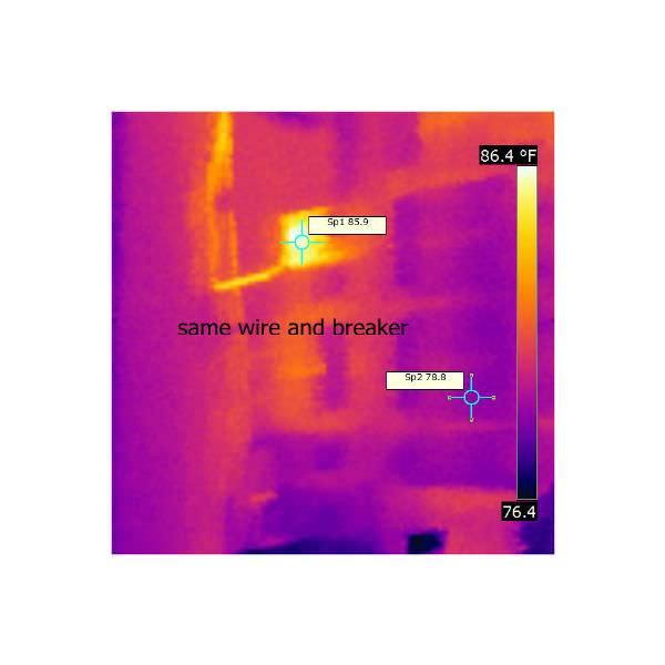

CoolSigns Posted June 29, 2011 Report Share Posted June 29, 2011 pic one will show a 12 gauge wire with liquid on it. pic 2 will show it in infrared. Click to Enlarge 22.21 KB Click to Enlarge 26.04 KB As I took the cover plate off I noticed a liquid on one of the wires, I took my screwdriver and carefully touch it. It was a greenish/blackish color...no kind of leakage anywhere to be found, so it must have come from the wire possibly melting. I was sitting on their washing machine and a cabinet prevented me to see the connection to the breaker. I did notice what I could see had this liquid on the bottom side of this wire from the breaker to the drip. I had just gotten my new FLIR I7 today and scanned the panel, which is pic 2. The temperature was 85.9 on the hot breaker and the second measurement, botoom right was 78.8, 20amp also..... I told the client of this problem and suggested I turn it off to prevent any damage and that she should call to get an electrician here to further investigate the issue. I shut the breaker off and the fridge, kitchen, laundry room, and central ac died..... Seems like a major overload to me. What do you think? I did suggest leaving the ac off and we could turn the breaker back on to run the fridge until an electrician showed up . We did. Right or Wrong? Link to comment Share on other sites More sharing options...
Jim Katen Posted June 29, 2011 Report Share Posted June 29, 2011 pic one will show a 12 gauge wire with liquid on it. pic 2 will show it in infrared. As I took the cover plate off I noticed a liquid on one of the wires, I took my screwdriver and carefully touch it. It was a greenish/blackish color...no kind of leakage anywhere to be found, so it must have come from the wire possibly melting. I was sitting on their washing machine and a cabinet prevented me to see the connection to the breaker. I did notice what I could see had this liquid on the bottom side of this wire from the breaker to the drip. I've seen that liquid several times before. I'm nearly convinced that it's a byproduct of the wire manufacturing process and not related to overheating of anything. I had just gotten my new FLIR I7 today and scanned the panel, which is pic 2. The temperature was 85.9 on the hot breaker and the second measurement, botoom right was 78.8, 20amp also..... I hope you're not suggesting that the temperatures that you measured today are a problem. They're well within the normal temperature of a breaker. Hardly worth mentioning, in fact. Of course the IR image makes it look like the thing is about to combust. I told the client of this problem and suggested I turn it off to prevent any damage and that she should call to get an electrician here to further investigate the issue. I think that, at that point, with the information you had available to you, that was a crazy over the top recommendation. Aside from the liquid and an 86 degree breaker, was there any sign of a real problem? I shut the breaker off and the fridge, kitchen, laundry room, and central ac died..... Seems like a major overload to me. What do you think? I think that either something is really, really, really screwed up to have one leg of an AC circuit sharing a kitchen branch circuit *or* you're mistaken about what it actually controlled. I did suggest leaving the ac off and we could turn the breaker back on to run the fridge until an electrician showed up . We did. Right or Wrong? No way to tell without knowing more. If the AC is really wired through that single pole breaker, I'd say you stumbled upon a really grievous problem. Do you have any shots of the full panel? Link to comment Share on other sites More sharing options...

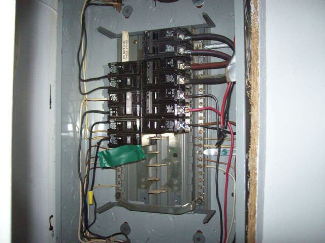

CoolSigns Posted June 29, 2011 Author Report Share Posted June 29, 2011 Click to Enlarge 48.81 KB There is a seperate 20amp ac breaker box outside, with a pull out fuse. Yes the infrared did give me a scare seeing the breaker and wire showing hot....I'm still concerned... Link to comment Share on other sites More sharing options...
Jim Katen Posted June 29, 2011 Report Share Posted June 29, 2011 There is a seperate 20amp ac breaker box outside, with a pull out fuse. That's the line-of-sight disconnect. There should be a breaker in the service panel that cuts power to it. I vote for the two pole breaker at the middle left side of the panel. Was it labeled AC? Yes the infrared did give me a scare seeing the breaker and wire showing hot....I'm still concerned... When the IR camera is auto ranging it makes perfectly normal things look scary. Does it help to realize that your hand is hotter than the hottest thing in that image? Link to comment Share on other sites More sharing options...
Ben H Posted June 29, 2011 Report Share Posted June 29, 2011 Jim is spot on. The temp of your wire in that pic is less than the highest point (which is white & 86.4 F) The other breakers aren't "lit" up in the pic because they aren't under a load. In fact at that temp, the "hot" breaker would likely feel cool to the touch. Link to comment Share on other sites More sharing options...

Tom Raymond Posted June 29, 2011 Report Share Posted June 29, 2011 You new I7 should have come with a book. Read it. Scan something that you understand and match what you see in the image to what you know about the scanned item. Lather, rinse, repeat. By misunderstanding the range in that image, you scared yourself and your client. IR is a cool tool, but isn't worth a hill of beans unless you know how to use it. Nice job on the matching visible spectrum pic, when I get excited about an IR image I often forget to take those. Link to comment Share on other sites More sharing options...
CoolSigns Posted June 29, 2011 Author Report Share Posted June 29, 2011 Ok... I can agree on the service breaker outside...I can agree with the temp being within normal...I can also agree that the 2 pole breaker middle left is for ac...I can accept the liquid answer...I agree the breaker was under a load... Facts: There were no labels for any breakers. The Hot 20 amp breaker was Not hot to the touch, felt like all the rest. There is a dripping liquid on the wire. There is a black and red wire terminating in the panel box with electrical tape on the ends(on the lower right). There are two black wires connected with a yellow wire nut(on the left). One 100 amp main disconnect in the box. Noticed no GFIC,s on the exterior or in kitchen and laundry before opening the main box. Infrared did confirm breaker and wire to be hotter than others. Shut off the 20 amp did stop the power on ac, kitchen, laundry room, fridge. House built in the mid 60's. Outside temp 88 and sunny. The facts above contributed to my opinion there is a problem of overloading on that circuit at the time of my inspection. Resulting in my recommendation an electrician be called in. My question/concern is why did the 20 amp shut the power off to the ac? Link to comment Share on other sites More sharing options...

Jim Port Posted June 29, 2011 Report Share Posted June 29, 2011 Facts:There were no labels for any breakers. The Hot 20 amp breaker was Not hot to the touch, felt like all the rest. There is a dripping liquid on the wire. There is a black and red wire terminating in the panel box with electrical tape on the ends(on the lower right). Looks like they are not in use and taped to prevent accidental contact. could be abandoned. There are two black wires connected with a yellow wire nut(on the left).Allowed, and commonly needed when panel is changed. One 100 amp main disconnect in the box. Noticed no GFIC,s on the exterior or in kitchen and laundry before opening the main box. You said the house was built in the 60s. This pre-dates GFI requirements. Infrared did confirm breaker and wire to be hotter than others. Shut off the 20 amp did stop the power on ac, kitchen, laundry room, fridge. House built in the mid 60's. Comments in blue by me. Link to comment Share on other sites More sharing options...

caryseidner Posted June 29, 2011 Report Share Posted June 29, 2011 That liquid might be the oil that sparky uses to help pull the wires through the conduit. I've seen it many times and rubbed it between my fingers to confirm it. Link to comment Share on other sites More sharing options...

John Dirks Jr Posted June 30, 2011 Report Share Posted June 30, 2011 CoolSigns, Where did you get the new I7 for $1695? Not refurbished? One thing to remember when using the I7. IR cams see surface temp, not moisture. Even without a change in moisture content, the image of a ceiling or wall can change significantly based on the time of the day the picture is taken. Keep participating here. This is one of the best places to learn. Don't be shy as its better to make a mistake here than out there. Make sure you can back up whatever you report. Link to comment Share on other sites More sharing options...
Jim Katen Posted June 30, 2011 Report Share Posted June 30, 2011 CoolSigns, Here's more than you ever wanted to know about the liquid. (Found on the net.) Attributed to NICEIC: "Green goo is a phenomena sometimes encountered in electrical installations constructed in the late 1960s. Unsightly green slime can occur in switch and socket-outlet boxes. It is understood that this phenomenon is most prevalent where pvc cables manufactured between 1965 and 1971 have been used. The green slime, or green goo, is degraded di-isoctyl phthalate and is considered to result from a chemical reaction between the plasticizer of the insulation and the copper conductor in the pvc cable. Between 1965 and 1971 the temperature performance of pvc was uprated by the inclusion of an anti-oxidant into the pvc compound. An unappreciated side effect was that the anti-oxidant encouraged production of the exudate. There is evidence to suggest that high ambient temperatures accelerate the process. The exudate is of low flammability and low toxicity. Although unsightly, it does not reduce the electrical integrity of the conductor or the insulation. However, the exudate may have detrimental effects on both accessories (in appearance and functionality terms) and their surrounding decorative finishes." Attributed to IEE:- "It is most prevalent in cables made between 1965 and 1971. The gunge is degraded di-isoctyl phthalate and is the result of the reaction between the plasticiser in the insulation and the copper. Between 1965 and 1971 the temperature performance of PVC was uprated by the inclusion of an anti-oxidant in to the PVC. An unappreciated side effect was that the anti-oxidant encouraged the production of exudate. Evidence suggests that high ambient temperatures accelerate the process. The exudate is of low flammability and low toxicity. Although unsightly it does not reduce the electrical integrity of the conductor or the insulation. Green exudate from PVC Draft BCA statement (April 2001) 1) PVC PVC comes in two main grades, plasticised and unplasticised PVC. Unplasticised PVC (UPVC) is used for example in double glazing window frames where a rigid material is required. The PVC used for manufacture of cables is a plasticised PVC that conforms to the relevant British Standard for the cable type in question. 2) Ageing effects As a cable ages; (at temperatures above normal ambient), the elongation to break decreases (also the Insulation Resistance increases). The life expectancy of a cable is arbitrarily considered to be when the elongation to break of the PVC is 50%. A lower elongation to break value could be considered suitable especially for a fixed wiring cable. Therefore, providing the cable is not subject to movement or when moved due to inspection of socket outlet or the like, the PVC does not crack, a much lower value of elongation to break is considered by some as suitable. 3) Greening Greening is the appearance of a wet green substance that is a product of an adverse reaction between certain types of plasticiser and the copper conductors. This greening, which is a rare occurrence, can happen either after a long period of time for some cables, or if the cable has been severely overheated. The plasticiser itself is a clear oily liquid that is non conductive. The green substance is a combination of copper oxide and plasticiser which may become conductive under certain adverse conditions. 4) Action if Greening is found Therefore whenever this green substance is found at socket outlets etc. initially it should be removed and the terminations cleaned (gloves should be used) otherwise it is possible that tracking/overheating may occur. It is strongly recommended that rewiring should be carried out as soon as possible." Link to comment Share on other sites More sharing options...
Erby Posted June 30, 2011 Report Share Posted June 30, 2011 Sounds like your post is full of conflicting exudate to me! NICEIC & IEE say it's okay,don't replace. BCA says: rewiring should be carried out as soon as possible. Link to comment Share on other sites More sharing options...
