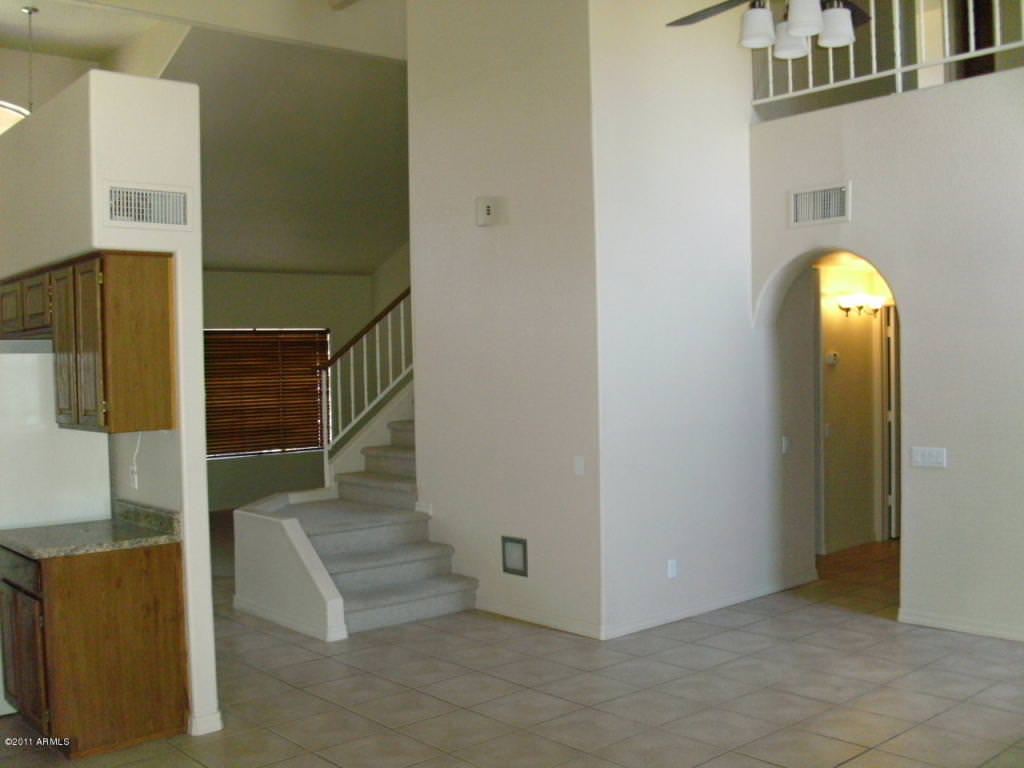

JEuriech Posted August 27, 2011 Report Share Posted August 27, 2011 I will be inspecting this house on Monday. I assume that no hand rail is required on the first flight of steps due to it not having four or more risers in height? Is it also safe to assume that no guard rails are required on the landing if it is not more than 30" high? It looks kind of strange? Jeff Euriech Peoria Arizona Download Attachment: Landing.jpg 61.63 KB Download Attachment: Landing B.jpg 60.71 KB Quote Link to comment Share on other sites More sharing options...

Brandon Whitmore Posted August 27, 2011 Report Share Posted August 27, 2011 A handrail is required all of the way down because there is no proper landing at that lower section from what I can see. The outer corner of the "landing" is cut off. I would recommend a guard as well, because if someone trips at just before hitting that "landing", they could have a pretty good fall. Quote Link to comment Share on other sites More sharing options...

SNations Posted September 1, 2011 Report Share Posted September 1, 2011 I agree with Brandon. The landing does not meet the requirements of IRC 311.7.5 because the "landing" does not have the same width as the stairway for 36 inches. So I'd say you could make a very good argument that a handrail is required all the way down. R311.7.5 Landings for stairways. There shall be a floor or landing at the top and bottom of each stairway. A flight of stairs shall not have a vertical rise larger than 12 feet (3658 mm) between floor levels or landings. The width of each landing shall not be less than the width of the stairway served. Every landing shall have a minimum dimension of 36 inches (914 mm) measured in the direction of travel. Quote Link to comment Share on other sites More sharing options...
Brandon Whitmore Posted September 1, 2011 Report Share Posted September 1, 2011 I agree with Brandon. The landing does not meet the requirements of IRC 311.7.5 because the "landing" does not have the same width as the stairway for 36 inches. So I'd say you could make a very good argument that a handrail is required all the way down. Also, if that's not a landing, the stairs are built wrong. The tread depth varies excessively... Quote Link to comment Share on other sites More sharing options...
