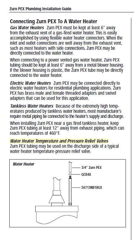

Denray Posted November 10, 2011 Report Share Posted November 10, 2011 About 2 feet away from the on damand wh the copper turned to Pex. No markings on it here where it was being used for the TPR line. Is it ok for the TPR line? What may have been the same line down in the crawl looks like it says 130 psi. Click to Enlarge 53.65?KB Click to Enlarge 56.24?KB Quote Link to comment Share on other sites More sharing options...
patt Posted November 10, 2011 Report Share Posted November 10, 2011 I know of one brand that states it can be used for the TPR drain. See page 23 of manual; http://www.zurn.com/images/pdf/zpm07199.pdf Download Attachment: ZURN TPR.JPG 107.26 KB Quote Link to comment Share on other sites More sharing options...

patt Posted November 11, 2011 Report Share Posted November 11, 2011 I would probably still check with your local authority, the interesting part of the verbiage in the CPC is "listed relief valve drain tube" and in the Zurn ICC-ES Listing PMG 1039 they don't specifically list it for relief valve drainage. 2010 CA Plumbing Code 608.5 Relief valves located inside a building shall be provided with a drain, not smaller than the relief valve outlet, of galvanized steel, hard-drawn copper piping and fittings, CPVC or listed relief valve drain tube with fittings that will not reduce the internal bore of the pipe or tubing (straight lengths as opposed to coils) and shall extend from the valve to the outside of the building, with the end of the pipe not more than two (2) feet (610 mm) nor less than six (6) inches (152 mm) above ground or the flood level of the area receiving the discharge and pointing downward. Such drains shall be permitted to terminate at other approved locations. Relief valve drains shall not terminate in a building's crawl space. No part of such drain pipe shall be trapped or subject to freezing. The terminal end of the drain pipe shall not be threaded. Download Attachment: ZURN PMG-1039.pdf 49.11?KB Quote Link to comment Share on other sites More sharing options...
Jim Katen Posted November 11, 2011 Report Share Posted November 11, 2011 I can't speak to Cali's codes. But PEX works just fine as long as it has the correct inside diameter. It will never see anything close to 130 psi. Quote Link to comment Share on other sites More sharing options...
Kyle Kubs Posted November 11, 2011 Report Share Posted November 11, 2011 Just need to watch out for the fitting they use to attach it. Many of the fittings have a reduced orifice compared to the tubing. The one in your picture doesn't look like it does. I agree, it will never see that pressure, but worth noting, the pressure rating is usually given at a particular temperature and falls dramatically above that temperature. Quote Link to comment Share on other sites More sharing options...
