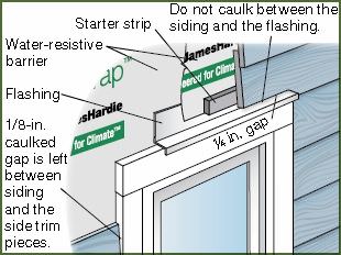

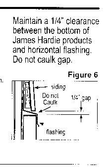

hausdok Posted February 28, 2013 Report Share Posted February 28, 2013 He also mentioned band trim flashings. It's really common around here for builders to install 2 by 10 bandboards around the base of the wall and over the rim between floors and install Z-flashings over the top of the bandboards before applying the cladding. The first illustration below is taken from the Hardiplank instructions. It depicts how they want flashings installed above horizontal trim or above doors or windows. Click to Enlarge 18.7?KB The second illustration is from Build a Better House - a series of handouts provided for free on the Engineered Wood Association's website. Click to Enlarge 31.14 KB The third shows a head flashing installation taken from the James Hardie Best Practices - Installation manual. This is not actually a J.H. illustration. These were illustrations they borrowed with permission from the Journal of Light Construction. Click to Enlarge 25.42 KB ONE TEAM - ONE FIGHT!!! Mike Quote Link to comment Share on other sites More sharing options...
