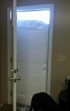

Marc Posted November 25, 2014 Report Share Posted November 25, 2014 Can someone point me in the direction of an IRC citation that requires at least one exterior door to swing outside instead of inside? I looked at R311.4 but it doesn't say 'outswing'. Thanks. Marc Quote Link to comment Share on other sites More sharing options...
Erby Posted November 25, 2014 Report Share Posted November 25, 2014 Wasn't aware that the IRC required such. Seldom see it around here in Kentucky! Quote Link to comment Share on other sites More sharing options...
Bill Kibbel Posted November 25, 2014 Report Share Posted November 25, 2014 I don't know of any residential code requiring an outswing door. How would you open it when there's a 6' snow drift against it? Click to Enlarge 15.13 KB Quote Link to comment Share on other sites More sharing options...

Steven Hockstein Posted November 26, 2014 Report Share Posted November 26, 2014 Bill is right. We do not design homes with outswing exterior doors where there can be snow. There are some exceptions (i.e. at a covered porch), but they are rare. Quote Link to comment Share on other sites More sharing options...

Steven Hockstein Posted November 28, 2014 Report Share Posted November 28, 2014 Bill is right. We do not design homes with outswing exterior doors where there can be snow. There are some exceptions (i.e. at a covered porch), but they are rare. Then what about storm doors? They always swing outward and they are ubiquitous here in eastern PA, where we get a lot of snow. I have no control over what people add to their homes. I just said that we do not design homes with outswing exterior doors in areas where snow can block exiting. I often see storm doors too. Does not make it a good idea, but it is permitted. R311 in the IRC 2009 (NJ Edition) is the code reference that was originally requested in the beginning of this thread. Read IRC 311.3.1 that references direction of door swing and step-down. The problem is when there is not a step-down, and no roof over the entryway, the door can easily be blocked by snow. Quote Link to comment Share on other sites More sharing options...
