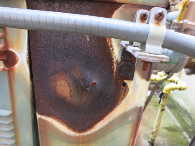

MPdesign Posted February 19, 2015 Report Share Posted February 19, 2015 I saw this just 2 days ago and was very worried. It was an outdoor boiler. The flame was just behind the metal in the photo and the flex was attached on the right side right behind the conduit strap shown. I was extremely worried that the connection could deform as easily as the sheet metal - or that the flex sidewall would not have the strength of the surrounding area. It is just by chance that I am reading this a few days later. Click to Enlarge 48.18 KB Quote Link to comment Share on other sites More sharing options...
