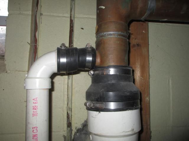

Tom Breslawski Posted March 4, 2017 Report Share Posted March 4, 2017 Received an email from a client today; I called out this rubber Fernco connector (on the elbow) for being subject to failure (especially since the PVC is clearly cut too short). It runs from the laundry basin, through a Liberty pump and to the soil stack at the right. The plumber who installed it said; "it is a Fernco coupling that is widely accepted by plumbing contractors and municipalities, leak proof, rot proof, chemical and UV resistant, etc. Contact me with any additional concerns." Then he included a link to the Fernco website. I also received a message that he said "everyone does it this way and its legal and up to code. He has been doing plumbing for 30+ plus years and never had one fail". I didn't think that these type of connectors were "legal and up to code" and I'm kind of surprised that a plumber would defend this kind of work. Are they up to code? Click to Enlarge 36.17 KB Quote Link to comment Share on other sites More sharing options...
Jim Katen Posted March 4, 2017 Report Share Posted March 4, 2017 They're allowed in my area. We're on the UPC and 705.1.6 seems to say that they're allowed. The only question I'd have is whether or not attaching it to the hub of the elbow is appropriate. Honestly, though, if I saw that during an inspection and it wasn't leaking and it looked and felt secure, I'd just keep going without even making a note. Quote Link to comment Share on other sites More sharing options...
John Kogel Posted March 4, 2017 Report Share Posted March 4, 2017 I agree with Jim, that is a non-issue. In an old basement, you will see improvised hookups, especially matching metal to PVC. Fernco connectors are a standard way to make those transitions. There are some Ferncos that have metal mesh outer jackets, but those are straight coupling, no reduction in size. In new construction, they are used to connect cast iron pipe, such as in condos where plastic is not allowed, fire codes. That is drains only, not water lines under pressure. Quote Link to comment Share on other sites More sharing options...
Tom Breslawski Posted March 4, 2017 Author Report Share Posted March 4, 2017 Hummm. Getting shot down here, lol. Thank you guys. My other concern with this one was the elbow fitting being installed on the hub (as Jim K mentioned) and the fitting being bent to compensate for the discharge pipe being cut too short. So other than that, it looks like the plumber was right. I had always understood it that the stainless steel Fernco fittings were the only ones that were acceptable. Thanks for the info, I appreciate it! Quote Link to comment Share on other sites More sharing options...
Tom Corrigan Posted March 5, 2017 Report Share Posted March 5, 2017 Hi Tom, Rubber fittings are not permitted(Table P3002.3). The fitting also reduces the diameter as the diameter was increased at hub. Also don't forget that NYS does not license plumbers. Any license the guy claims to have is a municipal contractor license. Tell your client to request an opinion from the municipal code inspector. He or she is the AHJ not the guy that did it wrong for 30 years. I can't wait till Chad chimes in! Tom Corrigan Quote Link to comment Share on other sites More sharing options...
Tom Breslawski Posted March 5, 2017 Author Report Share Posted March 5, 2017 Thanks for the info Tom! I've been searching the plumbing code and couldn't find these rubber fittings anywhere. Figured I was missing something. Haven't contacted my client or the plumber yet. Still taking in info and formulating my response. I'm going to hold off until Monday and make sure to get Chad's opinion before I respond. Hi Tom, Rubber fittings are not permitted(Table P3002.3). The fitting also reduces the diameter as the diameter was increased at hub. Also don't forget that NYS does not license plumbers. Any license the guy claims to have is a municipal contractor license. Tell your client to request an opinion from the municipal code inspector. He or she is the AHJ not the guy that did it wrong for 30 years. I can't wait till Chad chimes in! Tom Corrigan Quote Link to comment Share on other sites More sharing options...
Charlie R Posted March 5, 2017 Report Share Posted March 5, 2017 Fernco fittings are UPC approved and marked as such for use on drainage systems, are not made of rubber but elastomeric polyvinylchloride, and meet the ASTM standard C564 (https://www.fernco.com/sites/default/fi ... mittal.pdf) as called for in the 2012 IRC section P3003.6.3. However, make sure to look for the UPC code on the label, there are some imitations showing up that are not approved. The workmanship of the installation is another question though. Quote Link to comment Share on other sites More sharing options...

Chad Fabry Posted March 6, 2017 Report Share Posted March 6, 2017 In the strictest sense, the installation isn't compliant because as others have pointed out, the Fernco isn't designed to go over the hub, there is a reduction in diameter in the direction of flow, it isn't listed as a connection method,the connector is designed for gravity systems with a maximum pressure rating of around 4 psi. Clearly, a *plumber* isn't responsible for the installation. The photo doesn't include backflow prevention or venting- was there any? Fernco's website states that many municipalities and AHJ's accept these connectors but they do not go so far as to say they're code compliant. As Jim said, there are usually bigger fish to fry, but if the issue exemplified fubar plumbing throughout, it'd make the report. Quote Link to comment Share on other sites More sharing options...
Tom Breslawski Posted March 6, 2017 Author Report Share Posted March 6, 2017 Thanks Chad. There was no venting or backflow prevention on this installation either. I was surprised that a "plumber" would take credit for it and defend it. In the strictest sense, the installation isn't compliant because as others have pointed out, the Fernco isn't designed to go over the hub, there is a reduction in diameter in the direction of flow, it isn't listed as a connection method,the connector is designed for gravity systems with a maximum pressure rating of around 4 psi. Clearly, a *plumber* isn't responsible for the installation. The photo doesn't include backflow prevention or venting- was there any? Fernco's website states that many municipalities and AHJ's accept these connectors but they do not go so far as to say they're code compliant. As Jim said, there are usually bigger fish to fry, but if the issue exemplified fubar plumbing throughout, it'd make the report. Quote Link to comment Share on other sites More sharing options...
mjr6550 Posted March 6, 2017 Report Share Posted March 6, 2017 Not great workmship, but does not look like much of a problem. I would also question (and probably note) the use of the connector on the hub of the elbow. The link below indicates they are approved for use on plain-end pipe. One ASTM standard applies to underground installation. The report says above ground use is subject to approval by the AHJ. http://www.icc-es-pmg.org/Listing_Direc ... 1117.pdfan Quote Link to comment Share on other sites More sharing options...
Charlie R Posted March 6, 2017 Report Share Posted March 6, 2017 The op wrote that he called out "the rubber Fernco fitting (on the elbow)" and I was pointing out that the Fernco is not rubber, it is a flexible PVC ( elastomeric polyvinylchloride), bears the UPC stamp of approval - it is on the label, and is allowed by the aforementioned table of materials and subsequent paragraphs. The plumber in this case is correct in the choice of materials. The workmanship is the issue, not the material. Quote Link to comment Share on other sites More sharing options...

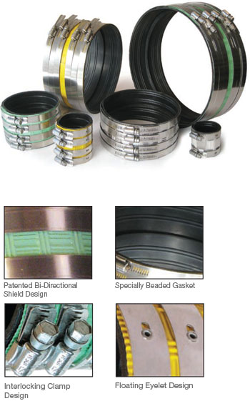

Plummen2 Posted December 31, 2017 Report Share Posted December 31, 2017 On 3/5/2017 at 10:10 AM, Jim Baird said: My plumber friend calls those "no-hub" connectors, for making difficult connections between old cast iron and new PVC DWV pipes. Those are not no-hub couplings,They'e fernco. These are no hub couplings. Quote Link to comment Share on other sites More sharing options...
Bill Kibbel Posted December 31, 2017 Report Share Posted December 31, 2017 Fernco is the name of a manufacturer, not a specific fitting. Fernco also manufactures the shielded couplings in your pictures as well as many other products. Quote Link to comment Share on other sites More sharing options...
Plummen2 Posted January 1, 2018 Report Share Posted January 1, 2018 Yes they do,but the ones without the metal shielding under the band's are not no-hub couplings. Quote Link to comment Share on other sites More sharing options...
