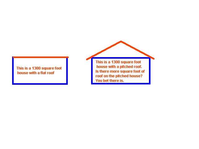

charlieb Posted September 26, 2006 Report Share Posted September 26, 2006 Start raising the pitch and the roof square footage goes up as does the amount of the water.id="blue"> Why do you think the volume of the rain increases? I could see an increase on the plane facing the rain but the backside would recieve less. Would it not? Quote Link to comment Share on other sites More sharing options...
Chad Fabry Posted September 26, 2006 Report Share Posted September 26, 2006 More area ( steeper pitch) does not equal more water collected. Only the footprint protected by the roof counts as an area of collection. Quote Link to comment Share on other sites More sharing options...

Erby Posted September 27, 2006 Report Share Posted September 27, 2006 Well now, I still think it does. Remember we're talking a simple two slope roof, front and back. Rain is measured by the cubic inch. If you have a square inch tube and it fills up with two inches of rain, the weather guy says we have had two inches of rain. Let's take one slope and lay it down flat. Cover it with square inch glass tubes hinged at the bottom to pivot so they are always pointing straight up. Now raise one end. The tubes pivot slightly to stay vertical but I don't think any of those square inches disappear??? Do they??? Hell, I don't know. It makes my head hurt just to think about such anal retentive stuff. Quote Link to comment Share on other sites More sharing options...
Jesse Posted September 27, 2006 Report Share Posted September 27, 2006 Chad's right on. Footprint matters. Imagine looking at the roof from above, like on google's satelite views. That's what the cloud sees. Steeper roof sheds the water faster, but collects no more. Quote Link to comment Share on other sites More sharing options...
Erby Posted September 27, 2006 Report Share Posted September 27, 2006 Well, I've told you my story and I'm sticking to it. None of those glass tubes disappear, they just pivot to stay vertical. Well, unless you get really steep, but not on a 4/12 pitch. Quote Link to comment Share on other sites More sharing options...

Erby Posted September 28, 2006 Report Share Posted September 28, 2006 For CharlieB, Chad, Jesse & Charlie: See photo. Download Attachment: flatpitch.jpg 58.39 KB Kurt. I googled and googled, but I couldn't find any of them funky tilting square inch tubes. You're on your own. Quote Link to comment Share on other sites More sharing options...
Bain Posted September 28, 2006 Report Share Posted September 28, 2006 RE Erby's diagram, there's more square footage of roof, but the volume of rainfall per square foot is going to be diminished. The amount of rain falling on a 12" x 12" patch of earth is finite during however long the measuring period is. If it's a gallon of water per square foot, the slope of a roof is moot. Sure, the pitch creates more roof area that becomes wet, and it also accelerates the velocity of the rain's descent onto the ground, but the volume of water will not change. If I drop a gallon of water on the 12" x 12" square, regardless of the angles it encounters on its way down, the amount of water still equals one gallon. Quote Link to comment Share on other sites More sharing options...
Jim Katen Posted September 28, 2006 Report Share Posted September 28, 2006 Originally posted by Bain RE Erby's diagram, there's more square footage of roof, but the volume of rainfall per square foot is going to be diminished. The amount of rain falling on a 12" x 12" patch of earth is finite during however long the measuring period is. If it's a gallon of water per square foot, the slope of a roof is moot. Sure, the pitch creates more roof area that becomes wet, and it also accelerates the velocity of the rain's descent onto the ground, but the volume of water will not change. If I drop a gallon of water on the 12" x 12" square, regardless of the angles it encounters on its way down, the amount of water still equals one gallon. Erby, John's explained it very well above. Surely you don't believe that more rain falls on a roof as its slope increases? - Jim Katen, Oregon Quote Link to comment Share on other sites More sharing options...
Bill Kibbel Posted September 28, 2006 Report Share Posted September 28, 2006 Erby, I altered your diagram to help illustrate what others are trying to explain. Hope this helps. http://uploads/inspecthistoric/2006927193831_erbyrain.JPG%20 Quote Link to comment Share on other sites More sharing options...
