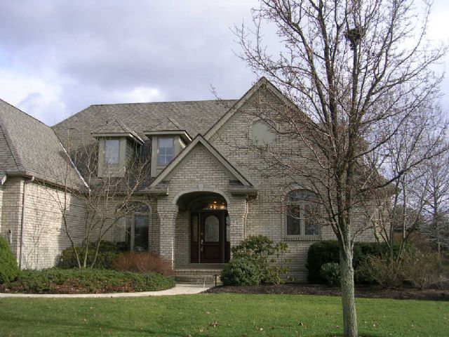

Terence McCann Posted January 9, 2007 Report Share Posted January 9, 2007 The rafters are longer than the ridge board as shown in the picture. Are there any long term conditions that one should worry about with this? TIA Download Attachment: Attic.jpg 137.03 KB Download Attachment: Home.jpg 184.38 KB Quote Link to comment Share on other sites More sharing options...
chrisprickett Posted January 9, 2007 Report Share Posted January 9, 2007 Code violation? Definitely. Future problem? Who Knows? Fix? Pretty simple. Just slip another 2x under that ridge board and secure with some appropriate hangers. Quote Link to comment Share on other sites More sharing options...

MMustola Posted January 9, 2007 Report Share Posted January 9, 2007 If they are not supported properly they may crack over time. Quote Link to comment Share on other sites More sharing options...
rjw Posted January 9, 2007 Report Share Posted January 9, 2007 Originally posted by MMustola If they are not supported properly they may crack over time. FWIW, I see that configuration commoly in older houses in my area and don't believe I've ever seen a rafter spliting (at least obvioulsy) because of it. Quote Link to comment Share on other sites More sharing options...
hausdok Posted January 9, 2007 Report Share Posted January 9, 2007 Hi, I see it on older homes a lot too. Around here, it's common to find a piece of 1 by 4 tongue-and-groove planking used for the ridge board with the heels off the board. Most of those old houses have 2 by 4 rafters spanning more than 16 ft. that are overloaded with several layers of roofing and sagging more than my gut in the center. I've found maybe, if memory serves, 3 rafters that have split out at the end because of this. Doesn't make it OK, I know, but I wouldn't expect to see a roof collapse because of it......ever. Could be wrong, have been many times, still.... ONE TEAM - ONE FIGHT!!! Mike Quote Link to comment Share on other sites More sharing options...
Nolan Kienitz Posted January 10, 2007 Report Share Posted January 10, 2007 Download Attachment: Home.jpg 184.38 KB Could be distance and/or camera angle, but are there lifted shingles at top left and middle left of roof? Has nothing to do with rafters! Comment above ... adding 2x resolves ridge beam/rafter issue all the time. Quote Link to comment Share on other sites More sharing options...
MMustola Posted January 10, 2007 Report Share Posted January 10, 2007 I believe the intent of the code is to give full support to the butt end of the rafter. I agree that is is not common to see cracks. Also, it's not a fair comparsion to judge want may happen with today's wood by looking at old houses with old growth wood. If you have to tell a client why the ridge board needs to be repaired I think explaining that the rafter may crack if not properly supported is an accruate statement. Do you disaggree? Quote Link to comment Share on other sites More sharing options...

Terence McCann Posted January 10, 2007 Author Report Share Posted January 10, 2007 Originally posted by Nolan Kienitz Download Attachment: Home.jpg 184.38 KB Could be distance and/or camera angle, but are there lifted shingles at top left and middle left of roof? It's the translation from camera to downscaled quality jpg. Quote Link to comment Share on other sites More sharing options...
