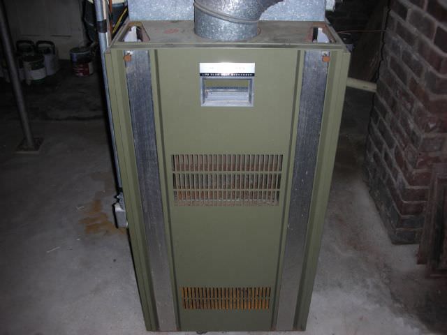

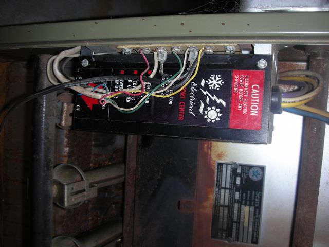

jakeb Posted August 11, 2011 Report Share Posted August 11, 2011 Click to Enlarge 38.22 KB Click to Enlarge 36.43 KB Click to Enlarge 46.95 KB Click to Enlarge 31.14 KB Quote Link to comment Share on other sites More sharing options...
Chad Fabry Posted August 11, 2011 Report Share Posted August 11, 2011 Looks like 1968 more than 1988 Quote Link to comment Share on other sites More sharing options...
hausdok Posted August 11, 2011 Report Share Posted August 11, 2011 I agree with Chad, it does look older than the eighties. Based on the corrosion, I'd say that humidifier has trashed that puppy. Better prepare the family for Grandpa's sudden demise, he isn't simply in the nursing home; he's on life support with 24-hour-a-day monitoring and a crash cart parked next to his bed and is liable to pass at any moment. Make sure you tell them that or don't be surprised when some cold night you get a call from the client bemoaning the fact that an HVAC guy just left the house and told them they need a new furnace now and couldn't figure out how their inspector hadn't told them that. ONE TEAM - ONE FIGHT!!! Mike Quote Link to comment Share on other sites More sharing options...
Jim Katen Posted August 11, 2011 Report Share Posted August 11, 2011 Well, it ain't 1988. Quote Link to comment Share on other sites More sharing options...
kurt Posted August 11, 2011 Report Share Posted August 11, 2011 It's old enough to tell folks it's really old and they ought to expect to replace it at anytime. Also, whenever I've dated a Sears furnace, I insist we go dutch. Quote Link to comment Share on other sites More sharing options...
Tom Raymond Posted August 11, 2011 Report Share Posted August 11, 2011 Uh, it's a Sears product. Even if it was from 88 it would be old enough to advise them that. If it is a 68, the poor bastard that bought it only has a couple of payments left on it. Quote Link to comment Share on other sites More sharing options...
Chad Fabry Posted August 11, 2011 Report Share Posted August 11, 2011 Uh, it's a Sears product. Even if it was from 88 it would be old enough to advise them that. If it is a 68, the poor bastard that bought it only has a couple of payments left on it. That's funny Quote Link to comment Share on other sites More sharing options...
jakeb Posted August 12, 2011 Report Share Posted August 12, 2011 lol, it's my furnace. the rust on the bottom is from when the A-coil drip pan was clogged and leaked inside the bottom of the furnace. lived in this house for 3 years, only problem i've ever had was the blower motor went out a couple of weeks ago. i know it needs replaced, hoping to get another 2-3 years though. where do you come up with 1968 from the serial #? Quote Link to comment Share on other sites More sharing options...
Jim Katen Posted August 12, 2011 Report Share Posted August 12, 2011 lol, it's my furnace. the rust on the bottom is from when the A-coil drip pan was clogged and leaked inside the bottom of the furnace. lived in this house for 3 years, only problem i've ever had was the blower motor went out a couple of weeks ago. i know it needs replaced, hoping to get another 2-3 years though. where do you come up with 1968 from the serial #? It's from the '60s, probably 1965. It might not be possible to verify that for certain at this point. It was a very basic machine with little to go wrong with it. The only reason to eventually discard it would be if the heat exchanger developed a crack or hole. Someone could determine that with a tracer gas test. In the meantime, get yourself a couple of good carbon monoxide alarms. Otherwise enjoy heating your house with a neat old furnace. Quote Link to comment Share on other sites More sharing options...
