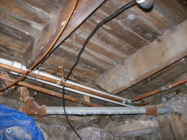

mridgeelk Posted March 12, 2008 Report Share Posted March 12, 2008 I found these cut joists today in a fairly recent remodel. It leads me to believe that the plumbing was not inspected or is it not the duty of the plumbing inspector to report this to the building inspector? Ed Image Insert: 310.61 KB Link to comment Share on other sites More sharing options...
AHI in AR Posted March 12, 2008 Report Share Posted March 12, 2008 Don't count on the plumbing inspector to tell ANYONE anything that doesn't relate DIRECTLY to plumbing deficiencies. Even if there were permits taken out, it isn't likely that the muni inspectors crawled up there under the home and looked at much of anything. If this is like a typical updating/ gentrification job of an older home which I see around here, there aren't permits pulled for any aspects of the job. Regardless of the status of permits and city inspections, it's wrong. Write it up. Link to comment Share on other sites More sharing options...
Brian G Posted March 12, 2008 Report Share Posted March 12, 2008 I'm just curious: has anyone here ever seen an AHJ crawl under a house? [?] Brian G. Not in the Job Description? [^] Link to comment Share on other sites More sharing options...
Chad Fabry Posted March 12, 2008 Report Share Posted March 12, 2008 Judging from the ugly solder work and the leaking tee it was a DIY job. Was the floor springy? Link to comment Share on other sites More sharing options...
chrisprickett Posted March 12, 2008 Report Share Posted March 12, 2008 Originally posted by Chad Fabry Judging from the ugly solder work and the leaking tee it was a DIY job. Not to mention the incompatible pipe hangers... Link to comment Share on other sites More sharing options...
jon_ran Posted March 12, 2008 Report Share Posted March 12, 2008 What is holding that floor up???????? By judging the appearance of the joists and sub-floor, I would say that that home is much older than the PVC drain pipe, and the cuts look fairly fresh. Not that plumbers are not responsible for actions such as that, but I would say that it was definately a DIY job. That means that it most likely was not inspected. As others have said, the plumbing inspectors job is to inspect the plumbing. He/she may have little or no knowledge about structural (or any other) issues. Link to comment Share on other sites More sharing options...
Jim Katen Posted March 12, 2008 Report Share Posted March 12, 2008 Originally posted by Brian G I'm just curious: has anyone here ever seen an AHJ crawl under a house? [?] Brian G. Not in the Job Description? [^] In the nearby town of McMinnville, there's a muni inspector who will go into the crawlspace, into the attic and on the roof if she feels that it's necessary. - Jim Katen, Oregon Link to comment Share on other sites More sharing options...
Brian G Posted March 12, 2008 Report Share Posted March 12, 2008 Originally posted by Jim Katen In the nearby town of McMinnville, there's a muni inspector who will go into the crawlspace, into the attic and on the roof if she feels that it's necessary. Good for her. [:-thumbu] However, something tells me our jobs are in no danger from uncompromising AHJ's. Brian G. If They Were, We Wouldn't Be Here [:-magnify Link to comment Share on other sites More sharing options...
belvedere Posted March 12, 2008 Report Share Posted March 12, 2008 Originally posted by jon_ran What is holding that floor up???????? That was my first thought also! Link to comment Share on other sites More sharing options...
kurt Posted March 13, 2008 Report Share Posted March 13, 2008 Originally posted by jon_ran What is holding that floor up???????? The subfloor. If those boards are tongue and groove, that's a mighty strong, albeit springy, assembly. Even if they aren't T&G, they're going to bridge to the solid joists. It's total crapwork, but I see stuff like this a hundred times a year in old houses throughout the City. It just needs fixing. Also, I love it when plumbers do this stuff. It gives me ammunition for my nearly daily commentary on their general worthlessness as building trade professionals. Link to comment Share on other sites More sharing options...
