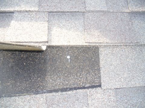

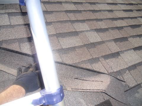

John Dirks Jr Posted January 17, 2012 Report Share Posted January 17, 2012 These shingles appear to be lifting due to being crowded or packed too tightly at the ends. Is this possible? What happened here? Sure looks like more than typical nail pops. Click to Enlarge 72.83 KB Click to Enlarge 49.12 KB Click to Enlarge 57.09 KB Click to Enlarge 55.92 KB Lots of spacing and flashing issues too. Click to Enlarge 45.59 KB Click to Enlarge 59.68 KB Click to Enlarge 83.15 KB Click to Enlarge 35.86 KB Click to Enlarge 42.08 KB Click to Enlarge 53.66 KB Link to comment Share on other sites More sharing options...
mgbinspect Posted January 17, 2012 Report Share Posted January 17, 2012 A lack of proper fastening can cause this. Many times when you see long lines of vertical or horizontal cracking, it is the result of excessive expansion and contraction permitted by either high nailing (which often doesn't catch the top edge of the lowest row of shingles), or not nailing according to the manufacturer's nailing pattern (typically using less fasteners). High nailing can be particularly devastating. When I was working with home owner's insurance claims departments, I often saw shingles that were prematurely destroyed by the excessive expansion and contraction resulting from improper or inadequate fastening. If you return to the property, I'll bet you can lift shingles to find no nail heads in locations that there should have been nails. Link to comment Share on other sites More sharing options...

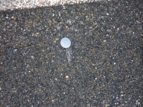

charlieb Posted January 17, 2012 Report Share Posted January 17, 2012 Photos of nailing defects from a recent inspection Click to Enlarge 31.04?KB Click to Enlarge 42.75?KB Click to Enlarge 43.92?KB Click to Enlarge 54.06?KB Nailing defects allow the shingles to slip and create the "bunched up" appearance. Click to Enlarge 40.39?KB Nailing defect will also cause a laminated shingle to come apart. Link to comment Share on other sites More sharing options...

John Kogel Posted January 17, 2012 Report Share Posted January 17, 2012 When the shingles are humped up, I slide my screwdriver under there and feel for a popped nail. No nail, then it's one of those other issues. Link to comment Share on other sites More sharing options...
