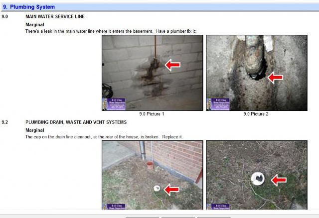

kurt Posted February 18, 2013 Report Share Posted February 18, 2013 I do not flatter myself by thinking I am a professional photographer. I do. I'm a professional photojournalist documenting the condition of my subject. I think like a photographer nowadays; finding the best establishing and detail shots has gotten second nature. Every defect or comment has one or two photos. My comments are really short; sometimes as simple as "the front windows are rotten right here", with a red arrow pointing at the defect. The Mac operating system has built in dictation that's damn near perfect; I barely type anything in an inspection report anymore (and I type 110wpm). When there's some complicated thing that needs explanation, I pull it out of my Comment Library. My inspection time has remained about the same, report generation time has dropped in half. I designed and built the software that allows me to do this in FM Pro; it's hilariously simple and fast with the dictation feature & drag and drop picture selection. No one currently established in the HI biz will ever believe that the world has changed and people like pictures more than reading lots of single spaced narrative. Claiming high ground with the argument "everyone likes my report" was debunked years ago by Cramer who astutely declared "everyone likes anything you give them because they don't know any better". If one does actual comparison research with real people, they will find out pictures win, every time. People want pictures and simplicity. Katen's the only other person I know that's conducted anything resembling research. He came to the same conclusion. Folks like pictures. And summaries. Quote Link to comment Share on other sites More sharing options...

Erby Posted February 19, 2013 Report Share Posted February 19, 2013 Might want to check your spelling of refrigerator, John. I did my research by reading here what Katen's and a couple of other peoples opinion were, asking a couple of my customers, and my own personal desire to type less bullshit. LOTS of photos. Some just show condition at time of inspection. I don't comment, just drag and drop those. Like Kurt, "finding the best establishing and detail shots has gotten second nature." Click to Enlarge 47.48 KB Quote Link to comment Share on other sites More sharing options...
kurt Posted February 19, 2013 Report Share Posted February 19, 2013 That's exactly what I'm talking about. Quote Link to comment Share on other sites More sharing options...
Mike Lamb Posted February 19, 2013 Report Share Posted February 19, 2013 There should be an HI photography class which would basically be telling HI's to take one wide establishing shot of the problem, and then a close up. Pretty simple. Use arrows for fluff. If they tell a real story, photos rule. Quote Link to comment Share on other sites More sharing options...

Marc Posted February 19, 2013 Report Share Posted February 19, 2013 Might want to check your spelling of refrigerator, John. I did my research by reading here what Katen's and a couple of other peoples opinion were, asking a couple of my customers, and my own personal desire to type less bullshit. LOTS of photos. Some just show condition at time of inspection. I don't comment, just drag and drop those. Like Kurt, "finding the best establishing and detail shots has gotten second nature." Click to Enlarge 47.48?KB This is what I was suggesting, John. Write like you were talking. Marc Quote Link to comment Share on other sites More sharing options...
