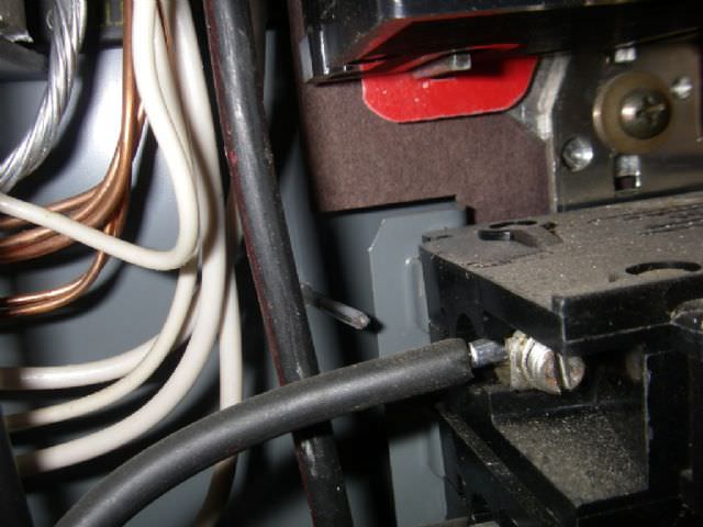

Stefan McGuire Posted February 15, 2014 Report Share Posted February 15, 2014 It looks like when the siding was replaced they shot some siding nails through the backside of the panel. It seems like if the nails would've hit anything energized there would be an obvious problem... Any suggestions on how you would react to this or what you might say to the buyer(s)??? Click to Enlarge 50.16 KB Click to Enlarge 28.26 KB Quote Link to comment Share on other sites More sharing options...
Mark P Posted February 15, 2014 Report Share Posted February 15, 2014 I would write something like this.. "It looks like when the siding was replaced they shot some siding nails through the backside of the electrical panel. The nails need to be removed - which will entail removing some of the siding. I recommend an electrician pull the panel to see if there is any hidden damage / nails behind the breakers and make a determination on if the panel needs to be replaced or can stay in service." You might also contact the manufacturer of the panel to get their take on it. It also looks like you have some single strnd AL wire that needs to be reported..... Quote Link to comment Share on other sites More sharing options...
Marc Posted February 15, 2014 Report Share Posted February 15, 2014 Several long siding nails have punctured the enclosure which contains the main electrical panel board. Those nails go all the way from the outside of the house to the inside where many exposed energized surfaces are present. Water and moisture could eventually seep inside, something the manufacturer never intended. It could cause corrosion as well as present a puncture hazard and a serious electrocution hazard to persons working on the panel since blood conducts electricity very well. An electrician should remove the errant nails after which you should seal the holes in the sheathing, restore the integrity of the WRB and fix the siding. Marc Quote Link to comment Share on other sites More sharing options...

John Kogel Posted February 15, 2014 Report Share Posted February 15, 2014 I see only stranded Al, could be wrong. The nails can be zipped off on the inside and then sealed with electrician's putty. But for my client, I would ask for the panel box to be pulled out and replaced. They can reuse the busbars and breakers, so it's $100 in materials. Quote Link to comment Share on other sites More sharing options...

Jim Katen Posted February 16, 2014 Report Share Posted February 16, 2014 It looks like when the siding was replaced they shot some siding nails through the backside of the panel. It seems like if the nails would've hit anything energized there would be an obvious problem... Any suggestions on how you would react to this or what you might say to the buyer(s)??? Slap the siding contractor upside the head, nip off the nails so that they're flush with the back of the panel, and call it a day. Quote Link to comment Share on other sites More sharing options...

Speedy Petey Posted March 7, 2014 Report Share Posted March 7, 2014 The nails can be zipped off on the inside and then sealed with electrician's putty. But for my client, I would ask for the panel box to be pulled out and replaced. They can reuse the busbars and breakers, so it's $100 in materials. For real??? You'd call for replacing the panel??Unless something inside the panel was broken I'd laugh at a this suggestion if I were in the position. I don't think you can disagree since you already admitted that zipping off the nails is a perfectly acceptable solution, but for your client you'd try and get a new panel out of it for them. Oh, and it's not just "$100 in materials.". It's a whole new panel. WHERE in the world would you (conveniently) get an empty panel enclosure??? Quote Link to comment Share on other sites More sharing options...
