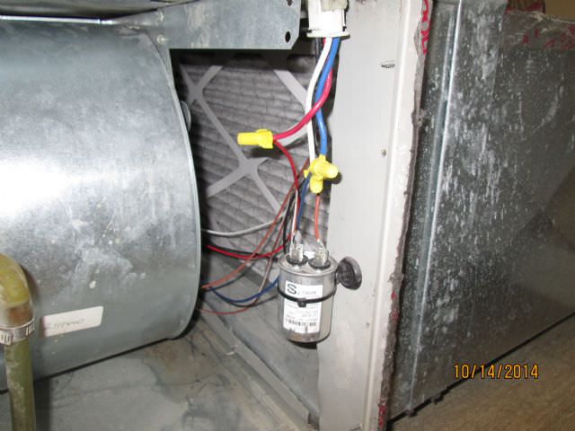

allseason Posted October 15, 2014 Report Share Posted October 15, 2014 Installed in a 2005 Nordyne furnace in the blower compartment. Capacitor looks like a manufacture date of 2010. Was it installed here as a replacement? Does not look like factory install due to the zip tie. My primary concern is the exposed connections to 120V. Click to Enlarge 53.01 KB Link to comment Share on other sites More sharing options...
John Dirks Jr Posted October 15, 2014 Report Share Posted October 15, 2014 There should be a safety switch on the blower compartment cover. When you remove the cover, power to the system should be cutoff. If so, there would not be risk of shock. Link to comment Share on other sites More sharing options...
Marc Posted October 15, 2014 Report Share Posted October 15, 2014 Never seen a Nordyne with an original capacitor installed that way, only with metal strapping. Yeah, it's a replacement. Marc Link to comment Share on other sites More sharing options...
Bill Kibbel Posted October 15, 2014 Report Share Posted October 15, 2014 The capacitor mounts to the side of the blower housing. Some techs leave the old one and strap in a new one where it's easy. John - the blower door switch opens the circuit, but doesn't discharge a capacitor! Link to comment Share on other sites More sharing options...

plummen Posted October 16, 2014 Report Share Posted October 16, 2014 There should be a safety switch on the blower compartment cover. When you remove the cover, power to the system should be cutoff. If so, there would not be risk of shock. The capacitor stores a charge of 370v normally until its discharged.Fan motor caps are normally oblong,not round. I always wrap the end of cap with tape to isolate the terminals. Link to comment Share on other sites More sharing options...
Marc Posted October 16, 2014 Report Share Posted October 16, 2014 There should be a safety switch on the blower compartment cover. When you remove the cover, power to the system should be cutoff. If so, there would not be risk of shock. The capacitor stores a charge of 370v normally until its discharged.Fan motor caps are normally oblong,not round. I always wrap the end of cap with tape to isolate the terminals. 'No' on both counts. The unit of charge is Coulomb. 370 volts is a common voltage rating for capacitors used in AC systems. Marc Link to comment Share on other sites More sharing options...
plummen Posted October 16, 2014 Report Share Posted October 16, 2014 There should be a safety switch on the blower compartment cover. When you remove the cover, power to the system should be cutoff. If so, there would not be risk of shock. The capacitor stores a charge of 370v normally until its discharged.Fan motor caps are normally oblong,not round. I always wrap the end of cap with tape to isolate the terminals. 'No' on both counts. The unit of charge is Coulomb. 370 volts is a common voltage rating for capacitors used in AC systems. Marc 370v is normal for furnace blower motor caps and condensing unit caps,some are actually 440v.they are rated by micro farads. that's where the 5/370-10/370 which is common on furnace blowers comes in to play. Condensing units used to separate capacitors back in the day,for example a 5/370 for fan motor and a 30/370 for compressor. Now they use a combination cap like a 5/30/370. Link to comment Share on other sites More sharing options...
