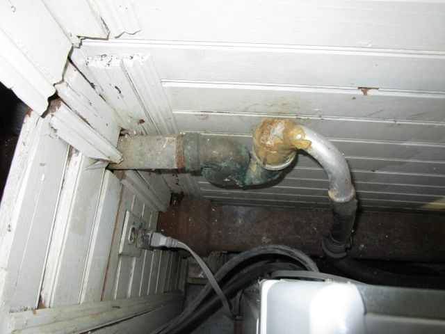

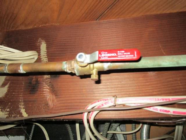

Steven Hockstein Posted December 23, 2014 Report Share Posted December 23, 2014 Seeing this a lot lately. The exterior is to the left side of the valve. Click to Enlarge 52.85 KB Quote Link to comment Share on other sites More sharing options...

John Kogel Posted December 23, 2014 Report Share Posted December 23, 2014 I see it. It is Bib in the thread title and Bob in the pic title. It is just an all-thumbs typo error. Yeah, I see that a lot, too. [] The old pipe on the right is tarnished from so many years in a damp environment. Yeah I see that quite a bit. [] Oh, you mean the backwards valve? He can winterize the house and have some water left in the bib for ice cubes. [] Steve, you are seeing this a lot? By the law of averages, it should only be 50% of the time. [] Quote Link to comment Share on other sites More sharing options...
Jim Baird Posted December 23, 2014 Report Share Posted December 23, 2014 ...bleeder on wrong side leads to repairs like the one seen on the left. Did the plumber not turn the valve around to guarantee a future call? Quote Link to comment Share on other sites More sharing options...
Steven Hockstein Posted December 23, 2014 Author Report Share Posted December 23, 2014 ...bleeder on wrong side leads to repairs like the one seen on the left. Did the plumber not turn the valve around to guarantee a future call? "Plumber"? I assume you mean the guy that owns a torch and a way to get to the big box store to buy the stuff so the valve can be installed wrong. Probably the same guy that did this: Click to Enlarge 44.29 KB Washer waste pipe Click to Enlarge 26.81 KB Discharge from the water conditioning equipment Quote Link to comment Share on other sites More sharing options...

hausdok Posted December 24, 2014 Report Share Posted December 24, 2014 I've always called them sillcocks. Hee, hee, Wait till he goes under there, turns off that valve and then opens that bleeder expecting it to pee just a little bit. It's going to look like a scene from a Laurel and Hardy movie. ONE TEAM - ONE FIGHT!!! Mike Quote Link to comment Share on other sites More sharing options...

plummen Posted December 26, 2014 Report Share Posted December 26, 2014 abt 40% of readers won't see it 'tho. You mean the drain being on wrong end of valve?Yeah some people shouldn't be allowed to play with tools. Quote Link to comment Share on other sites More sharing options...
plummen Posted December 26, 2014 Report Share Posted December 26, 2014 ...bleeder on wrong side leads to repairs like the one seen on the left. Did the plumber not turn the valve around to guarantee a future call? "Plumber"? I assume you mean the guy that owns a torch and a way to get to the big box store to buy the stuff so the valve can be installed wrong. Probably the same guy that did this: Click to Enlarge 44.29 KB Washer waste pipe Click to Enlarge 26.81 KB Discharge from the water conditioning equipment Yeah,The world is full of them. Quote Link to comment Share on other sites More sharing options...
Jim Katen Posted December 29, 2014 Report Share Posted December 29, 2014 Seeing this a lot lately. The exterior is to the left side of the valve. Click to Enlarge 52.85 KB It's a silly mistake, but as long as they shut the valve and leave the bib open, it shouldn't cause any problems. Quote Link to comment Share on other sites More sharing options...
