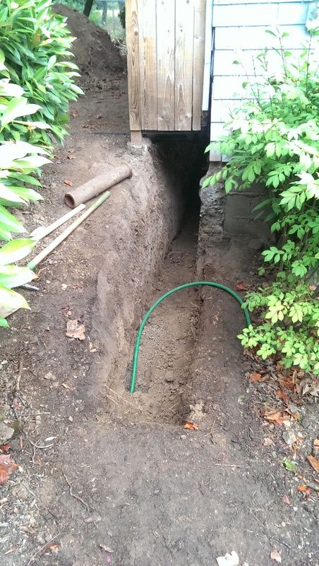

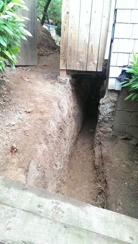

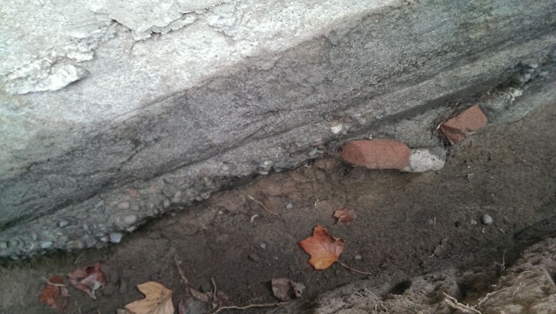

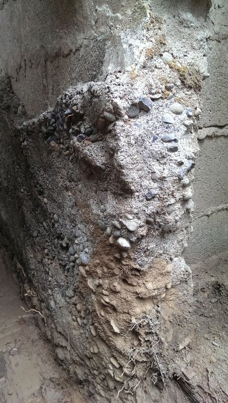

subaruski Posted September 6, 2015 Report Share Posted September 6, 2015 Have 1920s house with a leaky basement. I have demod out the drywall and insulation on the interior side of the home. The plan was to excavate a portion of the west elevation of the house, seal wall with liquid applied vapor barrier, and install a french drain that empties in to the far end of the front yard. In the process of excavating I found out that foundation was built out of an old poured in place concrete wall with cmu block on top of that. Assuming at the seam is probably were my leakage is happening. At a few of the high water path areas the concrete has spalled off. Looks like a mixed on site, large aggregate, pour mix... Any concerns from a structural stand point that anyone could see? There is one small vertical crack in the wall but the wall in all is plumb and straight. I'm I taking the right approach as far as addressing the water issue? Any recommendations from the pros? First time home owner here. Quote Link to comment Share on other sites More sharing options...

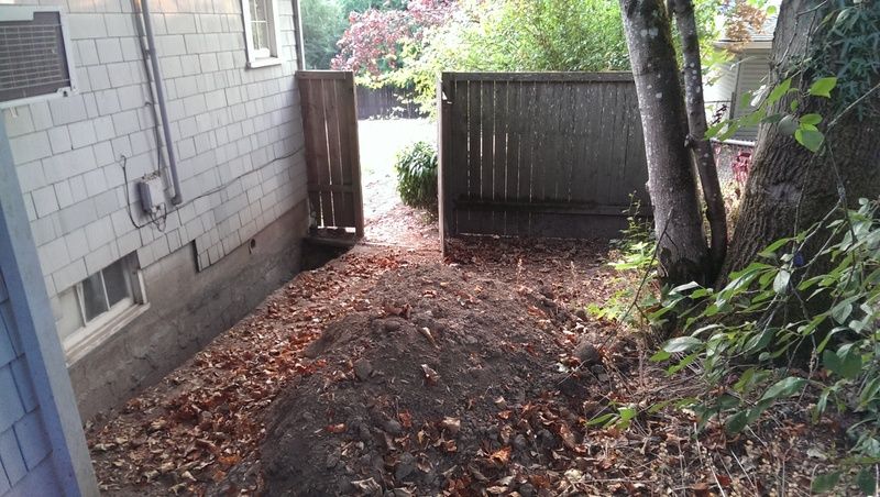

John Dirks Jr Posted September 6, 2015 Report Share Posted September 6, 2015 First, did you rule out or correct all potential problems with gutters, downspout terminations and site grading? These things make up the majority of wet basement problems. Quote Link to comment Share on other sites More sharing options...

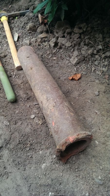

subaruski Posted September 6, 2015 Author Report Share Posted September 6, 2015 Another thing to add is I found an old clay drainage pipe. Looks like at one time this is what the down spout for the gutter? Once I pulled the first section off the line was bone dry and clear. Ran a hose down it for 20 min and it never backed up. Couldn't find any evidence of it exiting in the yard or curb side. Wonder where it's going? Quote Link to comment Share on other sites More sharing options...

John Dirks Jr Posted September 6, 2015 Report Share Posted September 6, 2015 Where exactly do the downspouts terminate? How far from the foundation wall? Are there any roof valleys that cause heavy rain to shoot over the gutter and spill on the ground next to the foundation? Does the grading in the area of trouble slope adequately away from the house such that no surface water moves towards or along the walls? Quote Link to comment Share on other sites More sharing options...

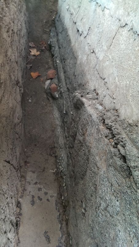

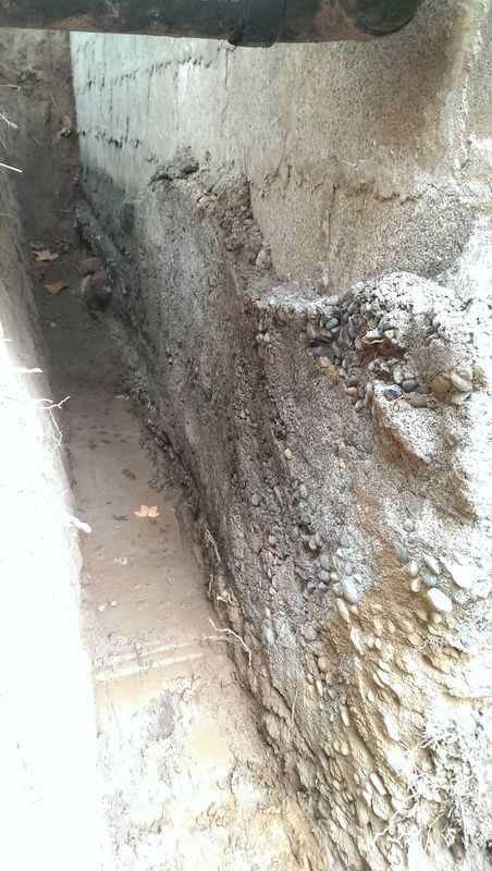

mjr6550 Posted September 7, 2015 Report Share Posted September 7, 2015 Hard to tell from the photos, but its looks like you may have excavated below the bottom of the foundation wall at some areas. If so, that is not a good practice. There is a greater potential for settlement, especially if the soil below the foundation gets wet. Regarding the corner with the concrete, not sure what is going on there. If the foundation has not been a problem so far, it is probably ok. Backfill with granular soil or crushed stone and don't get too agressive with compaction. Make sure you are draining the water away from the foundation, which is sounds like that is the plan. Quote Link to comment Share on other sites More sharing options...

Tom Breslawski Posted September 7, 2015 Report Share Posted September 7, 2015 I'm not sure what your method of excavation was, but you really should have a trench box in place if you're going in there. Quote Link to comment Share on other sites More sharing options...

Jim Katen Posted September 7, 2015 Report Share Posted September 7, 2015 Another thing to add is I found an old clay drainage pipe. Looks like at one time this is what the down spout for the gutter? Once I pulled the first section off the line was bone dry and clear. Ran a hose down it for 20 min and it never backed up. Couldn't find any evidence of it exiting in the yard or curb side. Wonder where it's going? It's probably going into a dry well on the property. You can run your hose and all of your neighbors hoses into it for a week and you won't see a thing at this time of year. But once the ground becomes saturated and the drywell starts to fill with water (late January most years), it will become less effective. It all depends on how large and how deep it is. Quote Link to comment Share on other sites More sharing options...
Jim Katen Posted September 7, 2015 Report Share Posted September 7, 2015 Hard to tell from the photos, but its looks like you may have excavated below the bottom of the foundation wall at some areas. If so, that is not a good practice. There is a greater potential for settlement, especially if the soil below the foundation gets wet. He'll have to excavate below the wall if the system is to be effective. But he shouldn't excavate below the wall *next to* the wall. He should stay about a foot out from the wall. Regarding the corner with the concrete, not sure what is going on there. If the foundation has not been a problem so far, it is probably ok. Backfill with granular soil or crushed stone and don't get too agressive with compaction. Make sure you are draining the water away from the foundation, which is sounds like that is the plan. The best backfill in this case will be washed rock, either round or sharp, and all of about the same size. You don't want fines in there because you want water to just flow straight down through it. If you use 1-1/2" clean rock, no compaction will be necessary or, indeed, possible. Quote Link to comment Share on other sites More sharing options...
Jim Katen Posted September 7, 2015 Report Share Posted September 7, 2015 Would I be crazy to try and tie a french drain along the foundation into that old clay pipe? Would save me a ton of time not digging a 75' trench through the front yard. Don't use the old pipe. The overwhelming likelihood is that it leads to a dry well. If that well were to fill with water, it could send water back into your drainpipes and actually push water into your basement. Quote Link to comment Share on other sites More sharing options...

Rob Amaral Posted September 8, 2015 Report Share Posted September 8, 2015 Send a check to Jim Katen for the free advice.. I'm ditto... Be careful you do not undermine the foundation... the 'fines' in the soil at/under the foundation wall could migrate out into your drainage system, leading to undermining and damage/differential settlement to your foundation walls... Filter-fabric is a must here.. .as is clean gravel.... and ideally, you'd be going to 'new' drainage out front... get that line cam-scanned and find out what the terminus is.. you have your work cut out for you....!! Quote Link to comment Share on other sites More sharing options...
kurt Posted September 8, 2015 Report Share Posted September 8, 2015 Couple of notes.... Don't worry too much about digging next to the footing. The thing isn't that delicate. People talk like if you disturb the soil next to the footing for a few minutes, the house falls down. No, it won't. If you dig down, get tile installed, and backfill in short order (a work day, even several days if it doesn't rain), it'll be fine. Go right next to the footing; that's where you want the drain tile. One shovel full will tell you what the dirt's going to do. You're not dealing with a souffle' fer chrissakes. Don't use big stone for back fill. All it does is fill up with dirt "fines" that folks are so worried about. Use a crushed stone (not pea gravel!), #67, maybe #5, washed, no fines. #67 is easier to bank in the lift than #5 or the big stuff (#1). I've never used UGL Drylock; don't know anything about it other than its a waterproofing paint, not thick sealant, and it's only $60 for a 5 gallon bucket. Sounds like handy homeowner stuff. On your lumpy dirty foundation, I doubt it would do anything. With it all open, I'd torch a mod bit membrane to the wall and run it down to the drain tile. Cheap, reasonably fast, and entirely effective. If you want to get smart, get some Miradrain, or a product like this, and you can do away with the stone backfill. Ditching stone is a great improvement for the DIY'er. Not having to hump crushed stone around a job is easily worth the extra expense of Delta or Miradrain. If you ever try to move crushed stone by hand (shovel), you'll learn what I mean. Quote Link to comment Share on other sites More sharing options...
