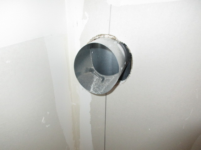

Steven Hockstein Posted January 31, 2018 Report Share Posted January 31, 2018 An HVAC contractor told me that a lint trap is required by code in this dryer vent and he installed this in a laundry room. The vent is suppose to be ducted up through the ceiling but if you look carefully you can see that the bottom is also open and there is a trap door planned below. This is a new one to me. There is no requirement in the dryer installation manual and I told the contractor to follow the manufacturer's requirements. It seems to me that this would cause problems with the air flow. Anyone want to comment? Quote Link to comment Share on other sites More sharing options...
Jim Baird Posted January 31, 2018 Report Share Posted January 31, 2018 Very funny. Ask him for a codes quote. Up is always the wrong direction for dryer venting and commercial (but not residential) requires a power boost for the up vents. Quote Link to comment Share on other sites More sharing options...
Jim Katen Posted January 31, 2018 Report Share Posted January 31, 2018 1 hour ago, Jim Baird said: Very funny. Ask him for a codes quote. Up is always the wrong direction for dryer venting and commercial (but not residential) requires a power boost for the up vents. Why is up always the wrong direction? I'd think that the buoyancy of the warm air would help move it along in the up direction. Quote Link to comment Share on other sites More sharing options...

Jim Baird Posted February 1, 2018 Report Share Posted February 1, 2018 15 hours ago, Jim Katen said: Why is up always the wrong direction? I'd think that the buoyancy of the warm air would help move it along in the up direction. Up is allowed, but to me common sense says lint falls more than it flies. Quote Link to comment Share on other sites More sharing options...

Jim Katen Posted February 1, 2018 Report Share Posted February 1, 2018 3 hours ago, Jim Baird said: Up is allowed, but to me common sense says lint falls more than it flies. Sure. But isn't that a good thing? The lint tends to accumulate in the bottom trap. Quote Link to comment Share on other sites More sharing options...
John Kogel Posted February 1, 2018 Report Share Posted February 1, 2018 My son's dryer is below ground level, so his dryer vent goes to an elbow and then vertical rise for 6 or 7 feet. When he bought the place I told him to pull the vent pipe and clean it. He got around to it about 3 years later, and found no lint. Lint accumulates at the top on the mesh cap where the pipe exits the basement. I imagine the lint is dry enough and the blower is strong enough to work in that case. A weaker dryer might not do as well. So I think the trap is not a bad addition, providing it is airtight. Lint Trap Quote Link to comment Share on other sites More sharing options...
BADAIR Posted February 2, 2018 Report Share Posted February 2, 2018 (edited) https://dryerbox.com/building-code.htm all depends on which code cycle the muni has adopted the wording has been around since 2009 if memory seves Cleanout. Each vertical riser shall be provided with a means for cleanout. mesh cap? Screens shall not be installed at the duct termination. Edited February 2, 2018 by BADAIR Quote Link to comment Share on other sites More sharing options...
Marc Posted February 2, 2018 Report Share Posted February 2, 2018 46 minutes ago, BADAIR said: https://dryerbox.com/building-code.htm all depends on which code cycle the muni has adopted the wording has been around since 2009 if memory seves Cleanout. Each vertical riser shall be provided with a means for cleanout. mesh cap? Screens shall not be installed at the duct termination. Doesn't say anything about up/down, as long as a clean-out is there (2012 IRC). Quote Link to comment Share on other sites More sharing options...

Jim Baird Posted February 2, 2018 Report Share Posted February 2, 2018 11 hours ago, BADAIR said: https://dryerbox.com/building-code.htm Thanks for posting this. Notice the reference calling for cleanout is from the IMC not the IRC, which means it does not apply to houses. Quote Link to comment Share on other sites More sharing options...
Steven Hockstein Posted February 2, 2018 Author Report Share Posted February 2, 2018 Typically the manufacturer's published installation requirement/specifications "Trump" the code requirements. I advise my clients to follow the specifications. Quote Link to comment Share on other sites More sharing options...
