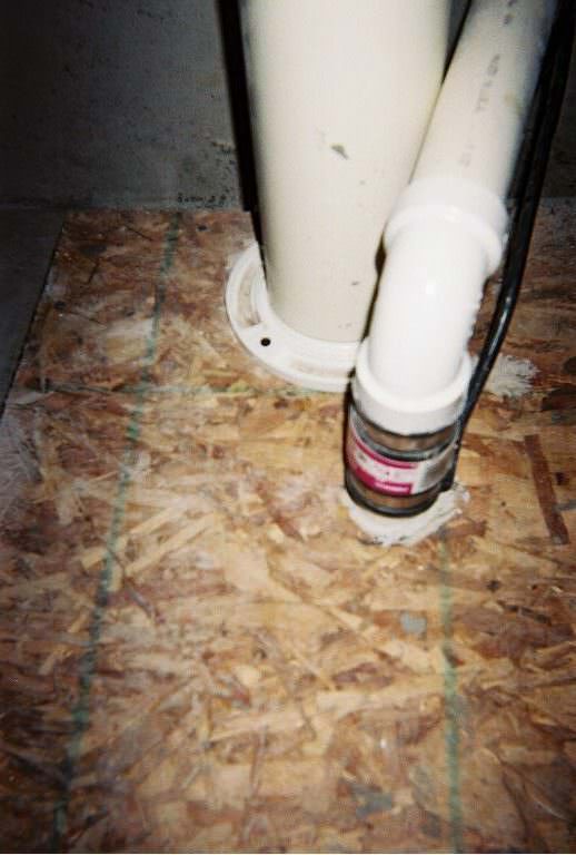

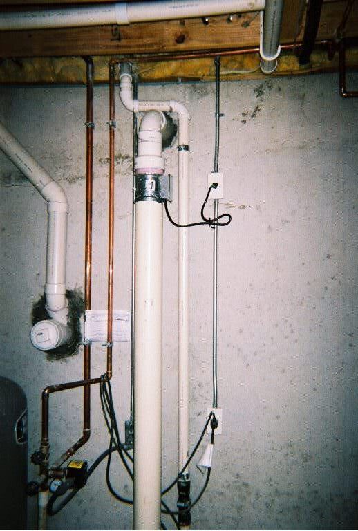

Les Posted March 5, 2008 Report Share Posted March 5, 2008 Image Insert: 67.06 KB Image Insert: 85.62 KB $600.00 system Quote Link to comment Share on other sites More sharing options...
Les Posted March 5, 2008 Report Share Posted March 5, 2008 couple more of my favorite $600 systems Image Insert: 106.11 KB How I found the screening device after contractor came back to check his work and respond to my comments about sucking the radon out of water! Real estate agent paid to have it re-calibrated after contractor threw it out in driveway! Image Insert: 152.81 KB Quote Link to comment Share on other sites More sharing options...
hausdok Posted March 5, 2008 Report Share Posted March 5, 2008 Hi Les, It wasn't this radon contractor, was it? He moved out of his own state to start another business someplace else. His state shut him down and fined him more than $14,000. He never did pay his fine - it's still open on the books. OT - OF!!! M. P.S. Looks like you had some poria (brown rot) eating the OSB in that first photo. Quote Link to comment Share on other sites More sharing options...
Les Posted March 5, 2008 Report Share Posted March 5, 2008 toooooooooooo much!! In fact, it was a minion. They are not actively involved with radon at this time, or at least they can't be located. The rot was caused by sump overfilling (no pump) and the duct booster fan used for suction and the various sizes of pipe used. Quote Link to comment Share on other sites More sharing options...
