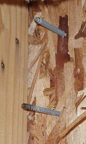

gtblum Posted June 24, 2009 Report Share Posted June 24, 2009 That was great until they decided to suggest that using screws would take care of the problem. What kind of screws? Where should you put them? Link to comment Share on other sites More sharing options...
Bill Kibbel Posted June 25, 2009 Report Share Posted June 25, 2009 That was great until they decided to suggest that using screws would take care of the problem. What kind of screws? Where should you put them? Simpson's SDS structural wood screws. Link to comment Share on other sites More sharing options...
FrankWoeste Posted June 25, 2009 Report Share Posted June 25, 2009 That was great until they decided to suggest that using screws would take care of the problem. What kind of screws? Where should you put them? gtblum: They were showing a Simpson Strong-Tie fastener and you can contact them for specific design information. If you are interested in the general subject of deck ledger connection design including connection to an Engineered Wood Product (EWP) Rimboard that is bearing on a sill plate, then you can review this document: http://awc.org/Publications/DCA/DCA6/DCA6.pdf Frank Woeste Professor Emeritus Virginia Tech University Blacksburg Link to comment Share on other sites More sharing options...

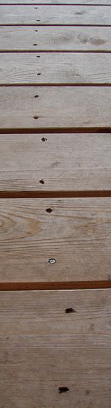

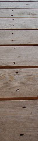

Ken Meyer Posted June 28, 2009 Report Share Posted June 28, 2009 Hi WJ. I wrote up the lack of bolts on a deck ledger a while back. For the re- inspection I went into the crawlspace to see if I could see any of the bolts (cripple wall). Every nice new shiny bolt end was visible in the sheathing between the studs. I see this quite often when the interior section of wall is exposed-- scary stuff. Yes, sometimes they miss. On this deck, that's not the only place they missed. Using hold downs to beef up the attachment to the house may have been a good idea, but the execution leaves something to be desired. Click to Enlarge 34.62 KB Click to Enlarge 29.51 KB Click to Enlarge 18.86 KB Click to Enlarge 42.04 KB Click to Enlarge 26.97 KB Link to comment Share on other sites More sharing options...
hausdok Posted June 29, 2009 Report Share Posted June 29, 2009 More deck problems in GA: http://www.ajc.com/metro/content/metro/ ... lapse.html Hi, Well, when one looks at the gallery of photos with the article you can see that the ledger split right down the center and the bottom half pulled off the house. You can also see that the ledger was rotten and that there'd been water infiltration going on for quite a while. Line up bolts in a straight line and install a deck without flashing and you're just waiting for the day it collapses. ONE TEAM - ONE FIGHT!!! Mike Link to comment Share on other sites More sharing options...

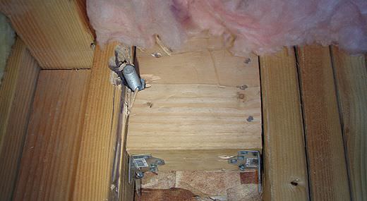

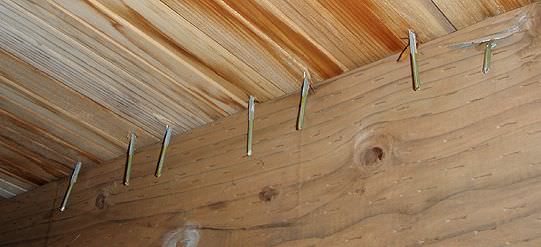

Darren Posted September 11, 2009 Report Share Posted September 11, 2009 Here's a picture of a deck I did last week. Besides many other problems, the joist hangers are a classic. This is a townhouse development where they are all the same! Click to Enlarge 52.18 KB Link to comment Share on other sites More sharing options...
Chad Fabry Posted September 11, 2009 Report Share Posted September 11, 2009 Here's a picture of a deck I did last week. Besides many other problems, the joist hangers are a classic. This is a townhouse development where they are all the same! That's a deck built by pros. Nice. Here's a photo of a deck built by a resident in my jurisdiction. He'd never built anything before. I answered a few of his questions then handed him a prescriptive deck building document I copied from somewhere and a Simpson Deck Accessory Catalog. He's pretty proud and I told him I'd share the photos with you folks. Darren's photo is why I don't use the terms professional or amateurish in my reports any longer. I still use "crappy" or "built by a fourth grader". Click to Enlarge 51.71 KB Link to comment Share on other sites More sharing options...
