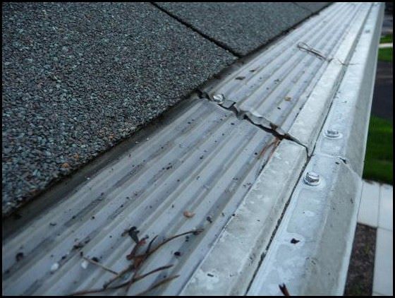

John Dirks Jr Posted November 2, 2011 Report Share Posted November 2, 2011 I have a similar product on my house. Don't let em fool you by saying they don't need cleaning. Small tinder stuff still gets in creating clogs and standing water breeding grounds for mosquitoes. When I get a new roof, I'm taking them down and just going with plain old gutter screens. Gutter topper Click to Enlarge 13.66 KB Plain old screens Click to Enlarge 10.32 KB These screens on a recent inspection were so fine they looked very prone to clogging, even with pollen and dust like stuff. You can surely anticipate water shooting over these. Click to Enlarge 57.43 KB Quote Link to comment Share on other sites More sharing options...
hausdok Posted November 2, 2011 Report Share Posted November 2, 2011 Hi, Around here they don't work worth a damn. The pine needles and debris just build up on top of them and the water shoots off onto the ground. I've seen every type of gutter contrivance and none of them can prevent leaves and pine needles building up on top of them and forming a surface that the water just runs off onto the ground. Waste of money. ONE TEAM - ONE FIGHT!!! Mike Quote Link to comment Share on other sites More sharing options...

kurt Posted November 2, 2011 Report Share Posted November 2, 2011 Surface tension, not capillarity. The water (theoretically) sticks to the "helmet" and follows the nosing into the gutter. Both are manifestations of the same property of liquids. Marc Yeah, yeah, yeah.......you and your science......we don't need no stinkin' science...... I'm glad that the smart folks all agree gutter helmets don't work. O's description is exactly what I see....the leaves and needles stick to the stuff and end up blocking the gutters. Screens don't work either; they get glued up with leaves and the water runs over and onto the ground. Quote Link to comment Share on other sites More sharing options...
