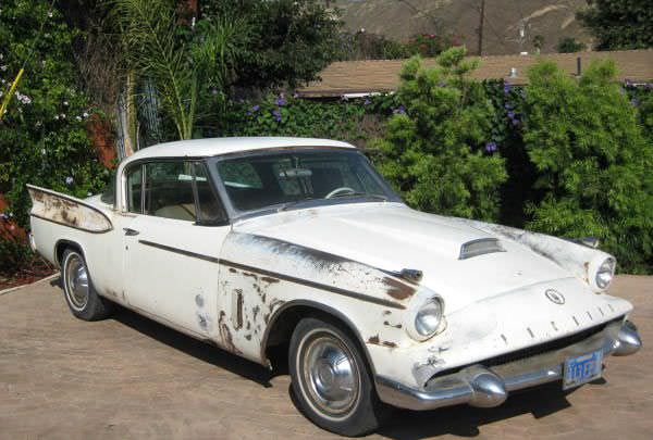

hausdok Posted October 23, 2013 Author Report Share Posted October 23, 2013 Cool tip on the gas, Jim. That place is about 600 meters from here. Not sure, but I thought I saw a bunch of those metal Jerry Cans at HFT the other day. I might be able to get them a little cheaper there; worth checking out. I'd be putting StaBil in any gas I store. Running the generator dry with the choke on when you're going to put it up is SOP where I come from. Whatchu mean catfish, Jimbo!? Have you been unconscious? Have you driven down the road and seen the snout on all of these new cars? The front end of my baby is gorgeous in comparison. Here's what she looked like when I found her on the H.A.M.B. board more than two years ago. No 151 of 588 made and one of less than 200 left today. Click to Enlarge 56.67 KB ONE TEAM - ONE FIGHT!!! Mike Quote Link to comment Share on other sites More sharing options...
Jim Katen Posted October 23, 2013 Report Share Posted October 23, 2013 Cool tip on the gas, Jim. That place is about 600 meters from here. Not sure, but I thought I saw a bunch of those metal Jerry Cans at HFT the other day. I might be able to get them a little cheaper there; worth checking out. Don't do it. The ones a Harbor are cheap crap made in China. I've looked everywhere and $45 is the absolute best price I could find in a real NATO spec can. I'd be putting StaBil in any gas I store. Running the generator dry with the choke on when you're going to put it up is SOP where I come from. It's a good practice for sure. I've had unsatisfactory experiences with Stabil. When I discovered that I could buy pure gas, everything that I run with it suddenly performed about 100% better. Whatchu mean catfish, Jimbo!? Have you been unconscious? Have you driven down the road and seen the snout on all of these new cars? The front end of my baby is gorgeous in comparison. Here's what she looked like when I found her on the H.A.M.B. board more than two years ago. No 151 of 588 made and one of less than 200 left today. Click to Enlarge 56.67 KB This picture reminded me of your car: Click to Enlarge 688.44 KB Quote Link to comment Share on other sites More sharing options...
hausdok Posted October 23, 2013 Author Report Share Posted October 23, 2013 Oooh, that's cold. One thing is for sure, finding a place less than half a mile away where I can get old style gas for that Packard is pretty cool. I guess I'm still going to have to add a lead substitute though. ONE TEAM - ONE FIGHT!!! Mike Quote Link to comment Share on other sites More sharing options...

Chad Fabry Posted October 23, 2013 Report Share Posted October 23, 2013 Oooh, that's cold. One thing is for sure, finding a place less than half a mile away where I can get old style gas for that Packard is pretty cool. I guess I'm still going to have to add a lead substitute though. ONE TEAM - ONE FIGHT!!! Mike When you do the heads install stellite exhaust seats. No lead necessary. lead substitute is like Spanish Fly; a spurious concoction that makes you feel better about a bad situation. Quote Link to comment Share on other sites More sharing options...
hausdok Posted October 23, 2013 Author Report Share Posted October 23, 2013 Thanks Chad, I'd briefly looked into that. Just the seats or valves too? Been reading that stellite seats and stainless steel valves are the way to go but another guy said he'd installed stellite seats and valves. To be honest, forty years ago when I walked away from the automotive world I'd never looked back and hadn't followed any of the technology. I'd completely missed the whole loss-of-lead discussion. OT - OF!!! M. Quote Link to comment Share on other sites More sharing options...
