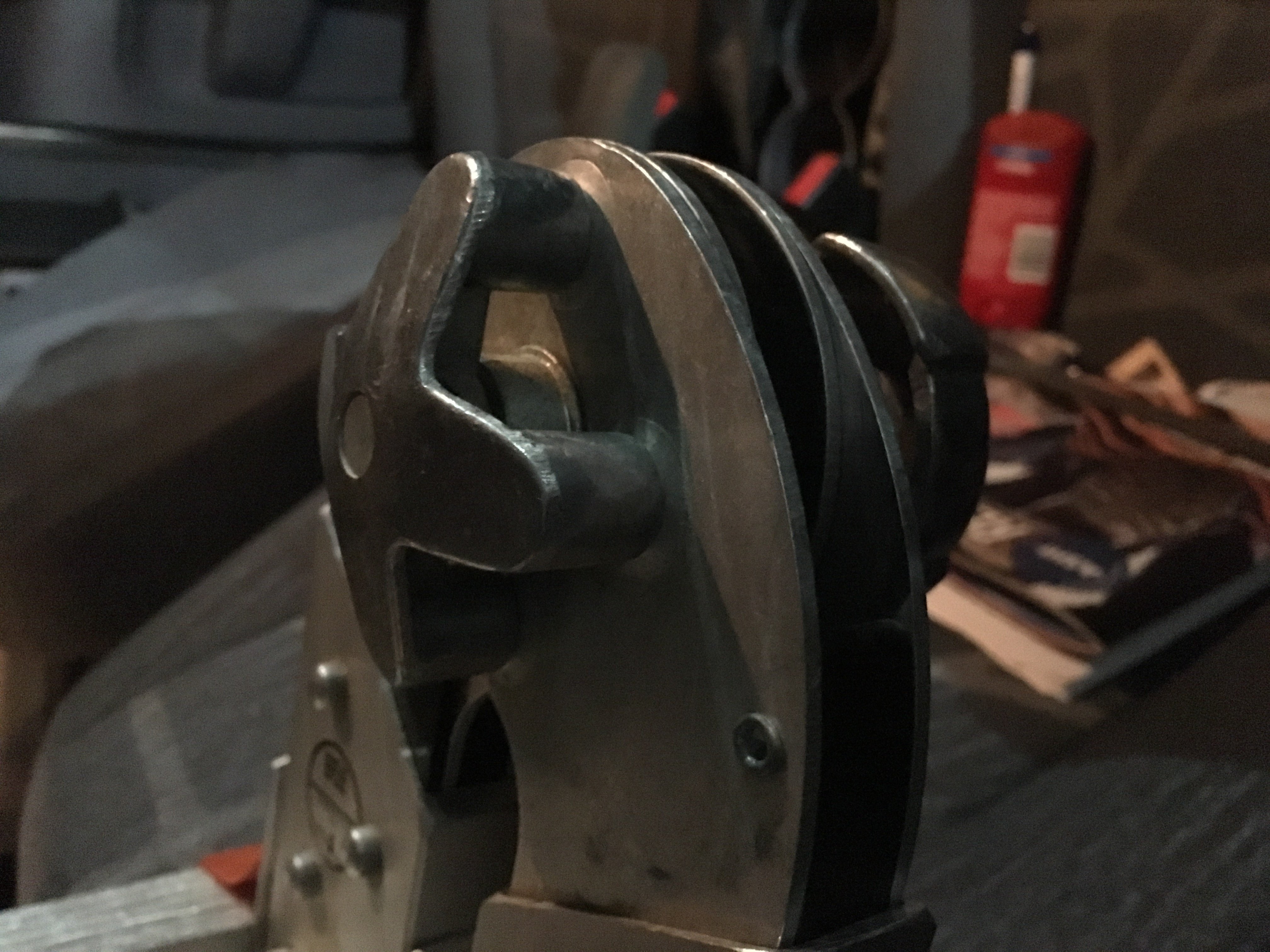

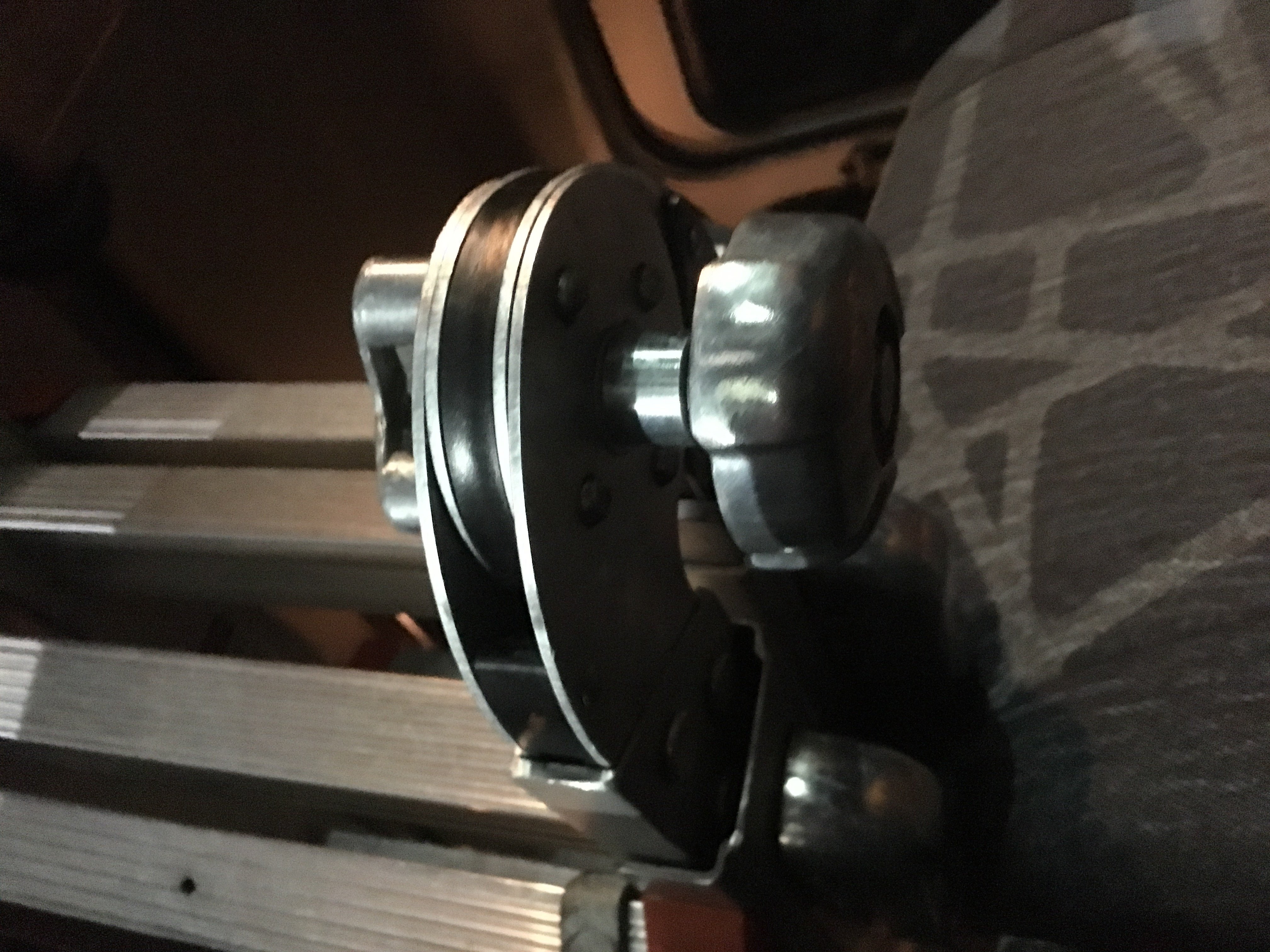

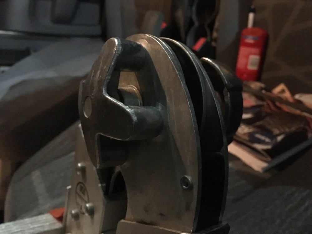

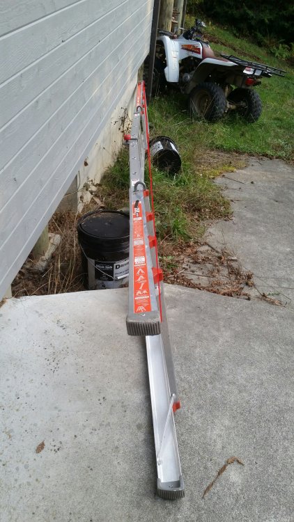

Denray Posted January 5, 2019 Report Share Posted January 5, 2019 Hardly ever have my LG ladder out and fully extended anymore. I know, it's sad. But I did have it extended the other day and it sure looked tweaked. Been over a year since I used it professionally and I just don't remember it having this much of a hyper back joint bend to it. Is this just the way they are and no big deal? Quote Link to comment Share on other sites More sharing options...
Jim Katen Posted January 6, 2019 Report Share Posted January 6, 2019 I've never owned a Little Giant, but neither of my Werners hyperextends like that. I'd stress test it and see whether or not that center joint is moving. Quote Link to comment Share on other sites More sharing options...
Erby Posted January 6, 2019 Report Share Posted January 6, 2019 I'd think that, as long as the pins are properly locked in their holes, it isn't going anywhere. Quote Link to comment Share on other sites More sharing options...
Matthew Jardine Posted January 6, 2019 Report Share Posted January 6, 2019 Both of my Werner ladders hyperextend like this. One of them is less than 6 months old and the other is 7+ years old. Never had an issue from either Quote Link to comment Share on other sites More sharing options...

TimK Posted January 7, 2019 Report Share Posted January 7, 2019 I'm in agreement with Jardine. My Werner does this to about that same extent. Quote Link to comment Share on other sites More sharing options...
Chad Fabry Posted January 7, 2019 Report Share Posted January 7, 2019 My ladders aren't like that and it would bother me if they were. I have an aversion to falling because my equipment failed. I see a lot of guys who don't set their ladders up at the correct angles- they're way too horizontally. Aluminum doesn't like being bent and, for the ladder to be over extended at it's center pivot, something got bent. It doesn't matter what we say- send the photos to Little Giant and ask for their opinion. I'm sure they've tested dozens of ladders to failure. Quote Link to comment Share on other sites More sharing options...
Denray Posted January 7, 2019 Author Report Share Posted January 7, 2019 LG boy said it was fine? I'll set it up when it quits raining and check it out a little more thoroughly, like Jim mentioned. Quote Link to comment Share on other sites More sharing options...

Denray Posted January 8, 2019 Author Report Share Posted January 8, 2019 Here's the cause. Holes and or pins get worn out. Even though they have a lifetime warranty the LG rep said they are fine. Quote Link to comment Share on other sites More sharing options...

Marc Posted January 8, 2019 Report Share Posted January 8, 2019 (edited) 18 hours ago, Denray said: Here's the cause. Holes and or pins get worn out. Even though they have a lifetime warranty the LG rep said they are fine. I'd be concerned with that much wear, regardless of what the manufacturer said. It's me that's climbing up the thing. What Tom said. Edited January 8, 2019 by Marc Quote Link to comment Share on other sites More sharing options...

Jim Katen Posted January 9, 2019 Report Share Posted January 9, 2019 One of the problems with that much wear in the joint is that the fully extended ladder wants to rock back & forth across its range of movement. Several years ago, someone posted a video of a guy who fell for exactly that reason. He had the ladder sticking up several feet above the edge of the roof and as he climbed it, he pushed forward on the top of the ladder, which caused the top to rock forward, the middle to rock out, and the bottom to pop out from under him. Quote Link to comment Share on other sites More sharing options...
Tom Raymond Posted January 9, 2019 Report Share Posted January 9, 2019 Everyone in the inspector groups on Facebook always recommended the 17' little giant or Werner. I find that size hard to handle. It's too big when I need a small ladder and too short when I need a big one. I carry 300# rated Werner folders, 15' and 22'. If I need to make more than one trip or plan to spend more than a few minutes at height I grab a real extension ladder. They are far more comfortable to hang out on, and easier to set up. I wouldn't be worried about Denny's ladder as a step, but I wouldn't be comfortable on it fully extended. Quote Link to comment Share on other sites More sharing options...
Tom Breslawski Posted January 26, 2019 Report Share Posted January 26, 2019 I wouldn't use that thing as an extension ladder. Too worn out. Just replace it for a couple hundred bucks and save yourself the broken back/leg/hip. I use a 13' Werner and 22' Werner and wouldn't use them if they were worn like that. Quote Link to comment Share on other sites More sharing options...
